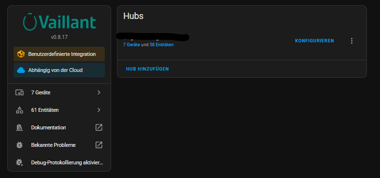

OK, meine Software ist neuer.
anbei meine Eingaben im "CODE EDITOR" evtl. hilft dir das weiter:
Code:
type: entities
entities:
  - entity: sensor.myhome_ah56_circuit_0_state
  - entity: sensor.myhome_ah56_device_0_arotherm_plus_current_power
  - entity: sensor.myhome_ah56_circuit_0_current_flow_temperature
  - entity: sensor.myhome_ah56_heating_energy_efficiency
    name: Tages Arbeitszahl WW & Heizen
  - entity: sensor.myhome_ah56_outdoor_temperature
    name: Outdoor Temperature
  - entity: sensor.myhome_ah56_zone_1_circuit_0_current_temperature
  - entity: sensor.myhome_ah56_zone_1_circuit_0_humidity
  - entity: sensor.myhome_ah56_circuit_0_heating_curve
  - entity: sensor.myhome_ah56_system_water_pressure
    name: System Wasserdruck
  - entity: sensor.myhome_ah56_device_0_arotherm_plus_on_off_cycles
  - entity: sensor.myhome_ah56_device_0_arotherm_plus_operation_time
  - entity: >-
      sensor.myhome_ah56_device_0_arotherm_plus_consumed_electrical_energy_domestic_hot_water
  - entity: >-
      sensor.myhome_ah56_device_0_arotherm_plus_earned_environment_energy_domestic_hot_water
  - entity: >-
      sensor.myhome_ah56_device_0_arotherm_plus_heat_generated_domestic_hot_water
    name: Wärmeerzeugtes Brauchwasser
  - entity: >-
      sensor.myhome_ah56_device_0_arotherm_plus_consumed_electrical_energy_heating
  - entity: >-
      sensor.myhome_ah56_device_0_arotherm_plus_earned_environment_energy_heating
  - entity: sensor.myhome_ah56_device_0_arotherm_plus_heat_generated_heating
  - entity: binary_sensor.myhome_ah56_trouble_codes
title: MyHome-AH56 / [URL_INTERNA=https://www.hausbau-forum.de/threads/vaillant-erfahrungen-arotherm-plus-vwl-35-55-75.42822/]Arotherm[/URL_INTERNA] plus 55/6
state_color: true
Vaillant Dashboard: Linkes Menü, Logo, Hubs-Übersicht mit 7 Geräten und 58 Entitäten.

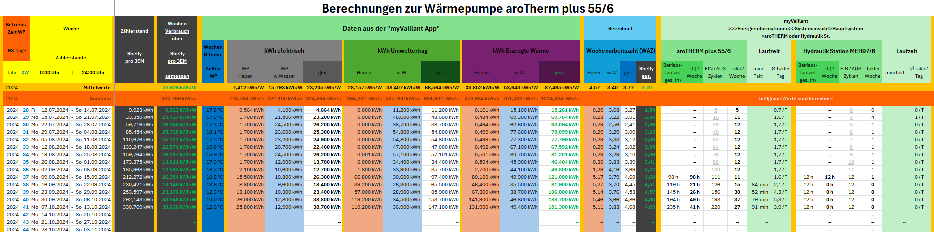

Berechnungen zur Wärmepumpe aroTherm plus 55/6 in einer Tabelle mit Energie- und Wärmedaten.
meine Daten bis eben 16:30 Uhr
