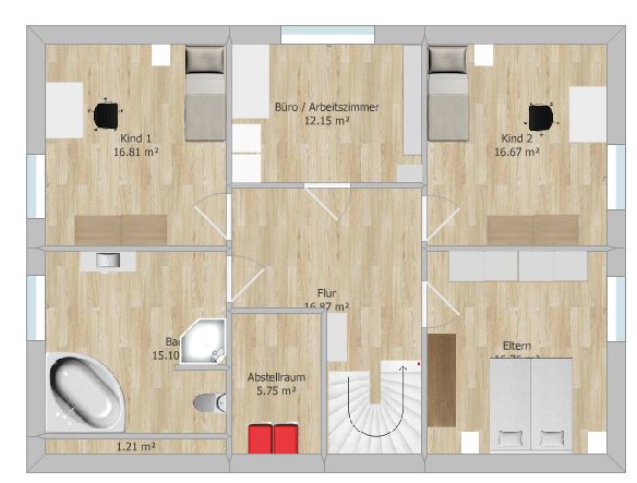

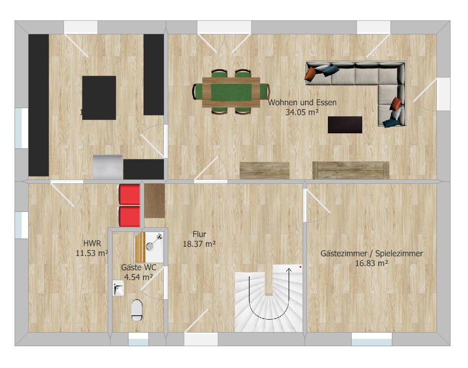

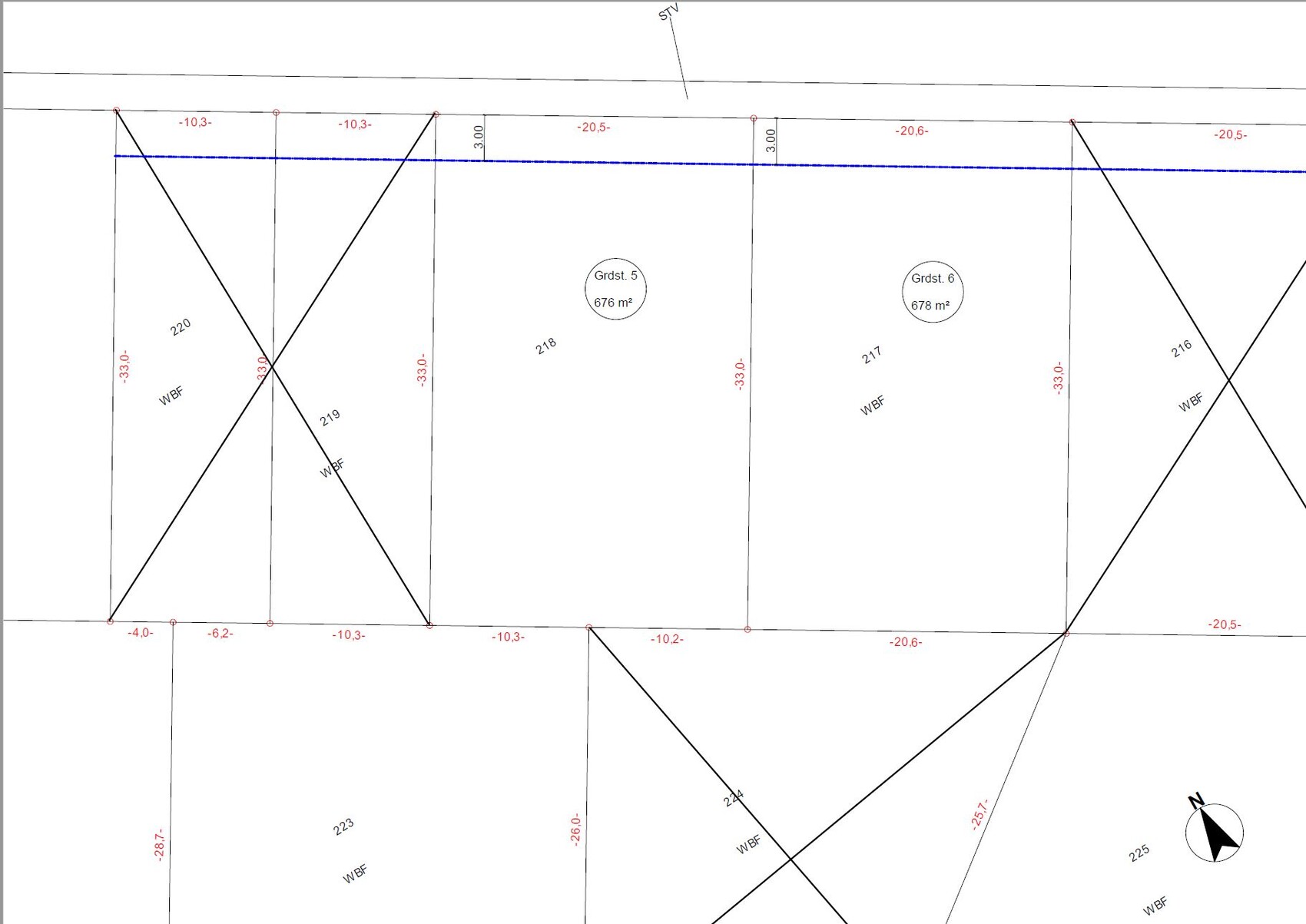

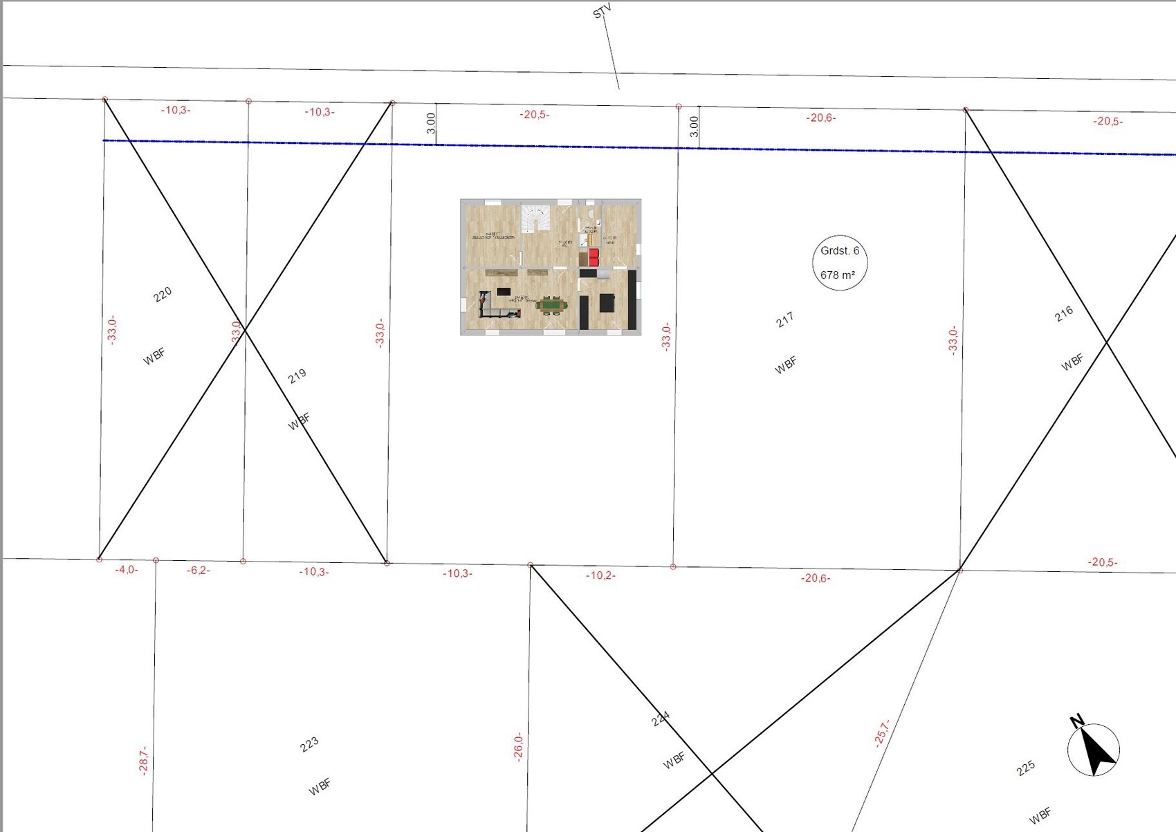

Hello everyone,
at our developer, a customer who had reserved a plot dropped out. Since the other plot has a south / southwest location, we didn’t hesitate long and switched the plot. The new plot is smaller, so we gave up our bungalow dream. The plot is No. 5.
A reminder: The plot is bound to the developer.
I have been thinking the last few days about the arrangement and design of the rooms and the plot and basically want to first know if the approach is okay. I am not concerned with details inside the rooms themselves, windows, doors, bathroom design. That’s also not possible since I created the floor plan myself (based on the Gussek House floor plans). Nevertheless, I tried to design it as well as possible. For this reason, I want to put the floor plan up for discussion here. It is enough for me if you give feedback on the room layout and room arrangement, as well as ideas / suggestions / tips. Maybe you also see things right away that "just don’t work" or are not practical for everyday life.
I created the floor plan with RoomSketcher, unfortunately, I only have a free version so many things are not possible. Therefore, please ignore room dimensions on the upper floor. In the area of the study room (office) there is a dormer.
A few more things about the house.
Roof shape 38°
Knee wall 100 cm
Outer dimensions 12.85 x 9.60 m (enlarged, original dimensions of Gussek House houses are smaller)
Unfortunately, I cannot show room dimensions because RoomSketcher does not allow it.
Attached again is the completed questionnaire.

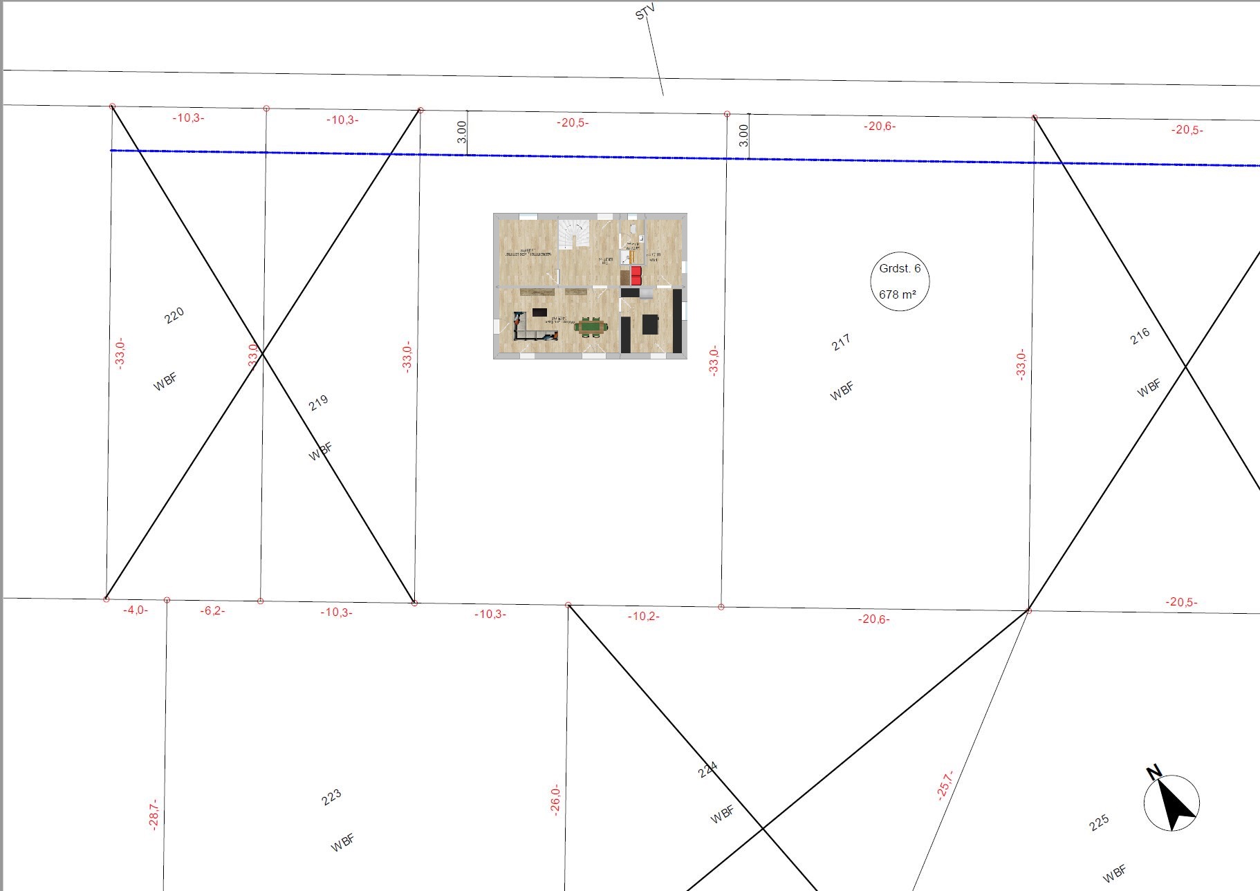

Development plan / restrictions
Plot size: 676m²
Slope NO
Site coverage ratio 0.4 (permissible exceedance 25 of 100)
Floor area ratio 0.6
Building window, building line and boundary: On the north side / south side approx. 20.5 m wide, west and east side approx. 33 m wide, 3 m building boundary on each side, plot rectangular, which can be clearly seen in the pictures
Edge development: 3 m
Number of parking spaces: no specification
Number of floors: maximum 2 full floors
Roof shape: gable roof, hip roof

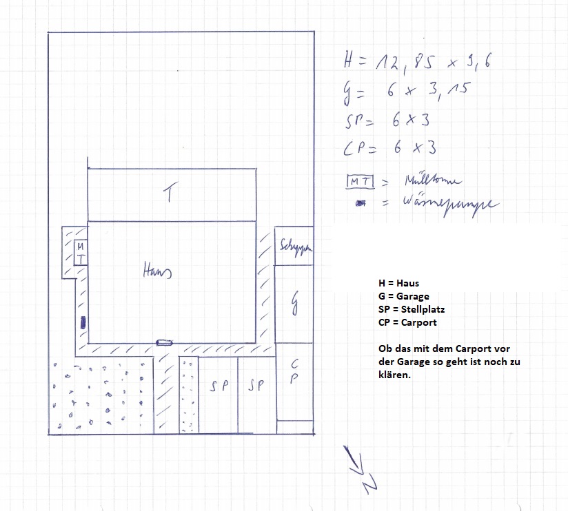

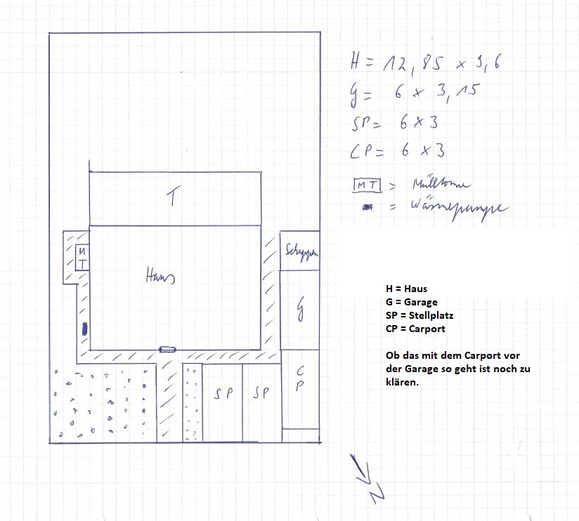

Further specifications: Garage must have a 5 m distance to the plot boundary. Garage on the west side because the curb is lowered there.

GF: Living / dining / cooking, utility room, guest WC with shower, hallway (corridor) with cloakroom and stairs to upper floor, guest room / playroom
UF: Bedroom, 2 children’s rooms, bathroom, storage room, office
Office: family use or home office? Home office with family use
Guests per year: 1-2x
Open or closed architecture: closed architecture?
Conservative or modern construction: a mix of both
Open kitchen, kitchen island: closed kitchen with kitchen island would be nice but is not a must, open kitchen is also fine

Garage, carport: There must be space for 2 cars, preferably 3 to 4. Currently, I could imagine a garage (3x6) with carport (3.6) in front, no idea if that works. Then 2 parking spaces in front of the house.
