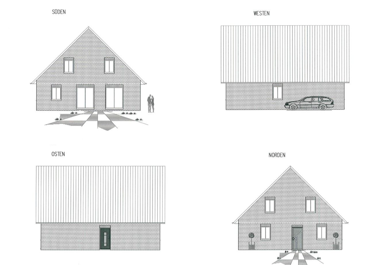

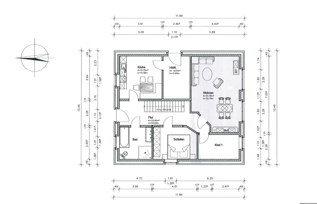

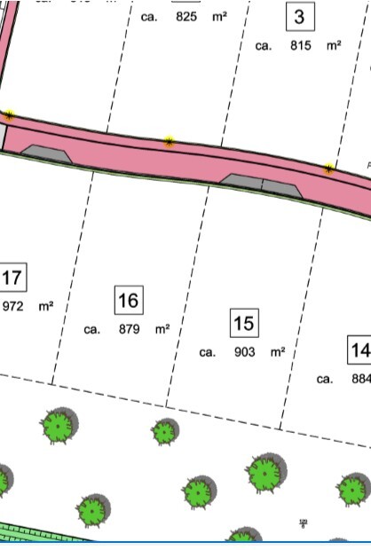

Hello,
Development plan/restrictions
Plot size: 879 sqm
Slope: no
Site occupancy index: 0.3
Floor space index: 0.45
Building window, building line and -boundary: 5m to the street, 3m each to the orchard area and neighbors
Edge development /
Number of parking spaces 2
Number of floors 2
Roof shape gable roof
Style solid
Maximum heights/limits FH 9.0, TH 6.0
Further requirements
Requirements of the builders: living room to the south, small office (initially to be used as nursery), level-access shower, utility room on the driveway side
Style, roof shape, building type
Basement, floors: no basement, 1.5 floors
Number of people, age: 2 - under 30
Office: family use or home office? family use
Guest sleepers per year: 2-3
Open or closed architecture closed
Conservative or modern construction rather conservative
Open kitchen, kitchen island: no
Number of dining seats: 6
Fireplace: no
Music/stereo wall: no
Balcony, roof terrace: no
Garage, carport: carport later in the east
Utility garden, greenhouse: no
House design
Who is the planner: general contractor (GU)
What is especially liked? Why? living room in the south, number of rooms as desired
What is disliked? Why? window of nursery 1 should be moved from south to west (otherwise the wall looks too bare), driveway + driveway to the east not west
Price estimate according to architect/planner: only after Easter, my priority is the floor plan currently
Personal price limit for the house, including equipment: it will come to 1,700 €/sqm
Preferred heating technology: gas
If you have to do without, which details/extensions
-can you do without: bathtub
-can you not do without:
Why is the design as it is now?
The floor plan was seen in a very similar form during a house visit and is our favorite of all house visits + browsing catalogs. We only slightly adapted it to our needs (removed guest WC and enlarged living room, rotated nursery)
What is the most important/basic question about the floor plan summarized in 130 characters?
Basically the floor plan suits us, but I would like your opinion again, maybe there is still some optimization possible. Note, as mentioned above, we want to move the nursery window to the west so the wall there doesn’t look so bare. Driveway to the east, not west. That’s why the bare wall in the west; the carport is to be located there up to the utility room door. Alternatively, I see the possibility of a window in the living room there and the carport starting behind the house. The plot would allow that.
My main concern is that we are not 100% happy that the roof is oriented west/east; I would prefer a north/south orientation. Do you have an idea how to turn the floor plan 90 degrees but keep the floor plan as it is? Only the kitchen and nursery could be swapped in the floor plan.
PS: The sqm figure for the corridor is probably incorrect, the GU will finalize this after Easter. Correct figures will be: living room: 31.79 sqm, kitchen: 15.19 sqm, utility room: 9.87 sqm, corridor approx. 19.5 sqm, child 1/office approx. 8 sqm, bedroom approx. 11.8 sqm, bathroom approx. 8.5 sqm
Data on the plot: length: west: 40 m east: 42 m, width: 21.5 m
Regards
