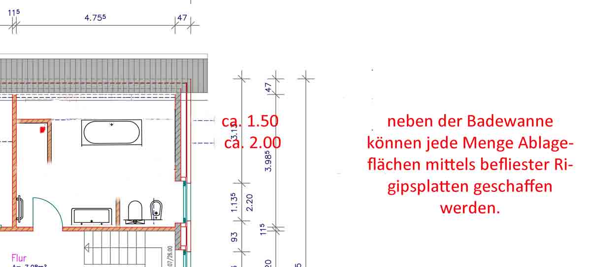

What didn't she like about the bathroom now? The built brick "T"? As I said, a skylight will be installed in the toilet/bidet area and the wall next to the toilets will then only be about 100cm high or so... Do you think that is still too bulky? What would be an alternative?

There is now no "space" in the bathroom. There are only corridors and walls that fragment the actual space of the bathroom. Where is the unity "bathroom"?

Hm... I think I understand something you might mean. I have to say, I don't like bathrooms that have a lot of walking space in the middle... I only find that suitable for cleaning... The room is just under 15 sqm with a 90 cm knee wall and a 32-degree roof pitch... I've already done a lot with bathroom planners, but in the end I always ended up with this variant... Do you have another idea? What goes where???

You probably won't be able to furnish the room as you have currently drawn it; most likely, it will be walled up to the 1.50 m line. And if my assessment is correct, the attached variant could be roughly accurate. By the way, the bathroom suddenly "comes alive"
