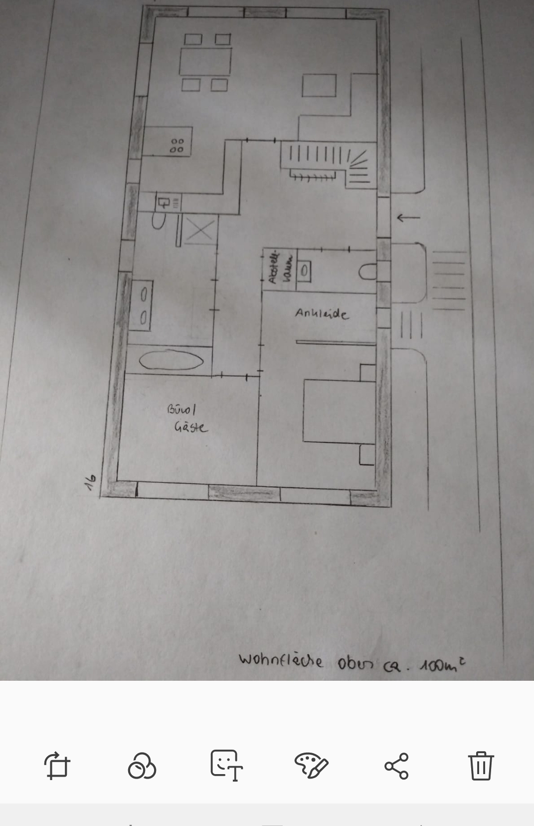

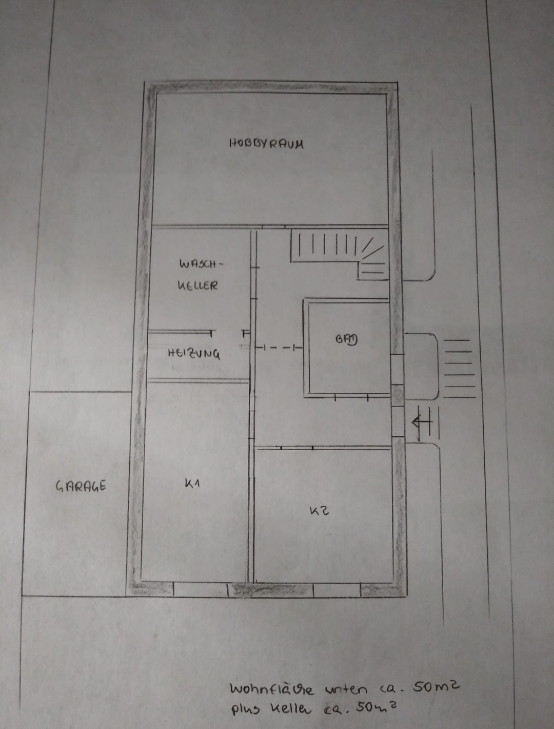

That would be Plan B! I've slowly understood that a semi-detached house is not the optimal solution. What do you think about it? I don’t know if the upper floor is worth it, 150sqm should be enough!

Why are the floor plans oriented to the south?
Is the house supposed to be for me, or why is the footpath between the garage and the front door so long?
2018-10-06 09:39:45
  • #3
How can you tell? The plans are not clear to me at all...
50 sqm... the drawn rooms don’t fit in there... what kind of measurements are these? Staircase, corridor and kitchen at 8.5 including walls... that doesn't work.

Hi, that was just an idea so you can see that we are not fixed on a semi-detached house. The children's rooms are in the basement facing south. I also thought that some of you reading along might have a similar building plot or maybe can give tips or suggestions. Be more specific, how would you build it? What would be your idea? So we have almost given up on the semi-detached house, it really doesn’t seem to lead to anything good. Thanks for now

The site plan is apparently oriented to the north and has the "Ga" area only on the right side of the plan - ergo the floor plan with the garage on the left is probably oriented to the south.
