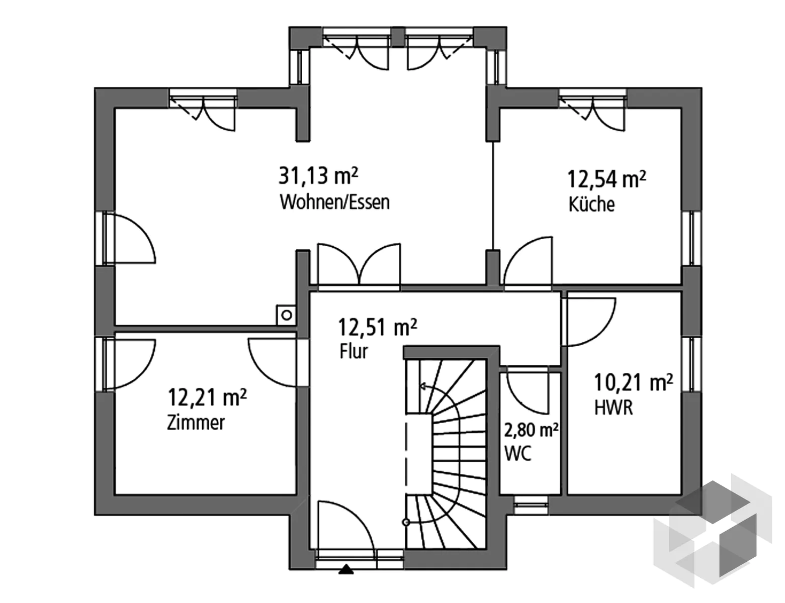

They can be well used with the new hobby in retirement and for the grandchildren’s guest rooms. With three children, quite a few grandchildren will come, and then the rooms can also be used. To me, all this is too narrow-minded and not thinking outside the box... but I also find the discussion a bit one-sided. Regarding the apartment designs: Hallways too dark without daylight. No wardrobe, no possibility to place a chest of drawers or cabinet for jackets or shoes. Living room relatively large in relation to the rest. Bedroom hardly furnishable with a double bed/wardrobe. Dressing room on the upper floor offers no more than 3 meters and thus no added value. I just noticed: RBM 3.00... so not even a 3-meter wardrobe is possible. Later apartment upstairs without an exit. No guest bathroom upstairs. Where is the laundry washed? The window seat is also not a quiet zone, which it should be.

Unfortunately, I can only agree. And, to make matters worse, the space program could probably be created with some fewer sqm without fixing on possible age variants .. in other words, saving costs. The question block regarding this is unfortunately not answered.

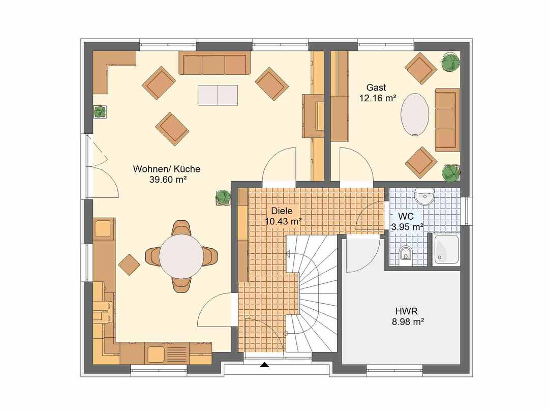

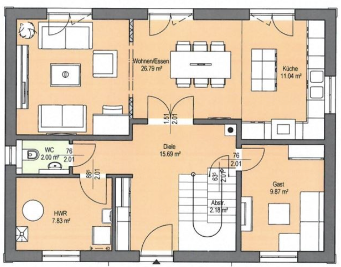

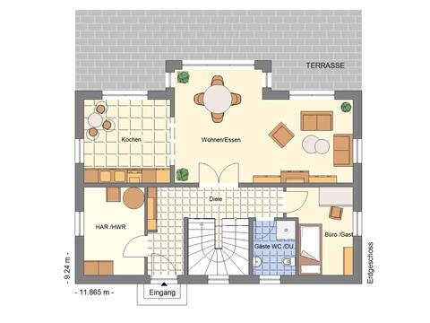

I don’t understand again why everything is torn apart so unfriendly. That is a common single-family house floor plan, isn’t it? At least if you remove the wall behind the stairs and possibly rotate it. I have seen that many times (also in real life) and it all works well. The isolation of the stairwell can be added in case of need in 20 years. By the way, the stairs in your plan are very generously designed, if I interpret that correctly. 110 or 120 wide?
Remove the wall behind the stairs, put proper windows into the "stairwell", make the living room smaller than the kitchen-living area, connect the utility room with the storage room (access then from the former storage room), move the utility room opposite the stairs and place a wardrobe there (like in floor plan 1 here).
