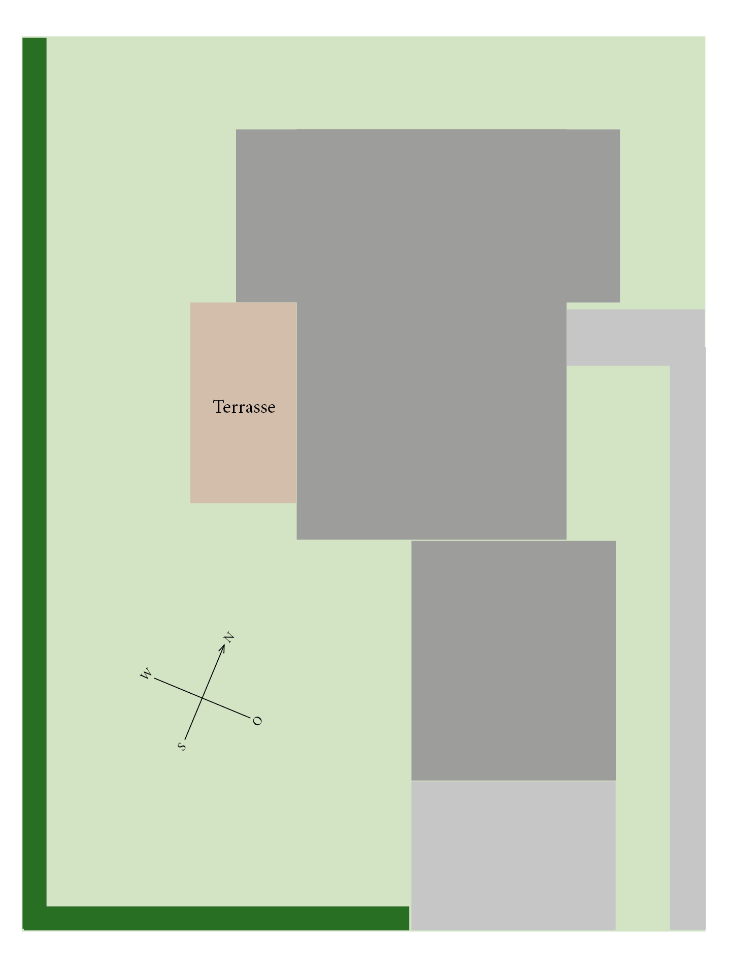

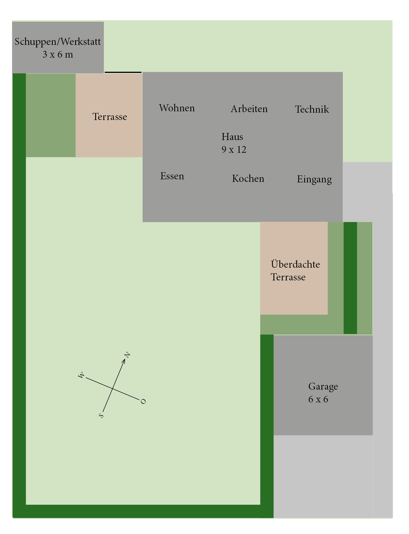

I would consider detaching the garage from the house and positioning the house sideways at the back. In my opinion, this results in a better garden layout and a nice spot for a covered, sheltered terrace. I would then lead the access path more to the right past the garage, so that the mail carrier and unexpected visitors don’t end up immediately in the garden and on the terrace.

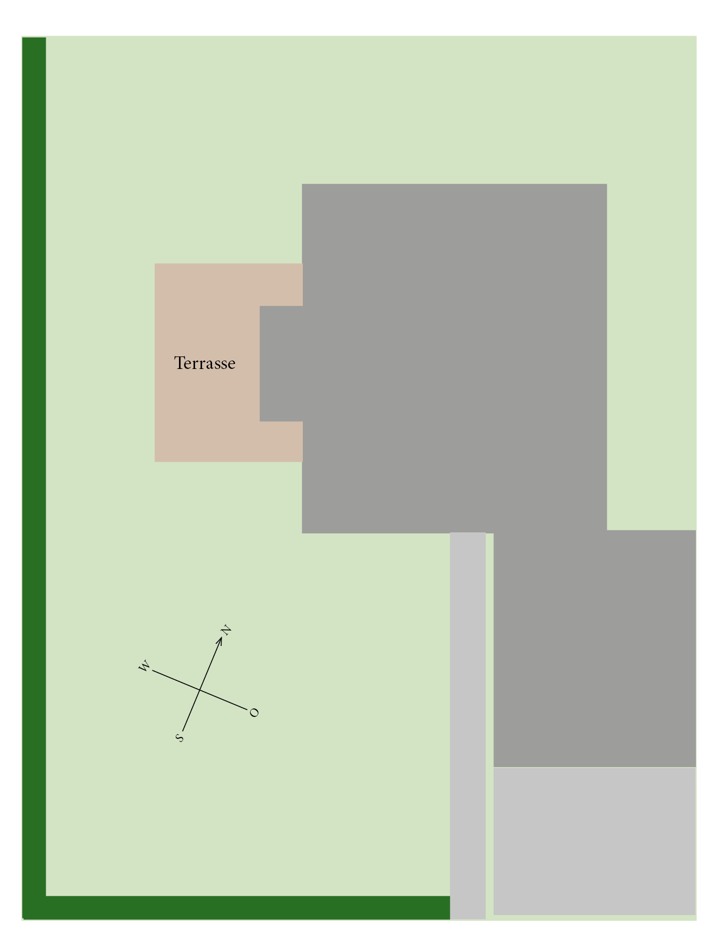

I first drew your old proposal, now the new one. This one is better, but I still miss the orientation towards the south garden. I would then place a separate shed for the workshop in the northern part. That way you also have privacy screening there.
The dark green is supposed to be hedges, the medium green beds, and the light green lawn
So here is my new proposal:
Pinky0301
2020-09-11 15:38:52
  • #2
Oh, only realized after looking at it for the 10th time that the white lines are just the dimension lines...
