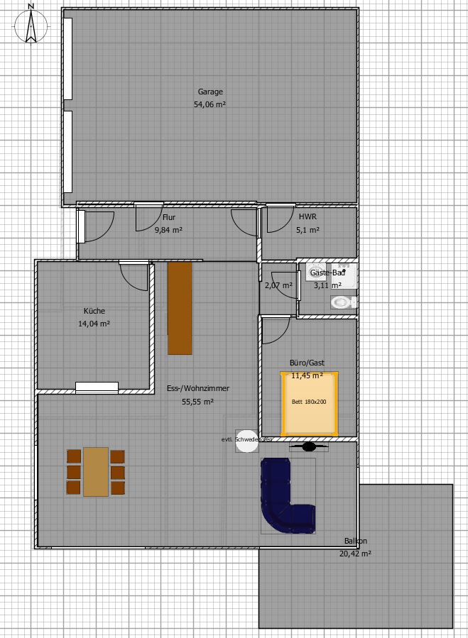

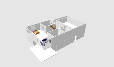

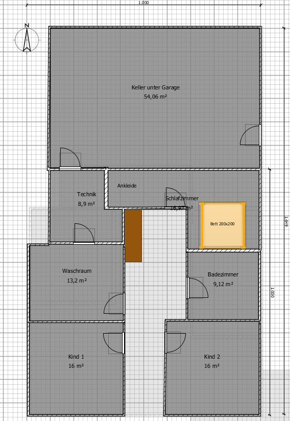

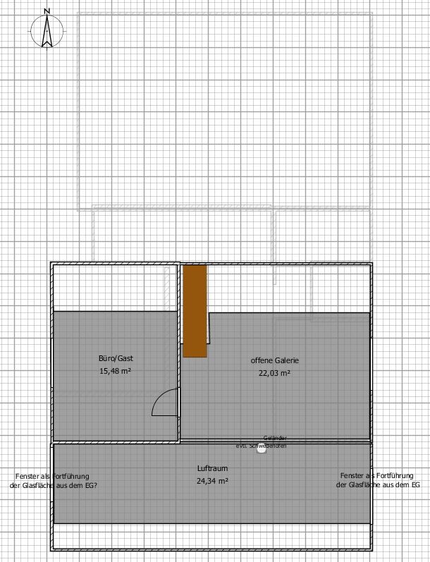

Hello everyone,
as I introduced myself in the general forum, we had some talks with different GCs, both solid construction and timber construction.
We are now at the point where we have some floor plan proposals.
I would like to present you here (first?) the design from the company Holz 1, which we especially like because of the gallery and which contains a lot of what we communicated as wishes in advance.
I redrew this myself, so please forgive me if some things look amateurish.
I mostly did not draw in the windows. What we would like very much would be the (probably very expensive) idea to have the eastern glass area at the southeast corner run over two floors; I just couldn’t find this representation quickly in the program.
I drew in the larger bed on the ground floor for size proportions (because this could potentially serve as a bedroom for us later).
What already came up in the linked thread above was that several forum members would move living/dining down to the garden level and for that the sleeping level upstairs.
Our reasons to plan it this way (but we are not completely fixed yet):
- significantly shorter distances for carrying groceries, taking out the trash, ...
- nicer view from the living area into the greenery/into the mini-valley I described than in the basement
- more generous living feeling through an open ceiling/the gallery
- being able to come in and "let yourself fall"
- simple facilitation of a frailty scenario (potentially living on one level later, at least for a certain time)
We are happy about further remarks, ideas, etc., thanks a lot in advance!

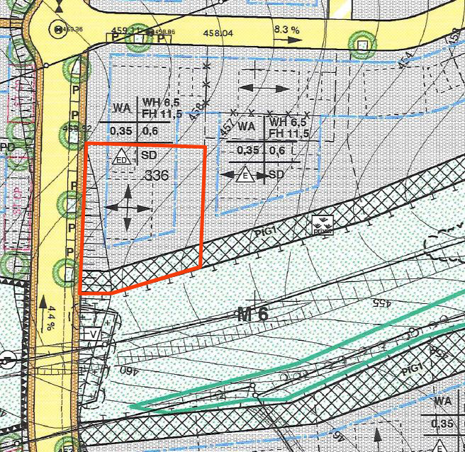

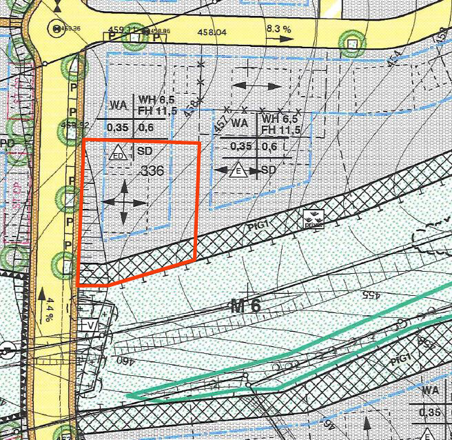

Development plan/restrictions
Plot size: 791 sqm
Slope: yes
Floor area ratio: 0.35
Plot ratio: 0.6
Building window, building line and boundary: see attachment
Number of parking spaces: 2 (double garage planned)
Number of floors: 2-2.5 (garden floor, ground floor, and possibly half attic as gallery with airspace above the ground floor)
Roof type: gable roof (35-42° specified)
Orientation: still open
Maximum heights/limits: WH: 6.5 m; FH: 11.5 m
Other specifications: Distance from house to street approx. 4.50 m (terrain slopes down from street)

:eek: Is that to scale?
2020-11-23 18:38:47
  • #3
I asked myself the same question. Your budget is too low for the house. Since one of you wants to downsize, I would start there. Why cellar the garage? It doesn't even have that much slope. Every excavator bucket costs. Always draw your furniture into every floor plan to scale.
2020-11-23 18:41:29
  • #4
Photos of original drawings help better - even if you don’t hold the camera completely straight. I hardly recognize anything in the Dreideh depictions ;-) I can’t enlarge them (?)
Ysop***
2020-11-23 19:18:42
  • #5
Um, so a picked example: ground floor open space huge and living gets the furthest squeezed corner? I can't imagine that it is really planned that way?
GeradeSchräg
2020-11-23 19:52:50
  • #6
The house is spaciously designed but the bathroom <10m²? I would definitely change that.. rather make the open space and gallery smaller
In addition, I (my personal opinion) would settle in the upper floor as parents, including bathroom and dressing room.. internal windows facing the open space.. Then you also have a great view in the morning.
Then the small bathroom is enough for the children
I see it the same way... hole in the ceiling for maintenance work on the car =D
