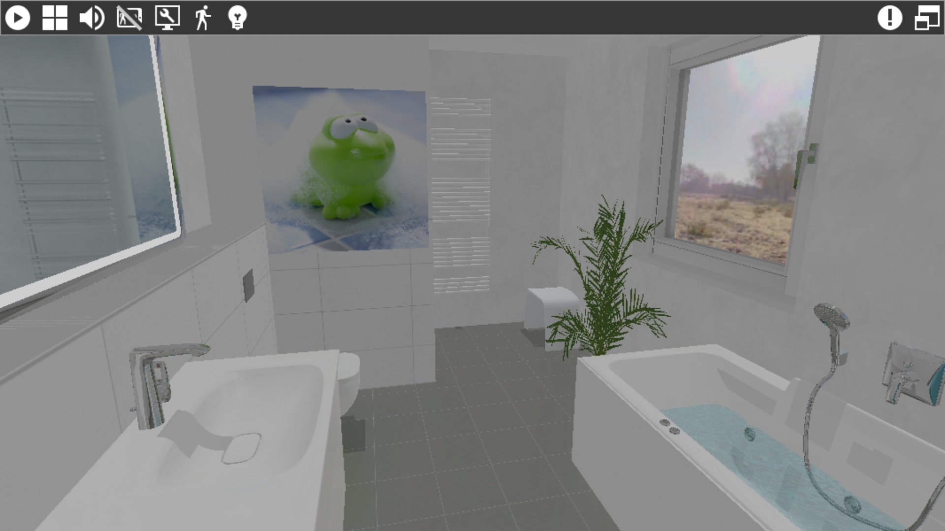

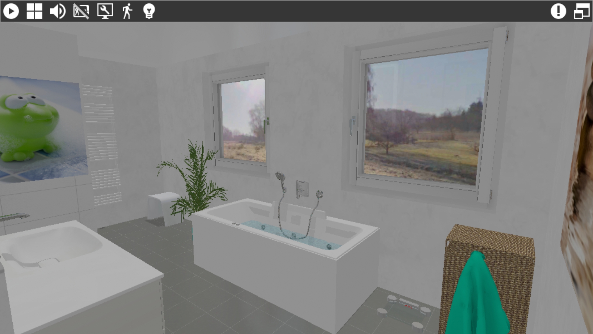

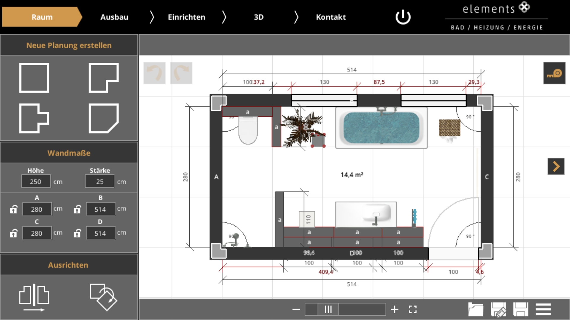

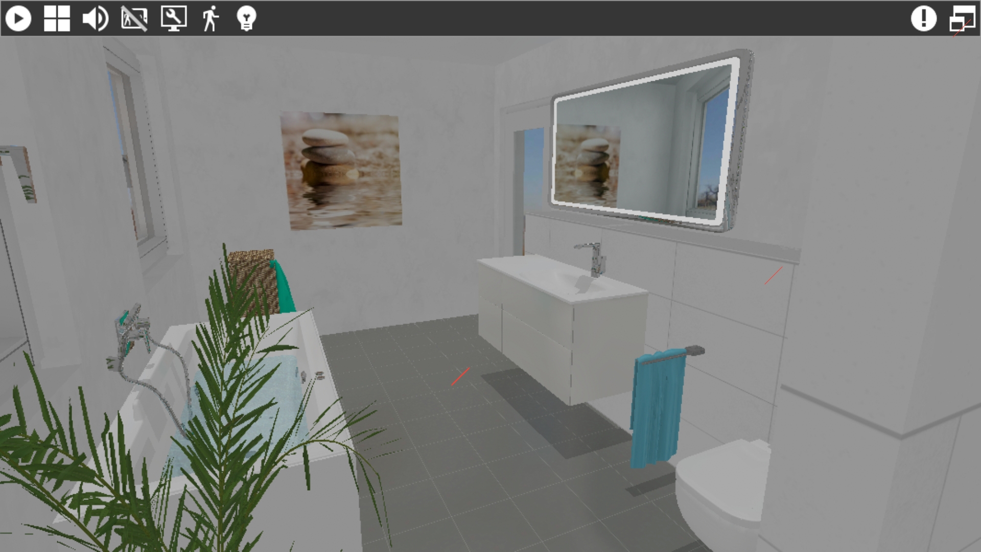

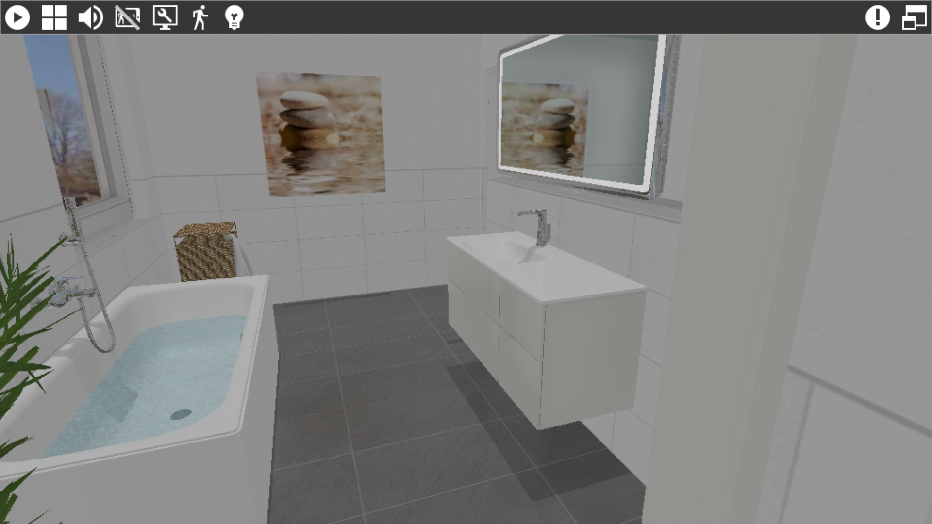

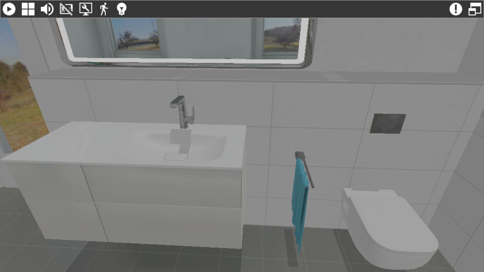

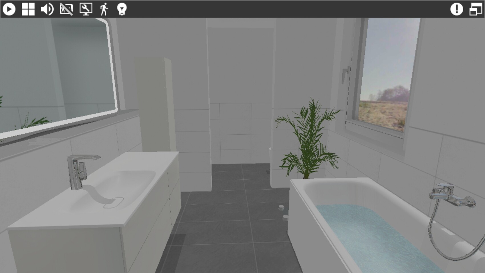

Hello dear farm-experienced people,
I have created a few 3D floor plans.
I have to say, I don't find the bathroom too big.
I have made 2 variants, maybe you would like to share your perspectives on them.
We will not go with the variant with the bathtub in the corner, it simply takes up too much space.
I have now made the original variant and one with a hidden toilet, as is often found.
The floor-to-ceiling windows probably won't be used because regular windows could be made wider and thus let in more light.
VIVS.29
2021-08-11 11:27:35
  • #2
That was probably too many files, it's hanging right now, but I'm working on it ;-)
VIVS.29
2021-08-11 11:40:25

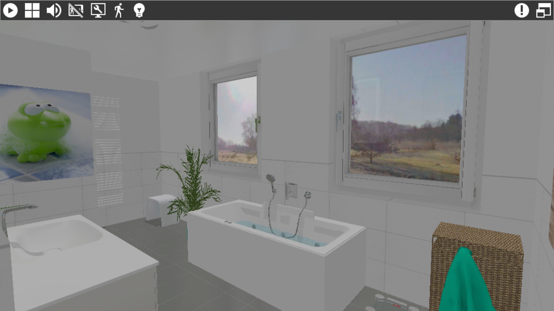

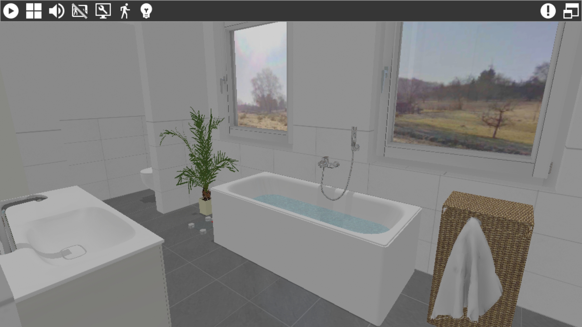

  • #3
And that was now the 2nd variant, very similar but still different.
2021-08-11 12:04:16
  • #4
Only in the ninth image of a floor plan discussion do you finally show a floor plan that the whole film of 3D snapshots refers to - and then it's not even the one the previous images are about ?????
hanghaus2000
2021-08-11 12:19:56
  • #5
I would only make the partition wall to the WC half high. In case no better idea comes up.
I wouldn’t want to shower if someone is sitting on the toilet. The original design is better there.
2021-08-11 12:42:13
  • #6
Tastes are so different: I wouldn't want to be showered over the half-high partition wall while sitting on the bowl ;-)
