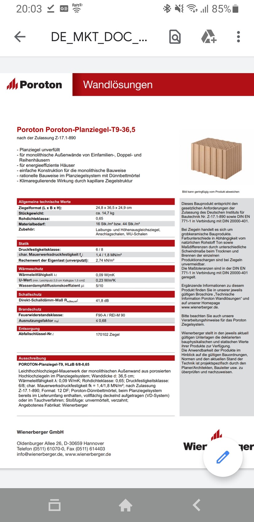

That would be our stone now. Does anyone have experience with it?

According to the datasheet, a very good stone, it will create your dream bungalow. Have you already found your construction companion?

So it is a stone that can be used for building. Monolithic with 36.5cm, it meets the energy standard, but no more. Sound insulation value as well. Don’t get me wrong, I just want to put the statement that this is a "very good stone" into perspective. It depends on what your requirements are. Everything else then becomes a matter of philosophy.
