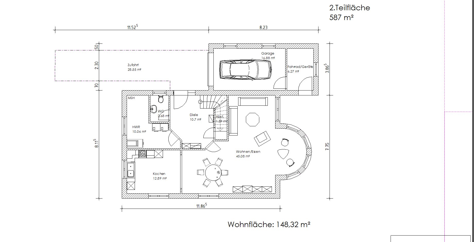

Hello
What do you think of the planning and the room layouts?
Best regards
RaBa2020

What I quickly noticed now:
1. How do you get into the corner behind the shower? Climb over the tub...?
2. Large hallway area, but I really don’t find the wardrobe in the corner sensible...
3. Living room and kitchen area are also large, but where does the TV go? The drawn-in furniture probably doesn’t correspond to reality.
BTW: The whole thing would probably work without the semi-circular extension. It actually doesn’t provide any added value.... except extra costs.

Please don’t quote it like that, no one will read it.
Actually, only the bell tower is missing, then it could also pass as a church. In my opinion, the arch is completely useless.
In short, the bathroom is very oddly planned, the children's room is relatively small, and the bedroom has a lot of wasted dead space. The hallway is huge but also of little value (similarly upstairs) for a wardrobe, and the slanted door to the utility room actually has no advantages.
The floor plan has a lot of wasted space and offers few storage options, etc.

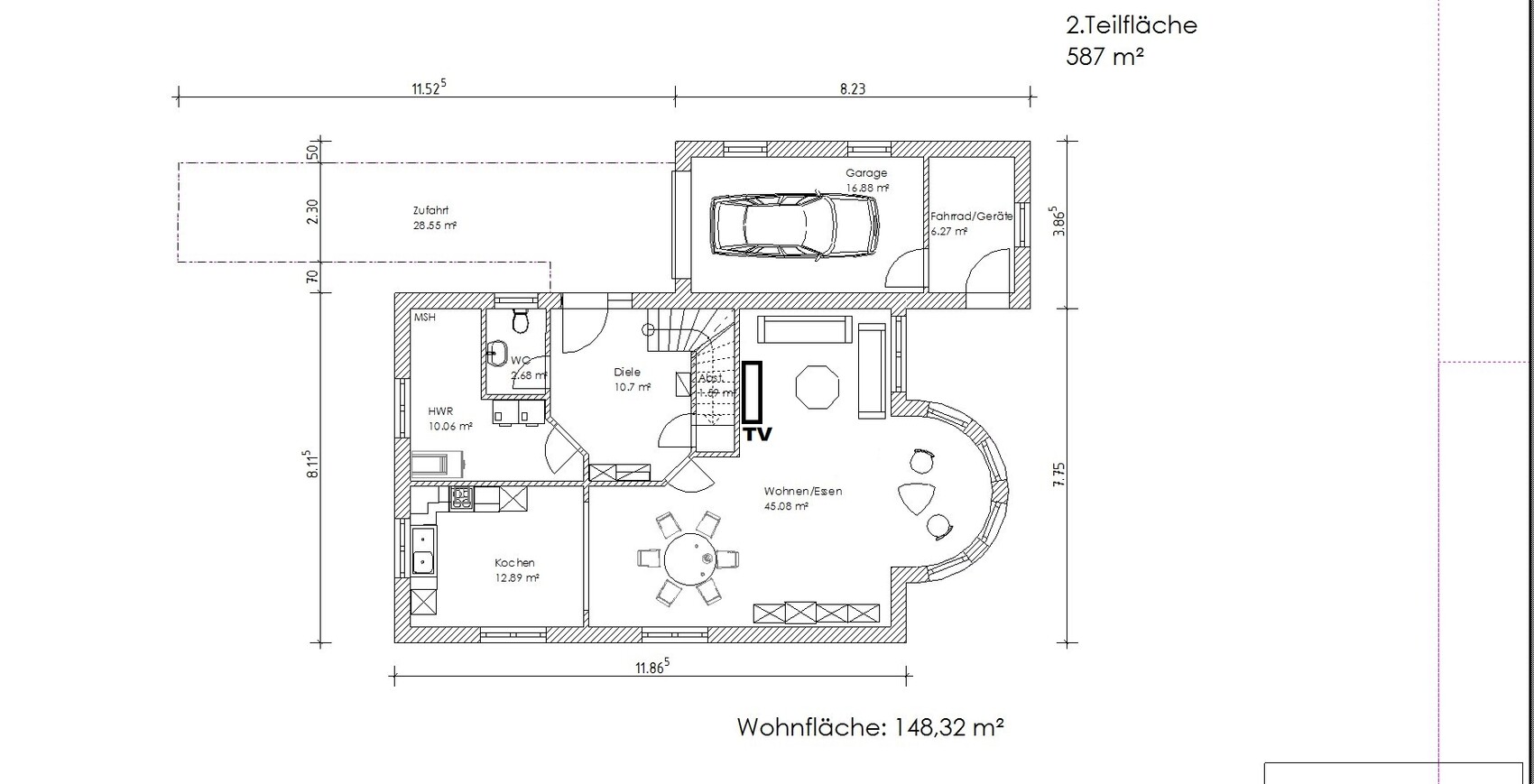

But on the whole, you should know it beforehand, shouldn't you...? Especially in the living area. If that corner is supposed to be the place for the sofa and TV, there are really only 3 arrangement options. The one drawn so far and these two... None of the three are great...
2020-01-21 13:58:31
  • #6
Then I would add it to the storage room. Does it have to have it? - at this size and with the garage attached, I would rather say, mortuary chapel Tell us more - the questionnaire is at the top of the floor plan section.
