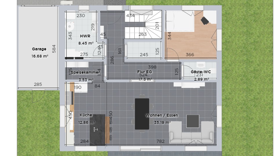

Hello dear forum,
what do the professionals say about the following floor plan (especially regarding the questions described below)? Does anything catch your eye that should definitely not be done?
Thank you in advance

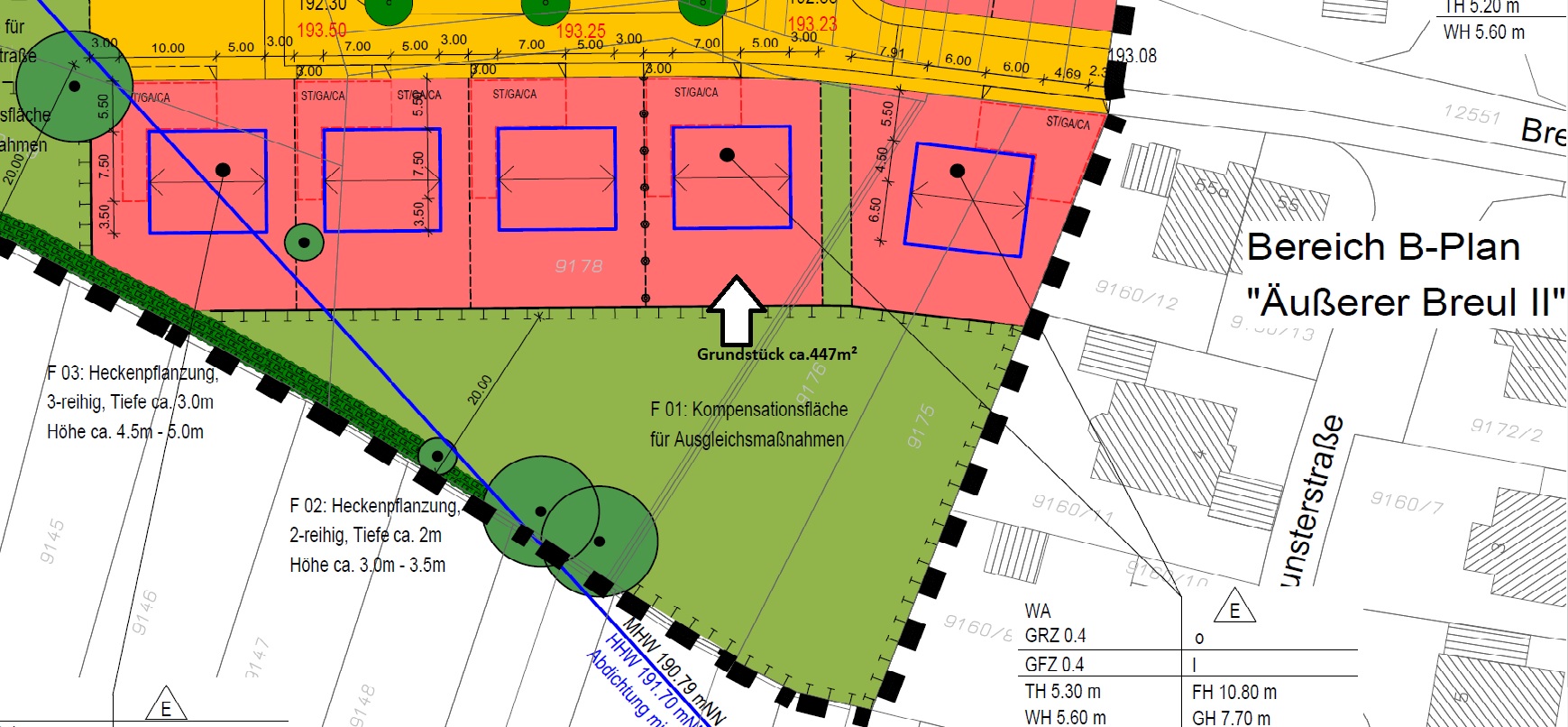

Development plan/restrictions
Plot size: 447m²
Slope: no, but the plot slopes about 80cm down from the street and needs to be filled
Site coverage ratio 0.4
Floor area ratio 0.4
Building window, building line and boundary
Edge development: see attachment
Number of parking spaces: single garage + 2 outdoor parking spaces
Number of floors: 1.5 (only 1 full floor = ground floor)
Roof shape: gable roof
Orientation: north/south
Maximum heights/limits: TH 5.30m; WH 5.60m; FH 10.80m; GH 7.70m

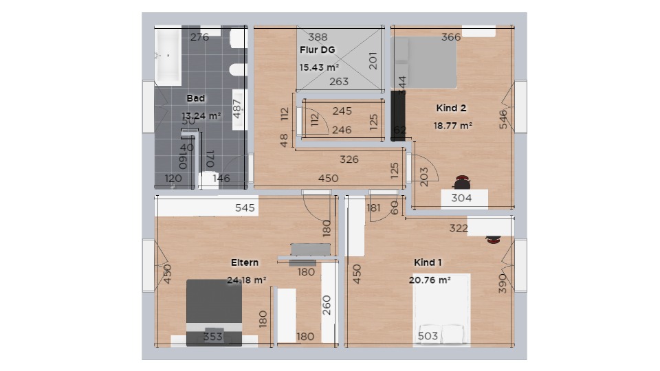

House design
Who prepared the design: general contractor and DIY
What do you like especially? Large living/dining area, open kitchen, many storage rooms, large walk-in shower
What do you dislike? Why? The corridor/hallway wastes a lot of space. Maybe the rooms can be arranged more space-efficiently?
Price estimate according to architect/planner: 400,000 without incidental building costs
Personal price limit for the house, including fittings: 430,000 without incidental building costs
Preferred heating technology: air-to-water heat pump with cooling function and underfloor heating
If you have to do without, which details/extensions
-can you do without: walk-in closet in the parents’ room, glass sliding door in the living/dining room, possibly make the utility room smaller, cooling function of the air-to-water heat pump
-can you not do without: large living/dining room with open kitchen, generous shower, storage rooms, and attic storage
Why did the design become what it is now?
The general contractor planned the house 10.5m x 8.50m with basement (white tank). Because of the groundwater level, the house would be about 80cm higher than the street, knee wall 1.20m, attic storage height only 1.20m. Staircase to the house entrance necessary. Due to the small rooms and expensive basement, I designed a floor plan without a basement myself. I increased the living room width from 3.85m to 4.50m.
What is the most important/fundamental question about the floor plan summarized in 130 characters?
How can I use the room layout and arrangement more effectively? How and where can I save space? The hallway area on the ground floor unfortunately consumes many square meters, although it is only 1.25m wide. One reason is the large staircase, but also the long corridor swallows space and looks somewhat tubular. Maybe the living area of currently approx. 170m² can be cleverly reduced to 160m² or less? Different staircase? Move the entrance door? Is there an effective alternative to the cooling function of the underfloor heating? The goal is to save costs through optimization.
I am thankful for every opinion, suggestion, and sketch!
