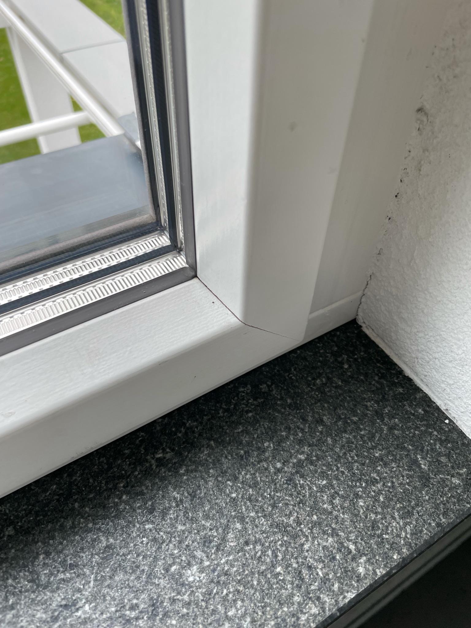

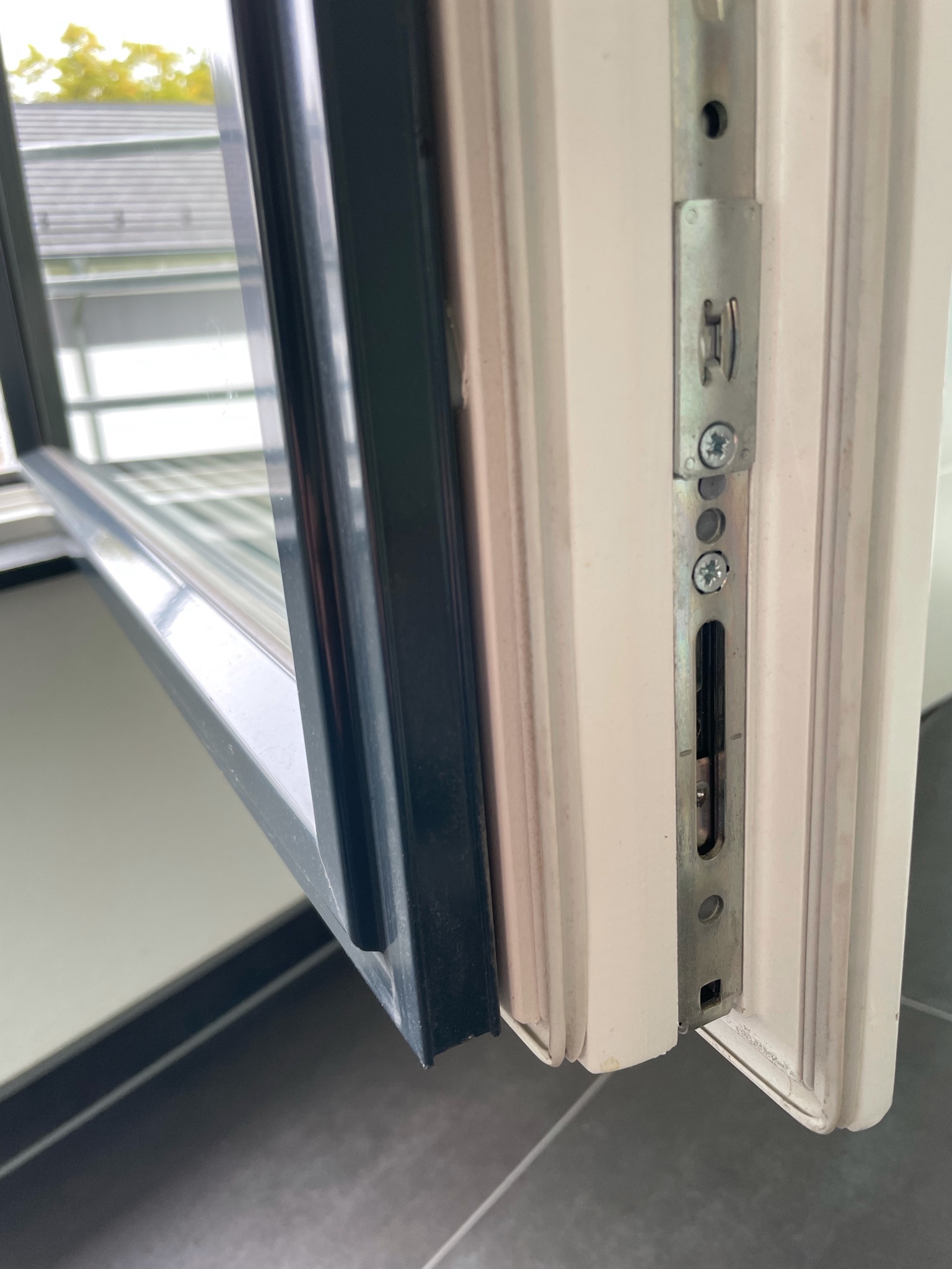

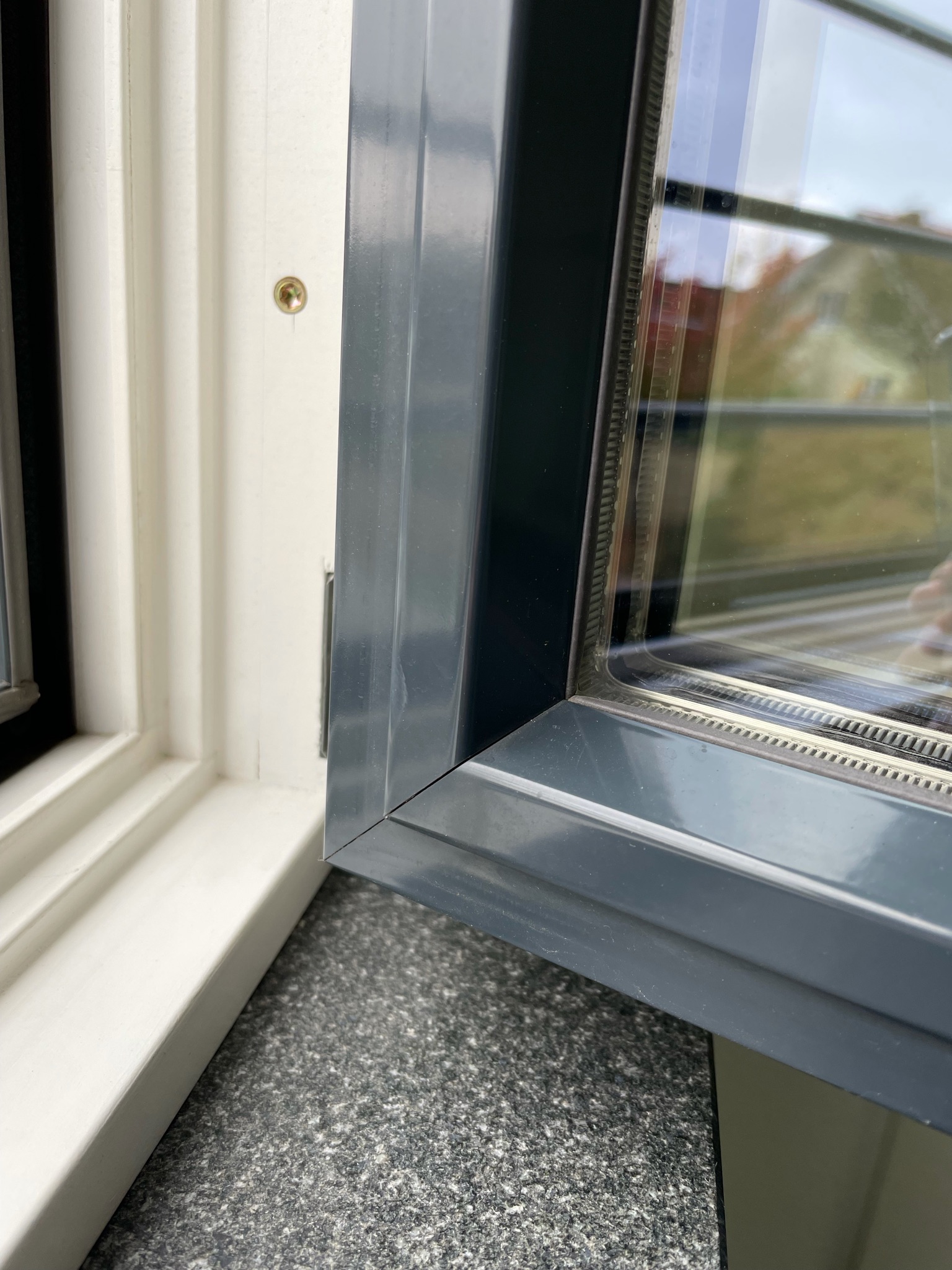

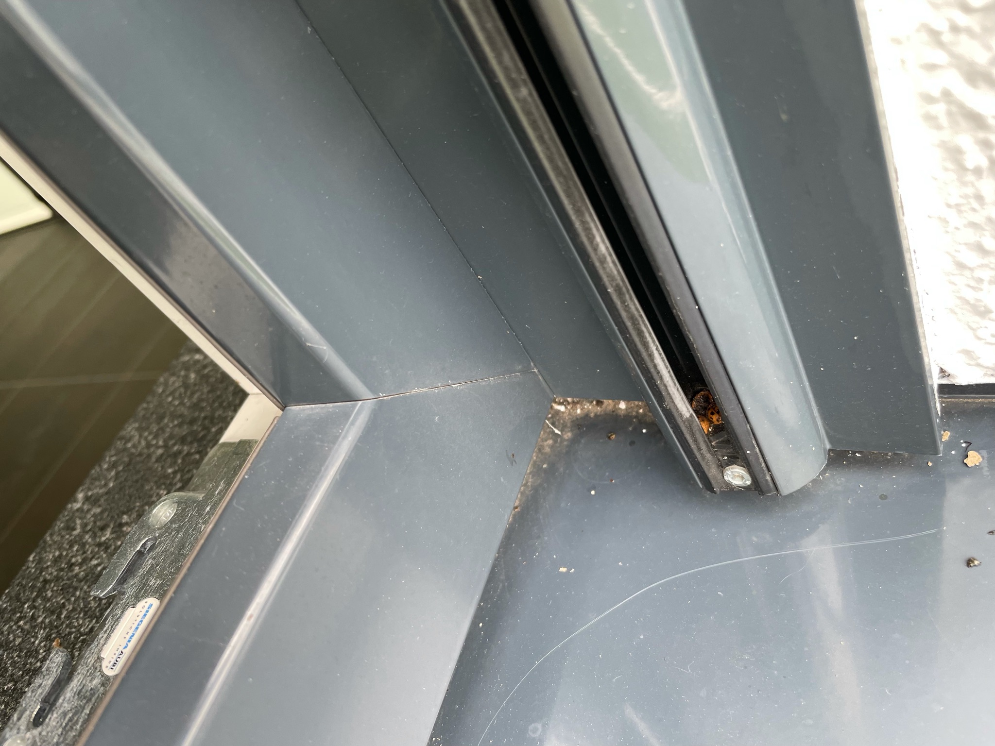

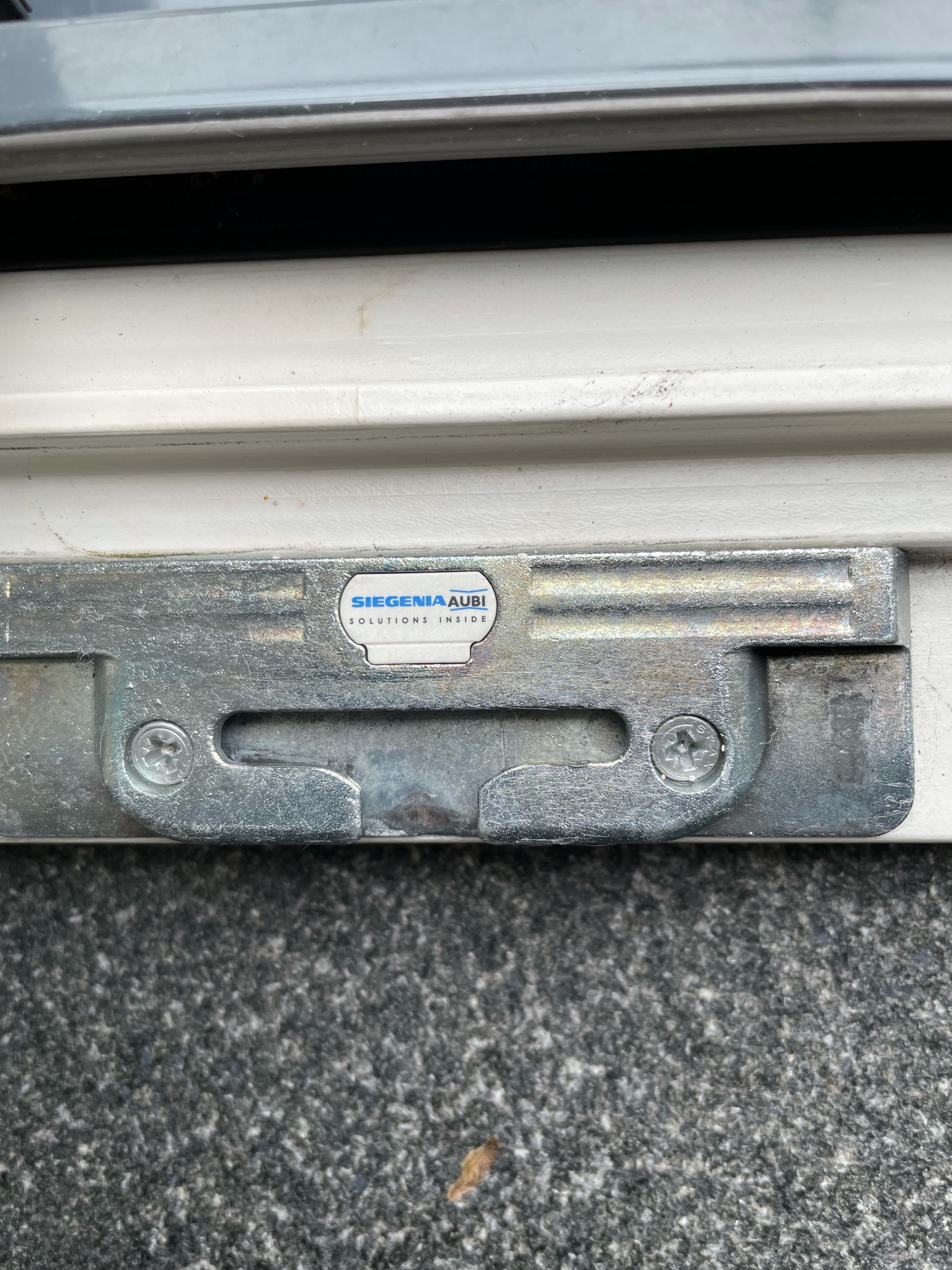

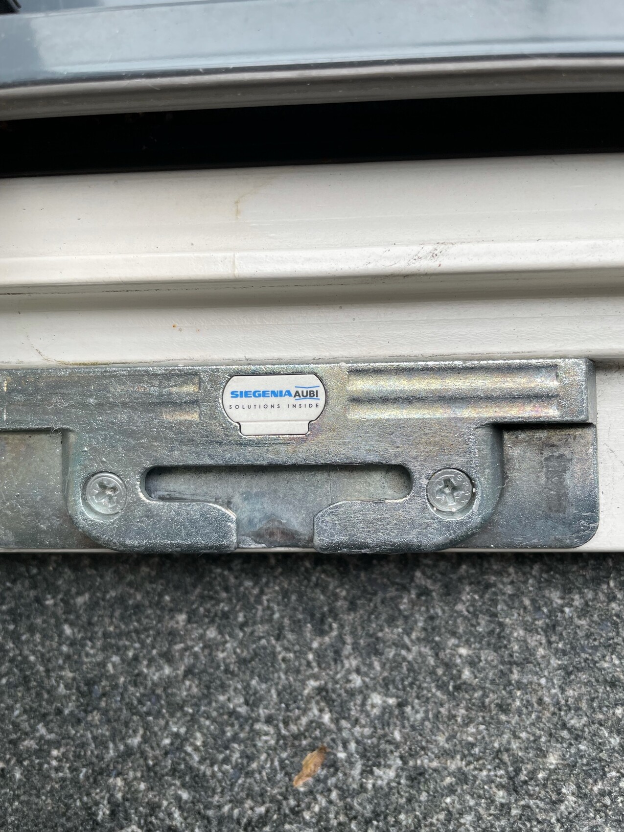

So, we spontaneously decided yesterday to also visit the third show house of our preferred home builder. It was a good decision because here the wood-aluminum windows were actually installed and even white on the inside, just as we originally WANTED.

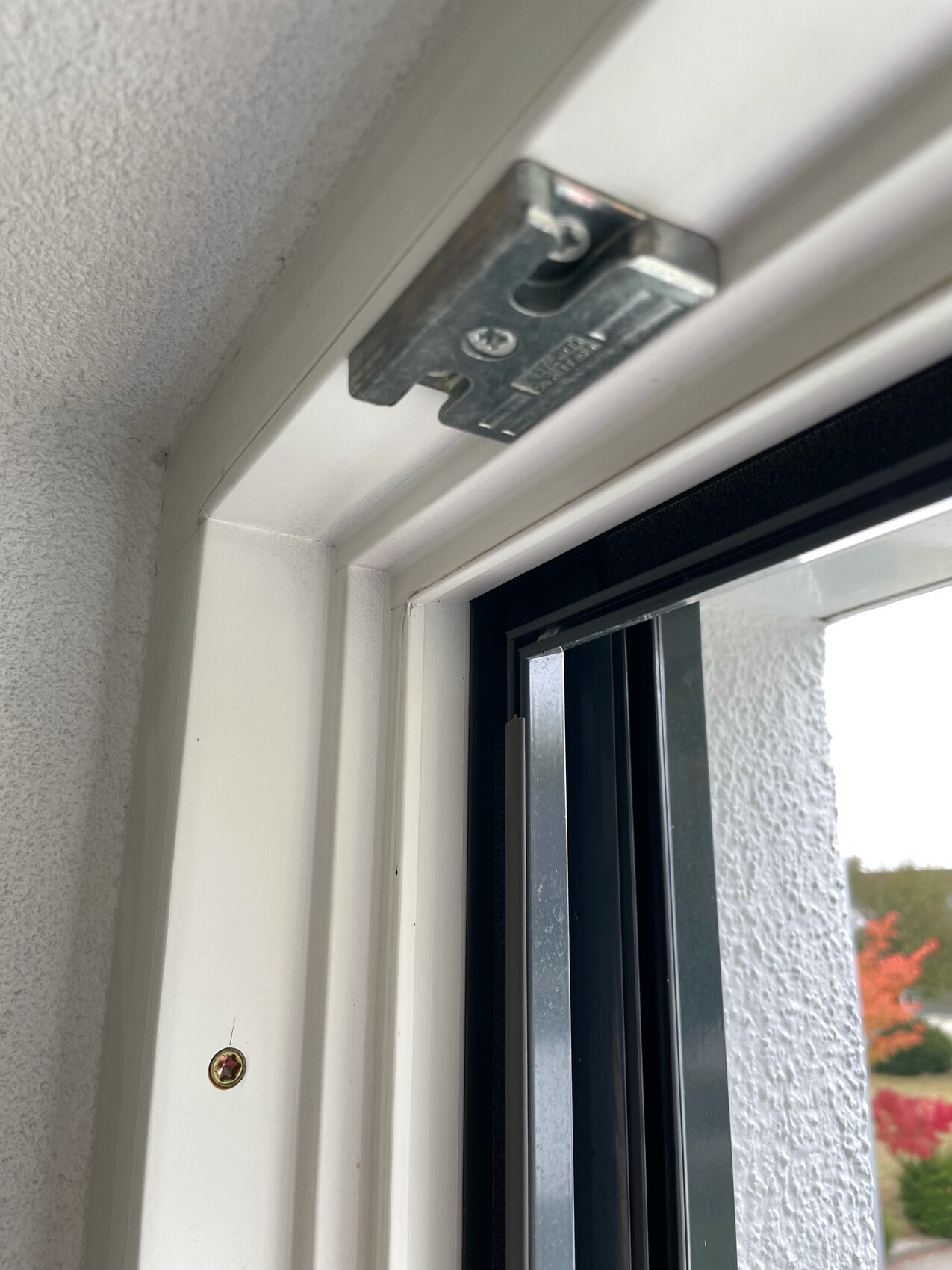

Please take a look at this, I have to say that the quality didn’t exactly blow us away. The aluminum cover strips somehow don’t seem to be really “welded,” but there isn’t much of a gap either. The house was built in 2012, of course that’s already 9 years ago, but I actually plan to live in my house longer. Some of the handles were even a bit loose. Cracks were also visible at the corners inside :eek:. That wouldn’t bother us (since we decided yesterday to have the windows black both inside and outside (not anthracite)), but if that was more of a sign of “not good,” that would be very unfortunate.
We also asked the seller there who the manufacturer of the windows is. So the wood-aluminum windows come from a smaller company from the region of the home builder called “Fenster Braun.” Maybe someone knows this brand? Unfortunately, you won’t find much information on their homepage :confused:. The plastic windows come from a company not far from the home builder called “Gugelfuss,” their homepage is designed a bit more stylish but that doesn’t mean much at first.
I don’t know either company, so I would be grateful for your feedback here as well.
We still tend to prefer the wood-aluminum windows (which maybe won’t be as affected by the desired black color over time!?), but as already written in the initial post, this is not really justifiable.

Honestly, I wouldn't focus so much on the show homes; they are often not even from the manufacturer who is working there, especially in show home parks. Do you have the opportunity to visit construction sites of your preferred building companies?

The windows look pretty decent. Of course the handles wobble after nine years if even every twentieth dachshund wants to test the quality. Show houses simply get more “visitors” than the rest of us.
Most window manufacturers don’t have their own production (and conversely, we would have been better off not doing direct consumer business as a manufacturer back then). In automotive manufacturing, this is called “badge engineering,” when you just slap your brand stickers on a product bought ready-made. All the fuss about ISO, RAL, and Rosenheim certification is not economically feasible for a small business. So it’s usually Schüco, Kömmerling, or the like inside if “unknown brand” is on the label. If the same window manufacturer still supplies your favorite today, they probably aren’t bad.

Then just take those! If you choose other windows now, you'll regret it - no matter which is of higher quality. Quality is very subjective, and usually, you install what you can afford and what you trust. Windows from brand manufacturers are always a good solution: they all work. Handles can be replaced, readjusted... the locks and catches as well. Anyway: take what you can afford and what you trust!

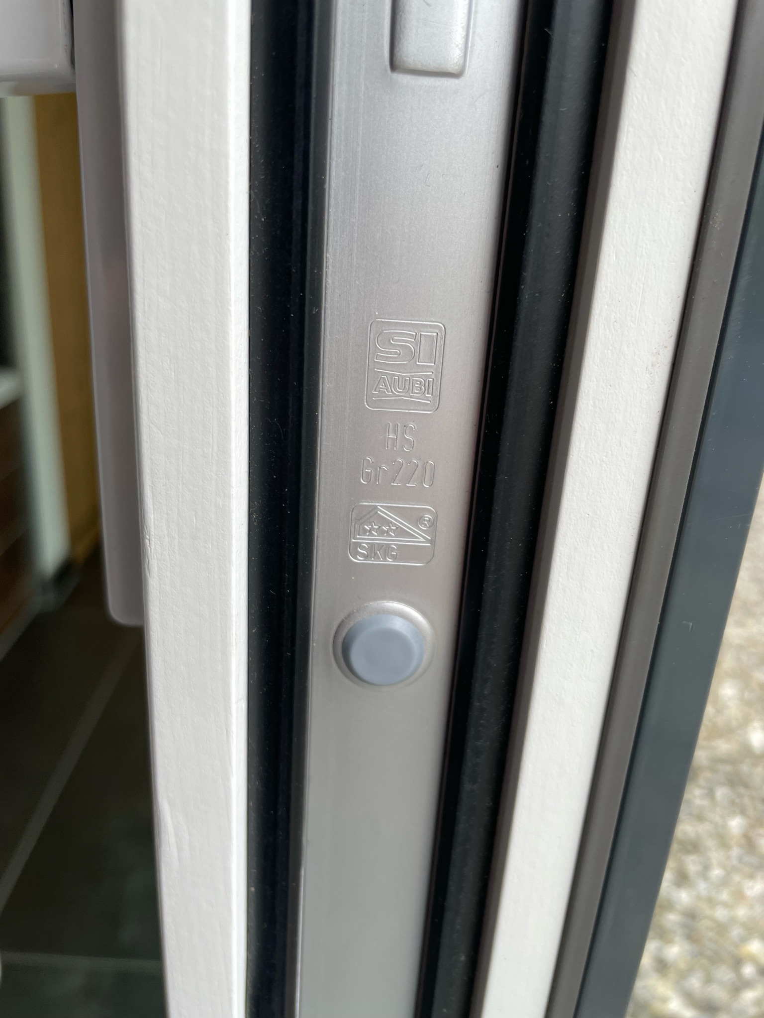

You speak in riddles as often… Winkelmann? Fresh stone gray? Deep black, because we imagined black accents a long time ago (fittings, railings, etc.). Since we have a lot of white and rather little decoration, black windows probably wouldn’t be very oppressive, more likely the right contrast (presumably)!? With black, you (hopefully) also don’t see the cracks so easily :-). Venetian blinds are also planned in black (as said, not anthracite). That actually makes me really happy!! Did you look at all the pictures? The cracks in the white corners? The brand of the fittings? Is all that any good? Thanks! Your encouragement feels unbelievably good, considering all the decisions we (one) have to make. I think if something here were completely out of line, there would also be a justified objection!?
