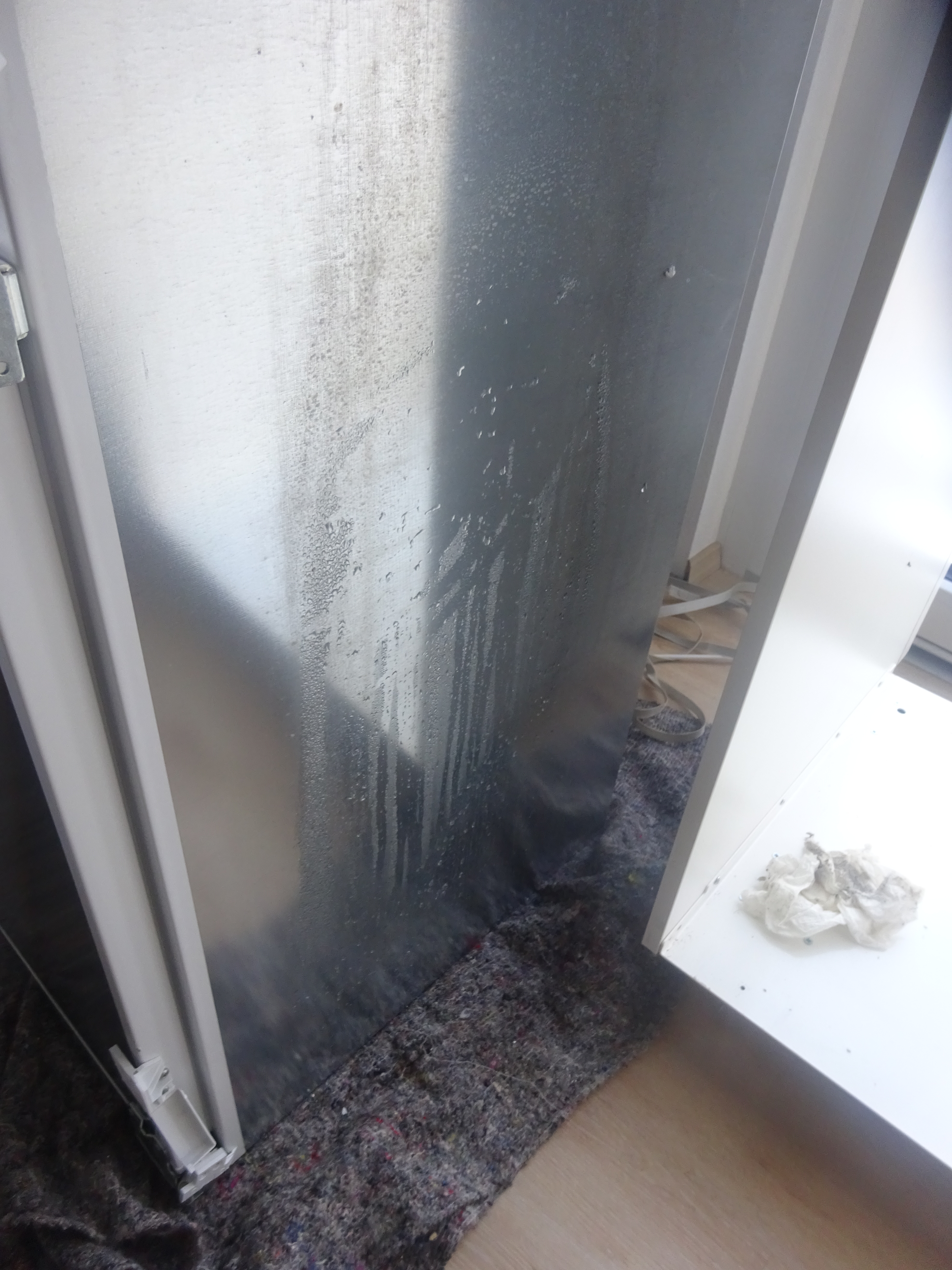

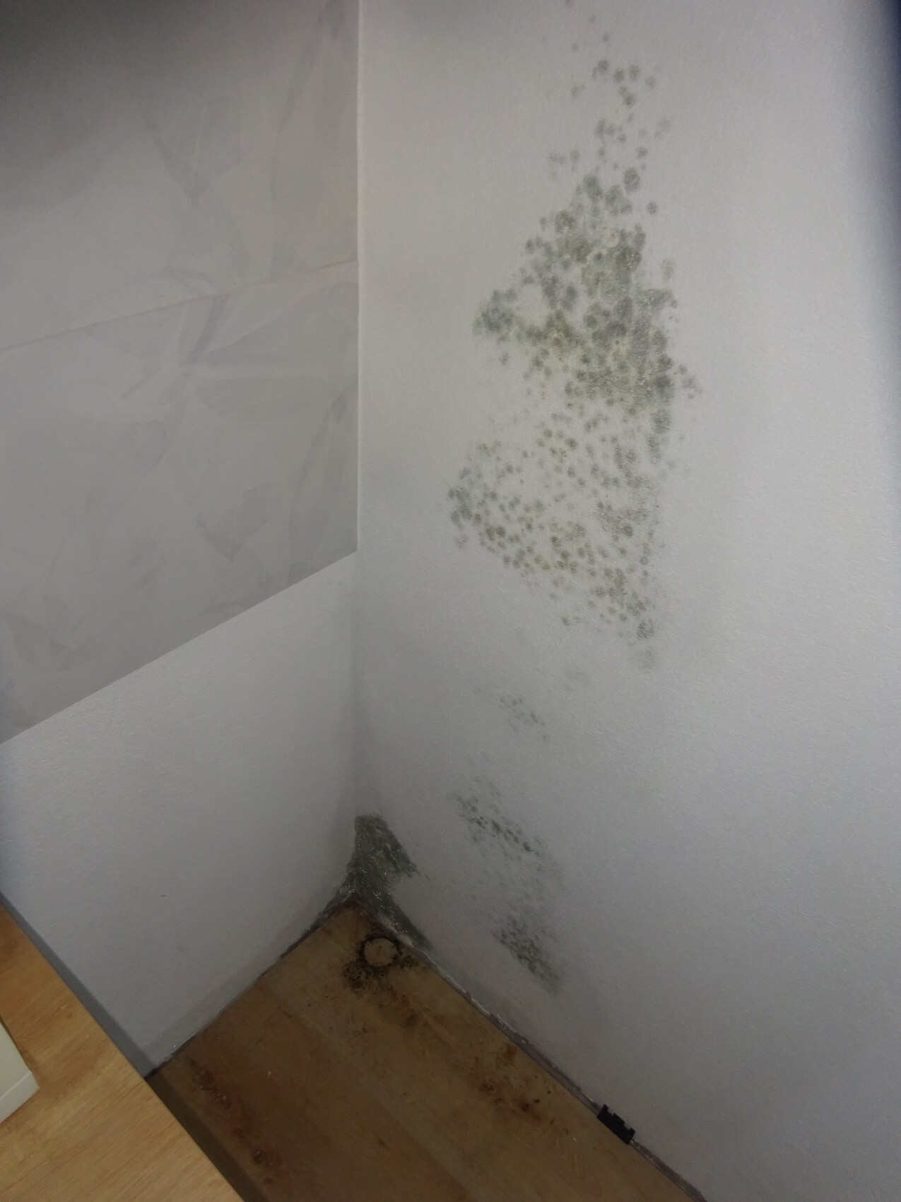

It became noticeable when water suddenly ran out from under the refrigerator. At first, I thought it was a device defect, but apparently, it is not. We have a built-in refrigerator and removed the cabinet in which it was installed, and behind it was the horror: Mold in the lower corner of the room and on the wall next to the refrigerator (see picture). There was even mold between the refrigerator and the built-in cabinet (picture 2). The entire right side wall of the appliance was covered with water droplets (picture 3).
Known craftsmen (tilers and plasterers) looked at it and said it was condensed water from the humidity in the air. The air cannot circulate properly around this cabinet, causing this problem. Additionally, the refrigerator is placed directly in the corner of the room against two exterior walls (northeast).
How should this problem be approached? Removing the mold and drying everything well at first is logical.
The tiler suggested that I install an air ventilation system in the wall above the refrigerator to regulate the moisture. I also find that quite plausible, but I am concerned that because the cabinet on the right stands directly against the wall (max. 0.5 to 1 cm gap), condensate will continue to form there despite ventilation.
Are there any additional measures that could be taken here – possibly to fill the small cavity somehow?
