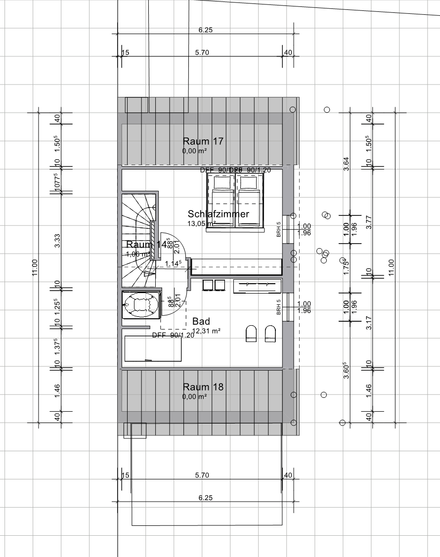

- The attic (parents’ bedroom and parents’ bathroom) is a work in progress. If anyone has tips on how to nicely place the bathroom there: please share them. I am currently struggling especially with the planning of the downpipes.
- In the attic -> The walls stand exactly at the 1m height. The wall in the bathroom that stands so oddly next to the shower is on the 2m line.

- On the south side there should be photovoltaic panels -> few roof windows desired.

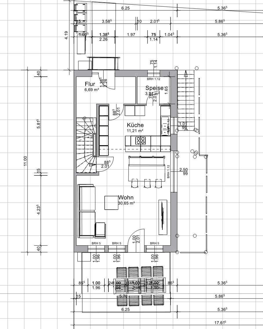

A few questions:
- Staircase from ground floor to upper floor -> quarter turn. Otherwise half turn. Does anyone have that and would advise against it or is it okay like that?
- I just had the idea to wall up the staircase on both sides. The niche in the stairwell U I would then use as a service shaft (e.g., for underfloor heating). Is that possible? Does anyone do that? In other words, a drywall tunnel from basement to attic (with appropriate fastening on each floor slab – of course, I can’t stack drywall over 4 floors like that).

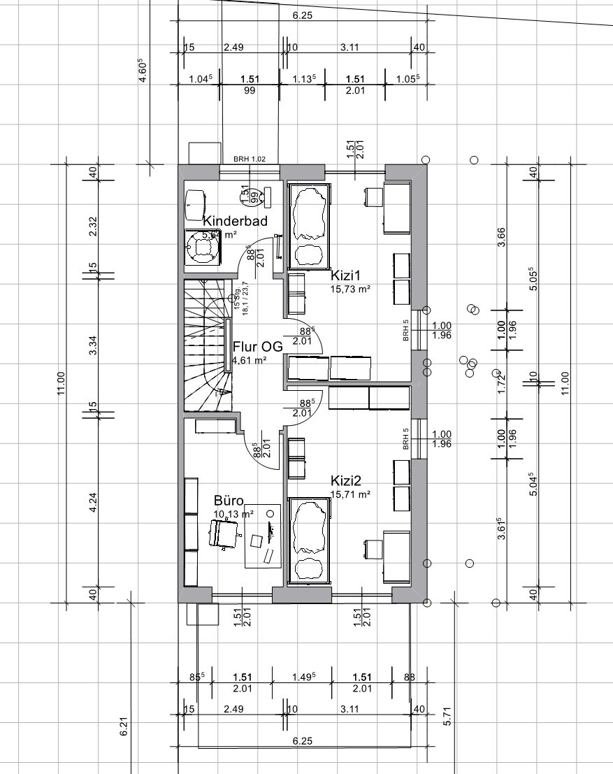

Number of people, age - 4 - 2 adults, 2 elementary school children
Space requirements on ground and upper floors - large living area on one floor, then children’s floor, then parents’ floor
Office: family use or home office? Mostly home office, both of us work at least 50% from home (also without Corona)
Overnight guests per year - grandparents regularly up to a week
Open or closed architecture - the living area should be clearly separated from the children’s floor

- The separation from the living room to the stairs: currently the open design annoys us every evening -> kids.
- The pantry (as small as it is).

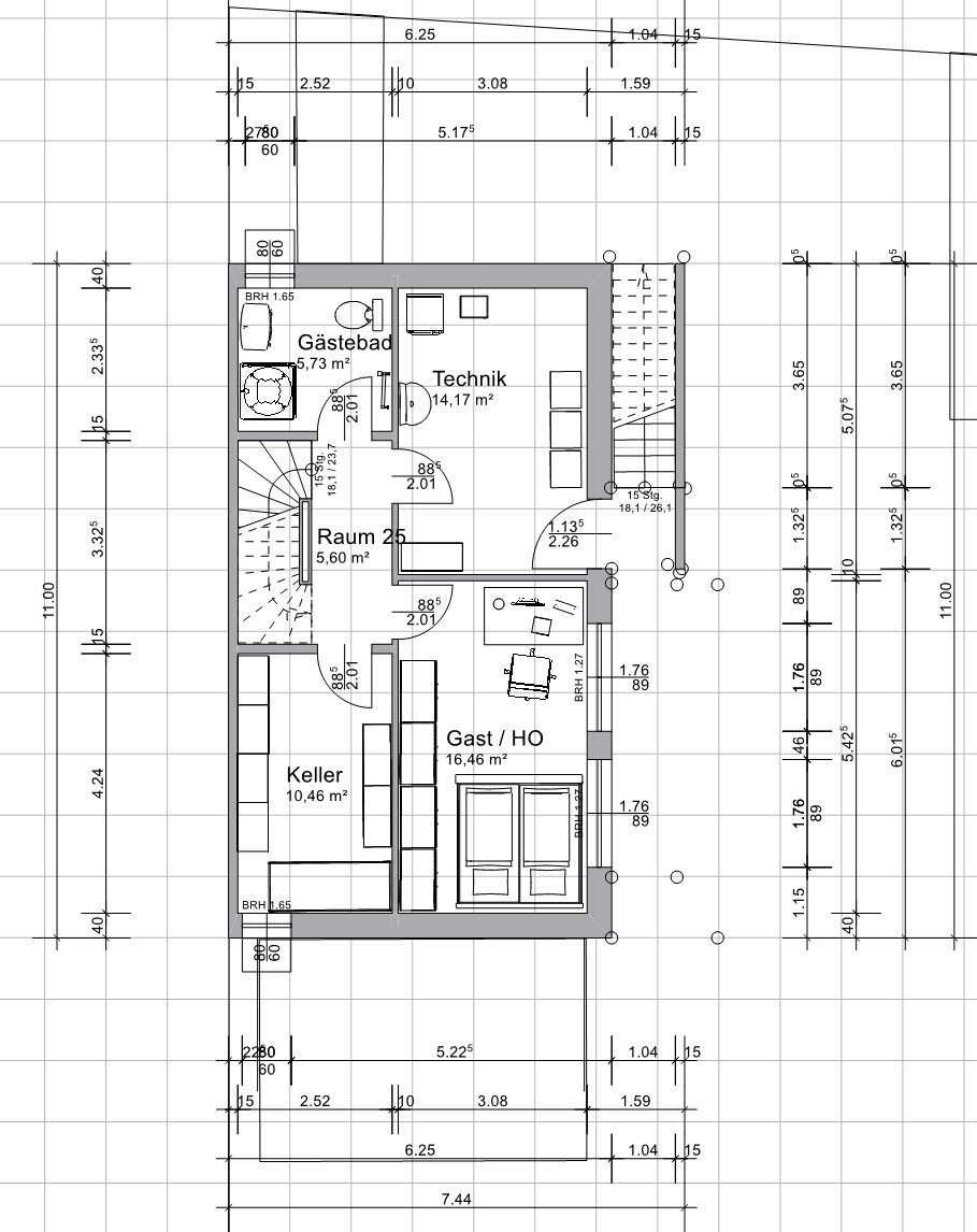

- The stairs to the basement: we all ride bikes a lot and also like to ride in the mud. Access via basement and extra shower in the basement is great.
- The parents’ bedroom in the attic is on the north side (a bit cooler and away from the driveway street).
