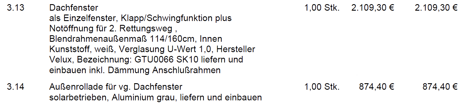

One more offer (is already installed and also paid for) The shading is included as well as the emergency exit opening It is almost exactly €3000 (net) Additional effort afterwards for sure: • Scaffold (or similar) required • Cover tiles • Cut and remove roof insulation • Set replacement afterwards etc.

We also plan to install one – or several – skylights only after construction, if they are really needed then. They are offered between 1,800 and 2,000 depending on the size. However, the builder said it is not a problem and not very expensive to retrofit them, and if you want to save money, he would do it exactly there. I would also rather pay attention to what said: to provide empty conduits and connections for heating in advance. Or a triangular window, which is difficult to retrofit.
