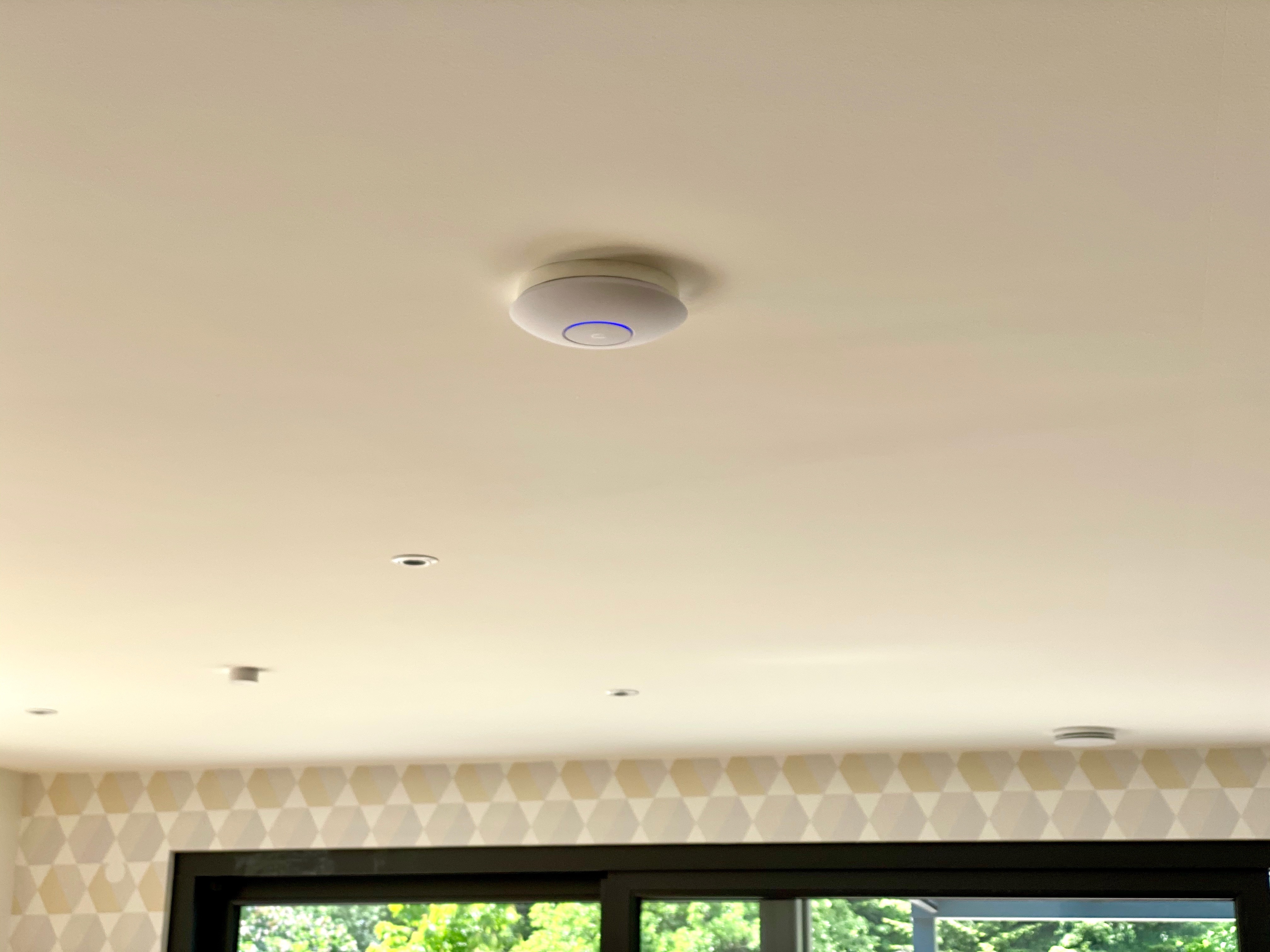

But beware: If there is a factory-assembled RJ45 at the end, which is probably common with installation cables, it might be too bulky for the access point.
Since we also did not consider a sufficiently large empty conduit, we mounted a thin ring between the ceiling and the access point, which then holds the Keystone module and the end of the short network cable.
rick2018
2020-06-10 17:37:25
  • #3
Better a hollow box or chisel something out. If necessary, the solution from Opalau also works.

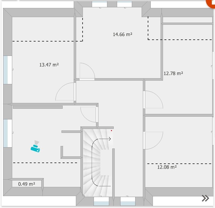

Oh wow, I have to google some words first. We are both computer scientists, but I have never heard of some terms.
I think it will be difficult to teach the electrician to leave a CAT cable hanging from the ceiling. We already have more communication problems with him than I like.
We had considered putting a socket in the hallway and placing the access point either high up on a wall or on a shelf in the hallway. It would also work on the ceiling (it's drywall).
rick2018
2020-06-11 09:01:59
  • #5
Attach it to the ceiling. If it is suspended, even easier. At that point, you only need a 3cm hole.
