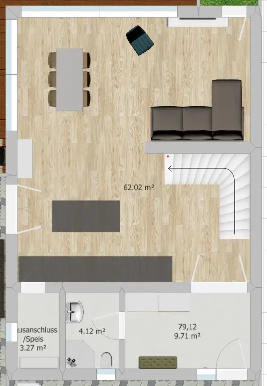

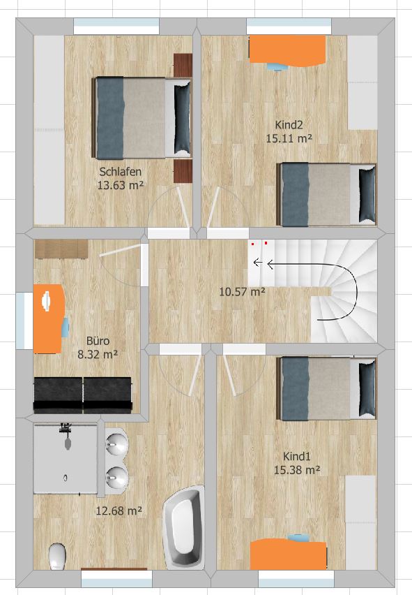

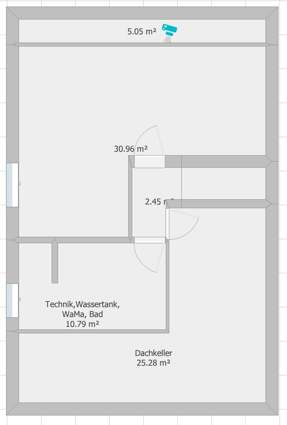

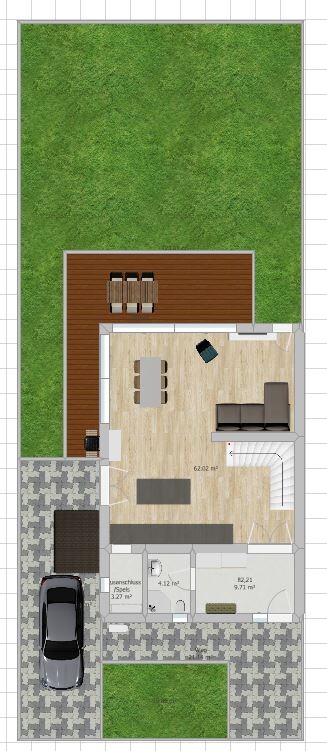

Hello everyone,

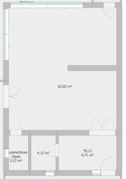

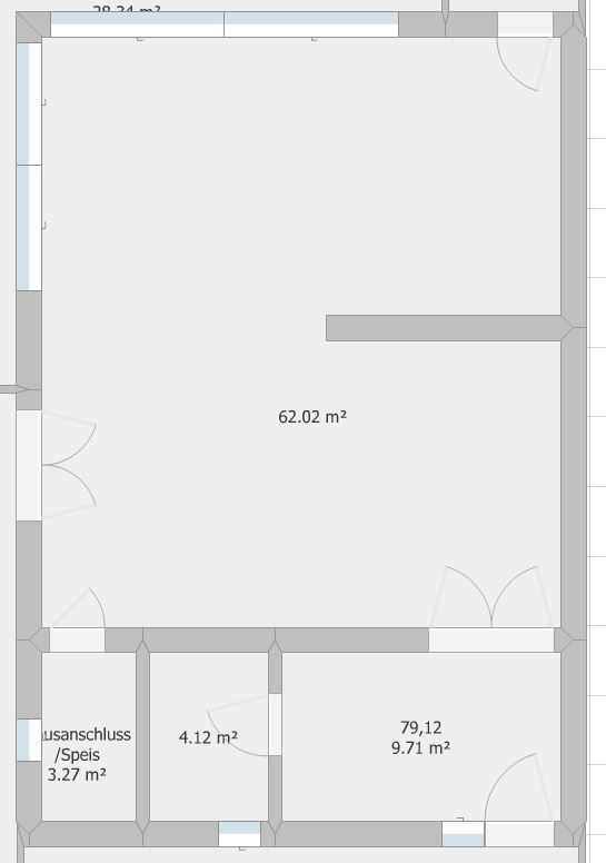

we have purchased a 337 sqm plot on which we now want to build our semi-detached house. We are in talks with various construction companies and the approach is unfortunately always different. Since we are often presented with floor plans based on our key data that we do not like at all (often a standard 8/15 semi-detached house), we have started to think for ourselves. It is also quite different that one company has a problem with the statics on the ground floor with 8x12m and another company does not. Likewise, our wish is to place the technology in the attic (see separate thread).
Now I would like to have your assessment of our DIY floor plan. Does that make sense? What have we not considered? Feel free to also make constructive counter-proposals, as I don’t really like, for example, the bathroom/office solution on the upper floor.

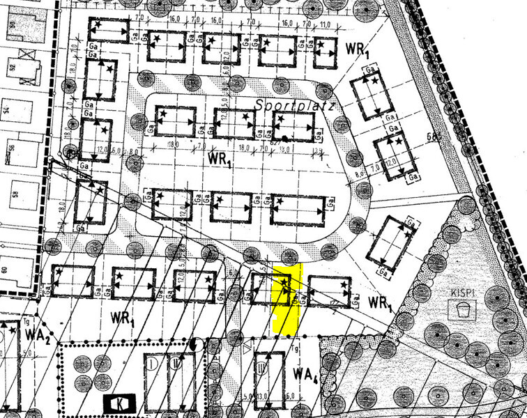

Development plan/restrictions
Size of the plot: 337 sqm
Slope: no
Site coverage index: 0.35
Floor area ratio: 0.7
Building window, building line and boundary: 12m length, plot is 11.5m wide, so ergo 8.5m???
Edge development
Number of parking spaces: 2
Number of floors: 2.5
Roof type, gable roof 30 degrees, no knee wall
Style
Garden side orientation completely south
Maximum heights/limits: 12m length, 6.5m eaves
Further requirements: neighboring semi-detached house will also be built later without a basement with the dimensions 8.5x10.10, smaller than ours

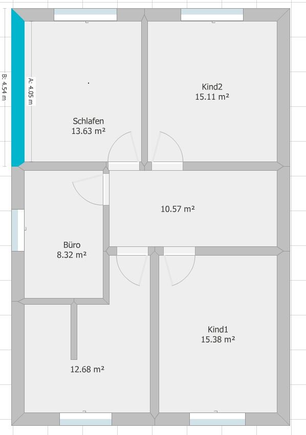

Space requirements on the ground floor, upper floor: ground floor airy bright, spacious, upper floor 3 bedrooms, bathroom, study
Office: family use or home office? HO

Open or closed architecture: open
Conservative or modern construction: modern
Open kitchen, cooking island: open with island
Number of dining places: 6
Fireplace: no
Music/stereo wall: no, TV on wall
Balcony, roof terrace: terrace (added later)
Garage, carport: none, because garage space is very disadvantageous

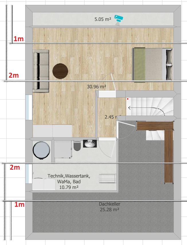

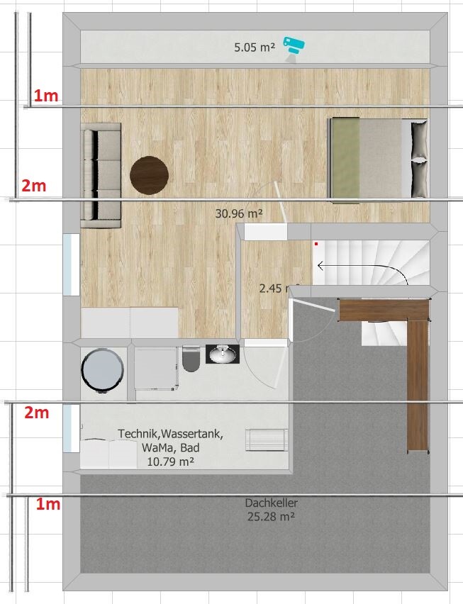

-House technology preferably in the attic, since we mostly stay on the ground floor and want to have a lot of space there
- Standard floor plan with U-staircase to be avoided if possible, therefore also the compromise on the ground floor of a V-staircase with glass railing, open without storage under the stairs, ground and attic floor spiral staircase
- Lots of window area, lift-and-slide windows on the ground floor with external blinds, as it is the south side
- Kitchen/couch somewhat separated and not too close to each other
- Ceiling height ground floor at least 2.65m
- Use the roof cellar incl. slopes
House design
From whom is the planning: DIY
What do you particularly like? Why? Open living area, open staircase
What do you not like? Why? Bathroom/office on the upper floor

- cannot do without: separate office
