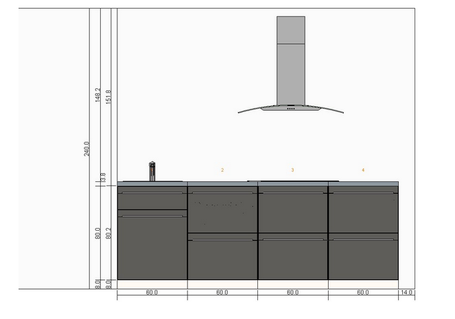

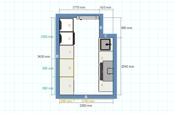

Hello,
I am planning an Ikea Metod kitchen but do not want Ikea appliances.
Pictures of the plan are attached.
The window and the heater are opposite the door and do not affect the planning.
The connection for the sink and dishwasher is in the corner, where the sink is also planned.
Next to the sink cabinet, there is a cabinet (space) planned for the dishwasher.
I have already looked at Neff but have not yet decided on a dishwasher. It should be a fully integrated device that is also quiet and has an A or A rating.
Any suggestions? Price up to max. 500.-
In addition, the high-voltage connection is on this side (right) of the kitchen.
On the right side, I have planned four 60 cm cabinets (one "cabinet" is the dishwasher space) to use the space as efficiently as possible.
I would like to use an 80 cm induction hob from Neff.
Since the cabinets are only 60 cm wide, the question arises whether an overlapping installation is possible, especially since the cabinet to the left of the induction hob is intended for the dishwasher. Also, I do not understand the first drawing (in the link above). Can someone explain this gap?

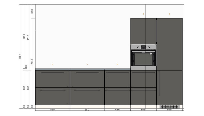

On the left side, a built-in refrigerator is planned in the first tall cabinet (in the corner).
I have not chosen one yet and am open to suggestions.
Next to it, there will be a tall cabinet with an oven.
The tall cabinets are 208 cm high. Then follow one 60 cm and two 80 cm drawer cabinets.
Alternatively, I could also place the induction hob on the left side (in the middle 80 cm cabinet), but then I would have to extend the high-voltage connection.
The budget is around 5000 euros, and according to the plan, this should also be possible including appliances.

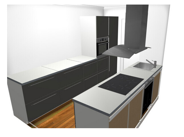

Here are more pictures of the planned kitchen:

I have a sink on the wall because it was not possible otherwise in the very small kitchen, but it is very impractical when washing dishes. There should be some freedom of movement on both sides. With the given price, I would take the Siemens SX76P030EU. It has a Vario hinge so that the 80 cm high fronts can be mounted directly without special makeshift solutions or sensitive additional fittings. The SX878D04PE would also be nice. Whether there are identical models from Bosch and Neff, you have to research. Sometimes you get the devices cheaper under one brand, sometimes under the other.

Hello, installing the oven should not be a problem. I don't see the advantage of the retractable oven door; I only see the disadvantage of a smaller baking space.
When choosing the refrigerator, it primarily depends on your needs. How many people will be served? Should it be a fridge-freezer combination or just a refrigerator? Do you freeze a lot or is it never more than two pizzas and a pack of ice cream? Is there a big weekly shopping trip or does most of the food go straight from the supermarket to your mouth?
The cooktop could be problematic above the dishwasher, and some material might need to be routed from the side panels of the base cabinets. Take a close look at the installation manual for the cooktop.
The cooktop needs sufficient airflow. That is what the 2 cm marking is for. Usually, this is ensured by the cutout in the bottom of the base cabinet for the cooktop. The cooktop then breathes through the cabinet.
