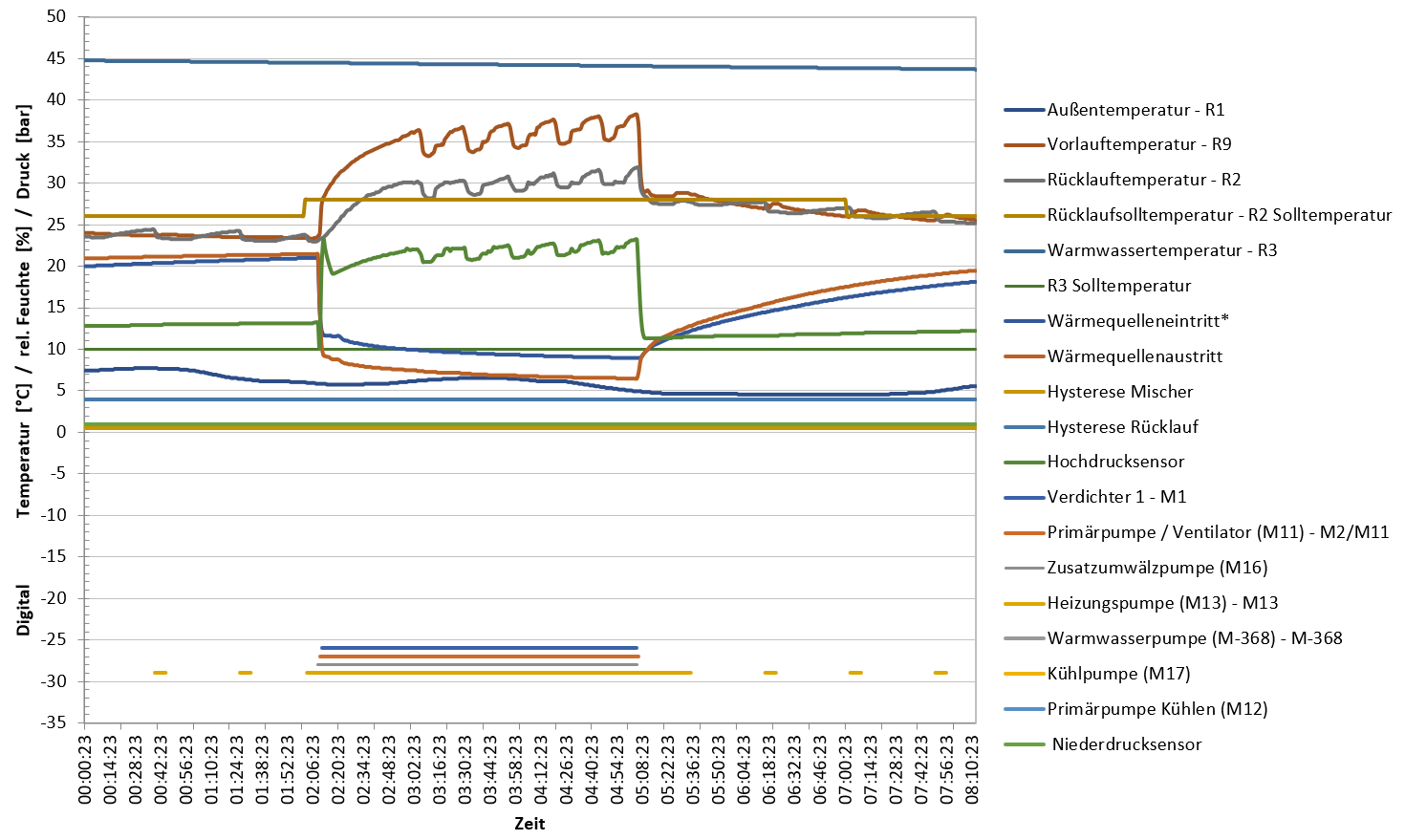

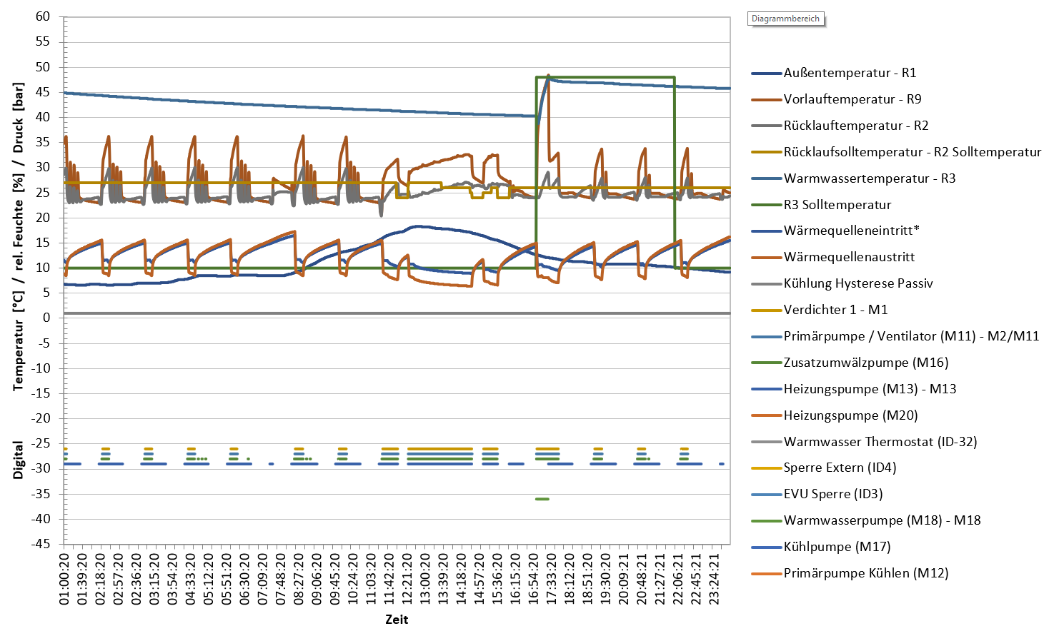

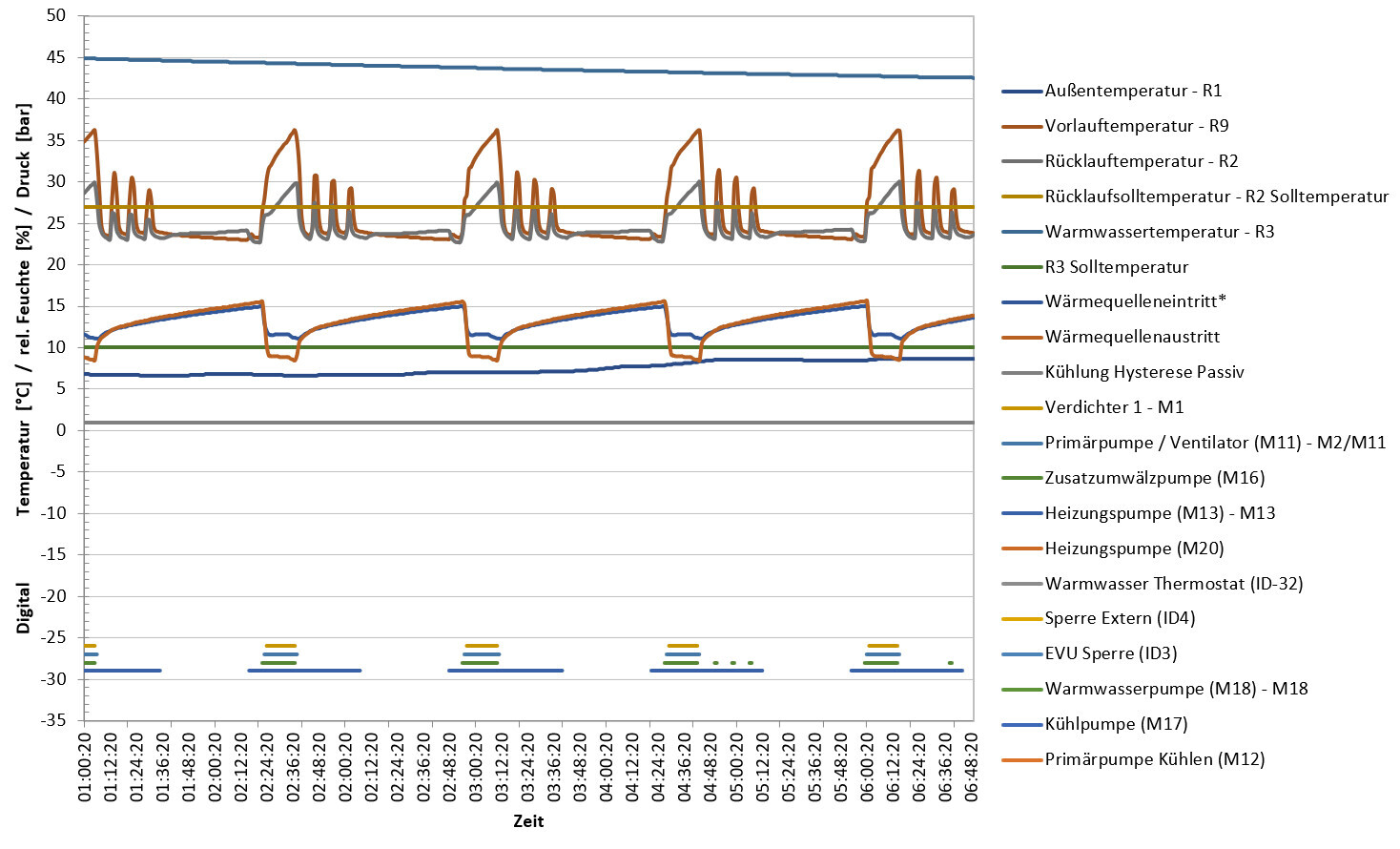

[*]After a one-week vacation where I completely switched off the heating, I started again from scratch. I tried to proceed as recommended by turning the warmest room (bathroom) fully on (about 2.2 l/min) and then increasing the temperature until satisfied. But of course, the heating is totally oversized for that?! The heating started 20 times for 10-15 minutes each, the supply was then nicely at 30-33 degrees, but the temperature did not seem to come from the heat pump. I’m attaching a picture of the behavior.
[*]Because I suspected that this was due to insufficient flow and I did not dare to change the heating pump setting, I slowly turned other rooms slightly up.

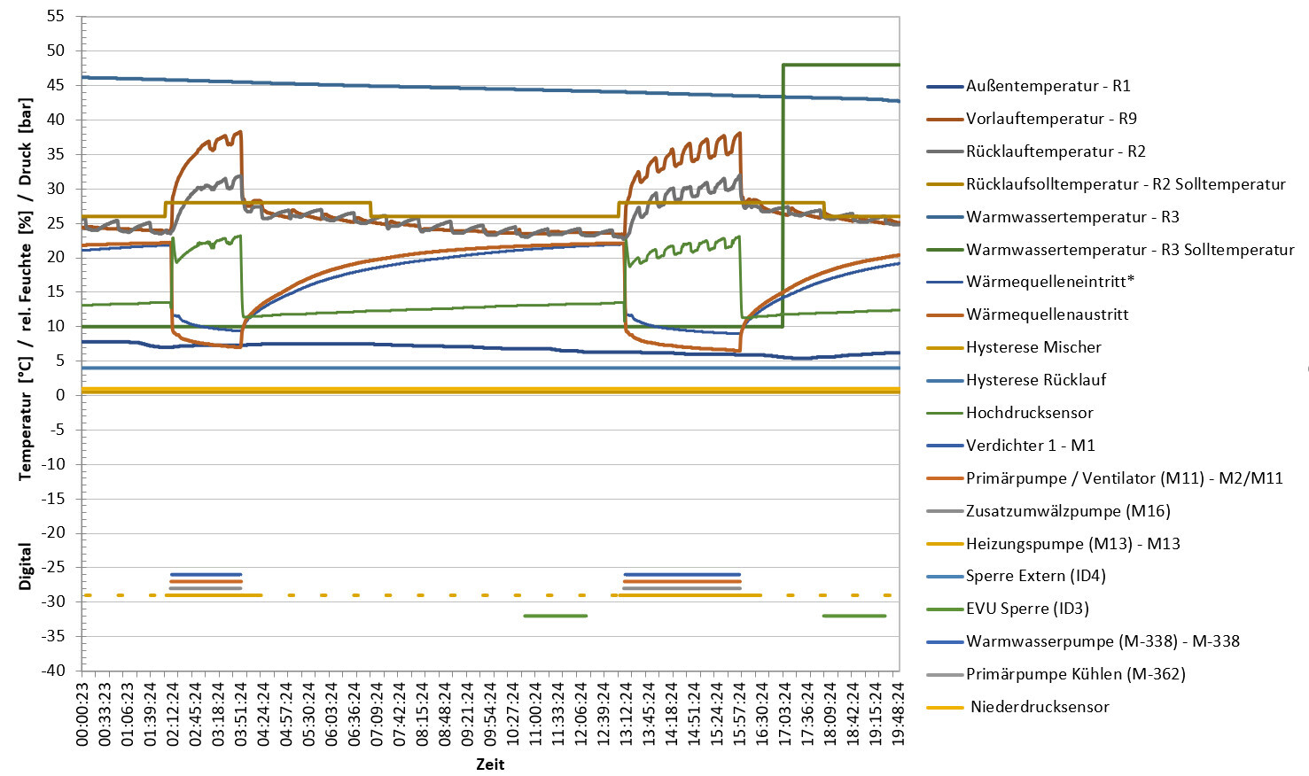

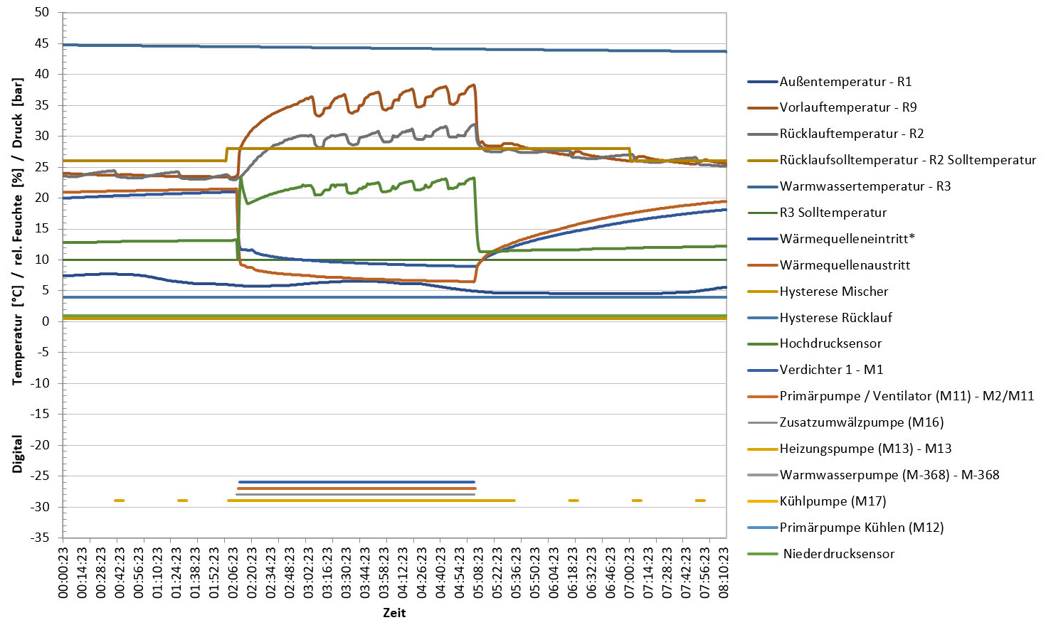

[*]I also started to increase the fixed temperature to 27 or 28 degrees and ensured via hysteresis that the pump ran less often but longer. Now I am quite satisfied with the temperatures in the house. The values still look strange to me, though. I believe I now have many rooms/area/buffer mass that only have so little flow that the whole "cooled mass" continuously circulates and always reaches the return flow again. It doesn’t bother me per se, but I don’t want to provoke any damage. I am attaching a picture as well.
[*]Finally, I ensured via lowering the temperature at night and in the morning that the heating starts at favorable times. Currently 2 starts of about 2-3 hours each are enough.
