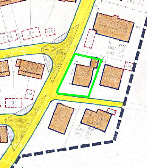

Development plan/restrictions
      Size of the plot: 787m²
      [*]Slope: no, only slight gradient
      [*]Floor area ratio: 0.2
      [*]Floor space index: 0.3
      [*]Building window, building line and boundary: see development plan, the north side of the building is the building line, otherwise approximately twice as much may still be built
      [LIST]
      [*]Development plan (1st amendment) (colored)
      [*]Development plan (2nd amendment) (changes not relevant, but somewhat easier to read, black and white)
      [*]Excerpt from development plan (oriented to north):
35273[/ATTACH]

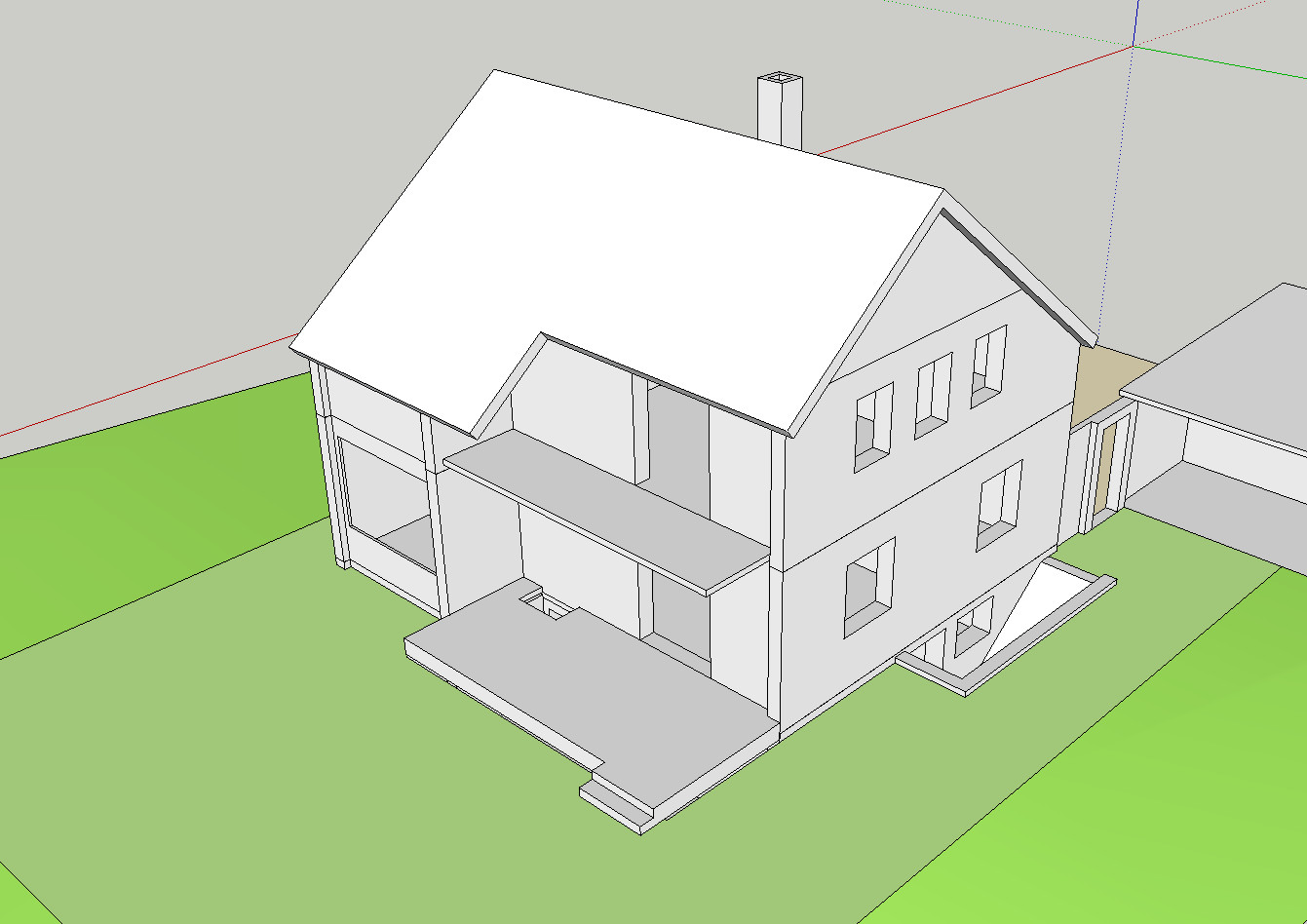

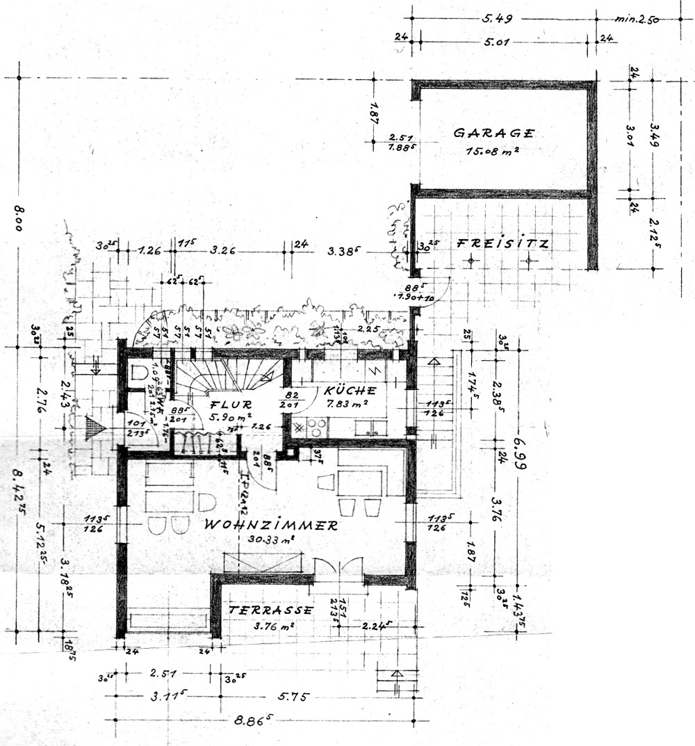

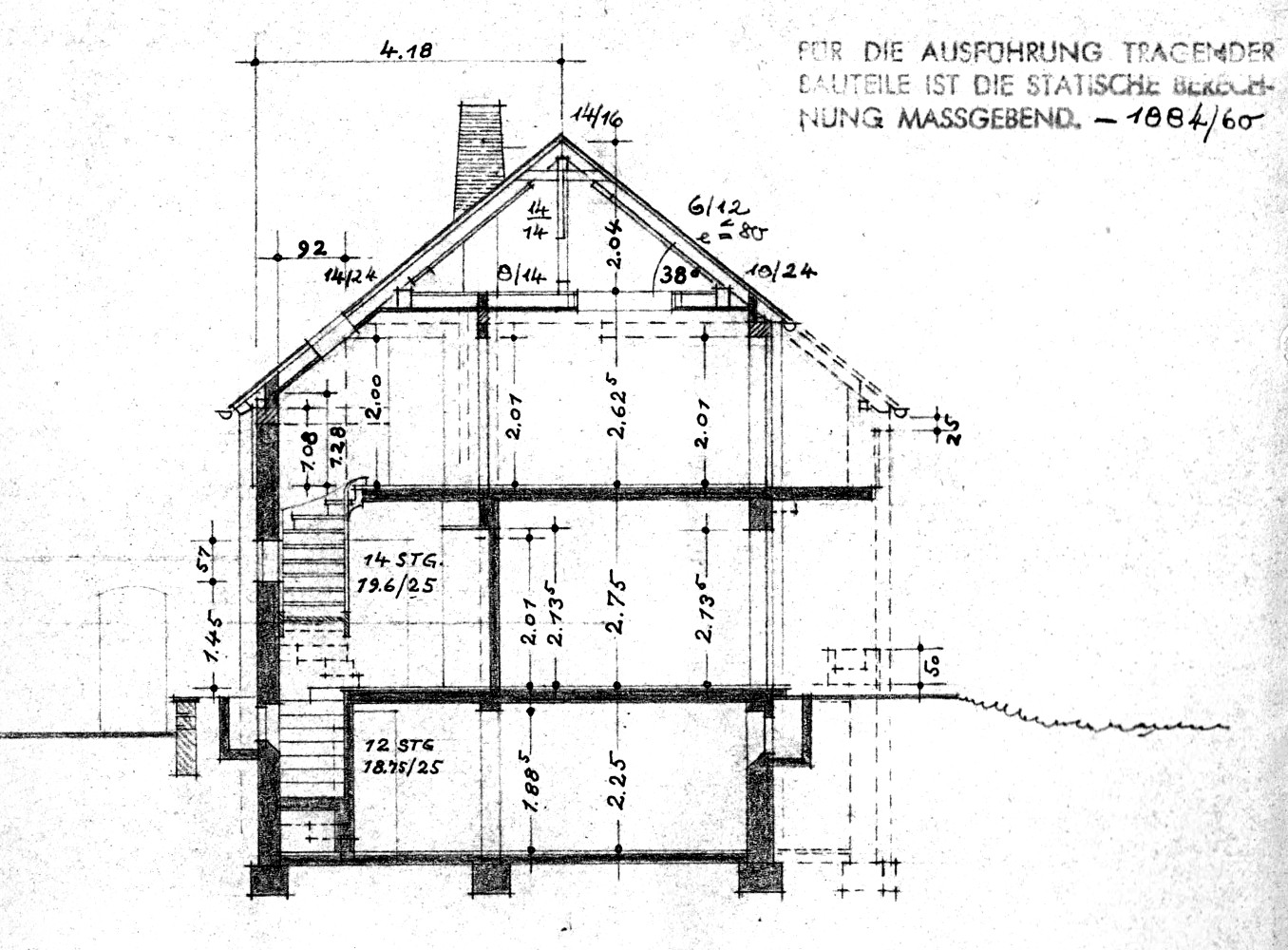

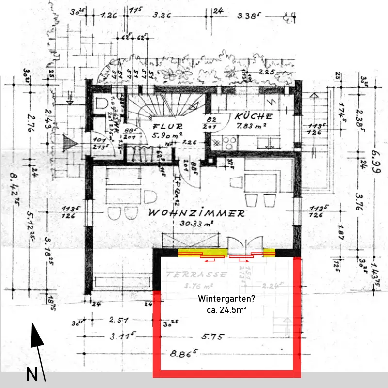

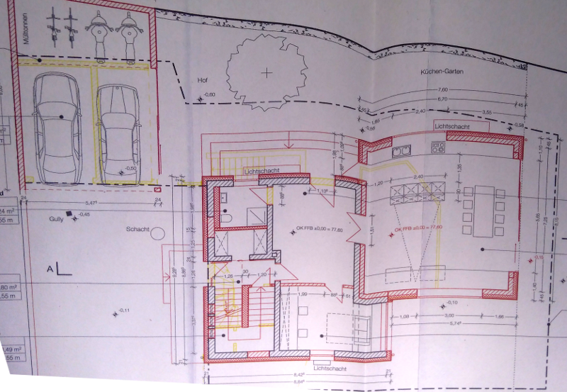

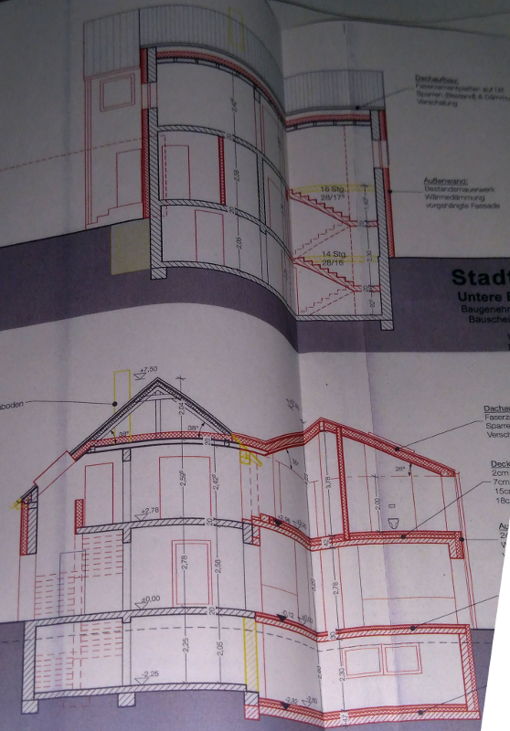

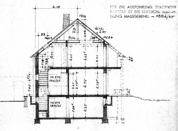

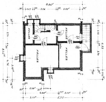

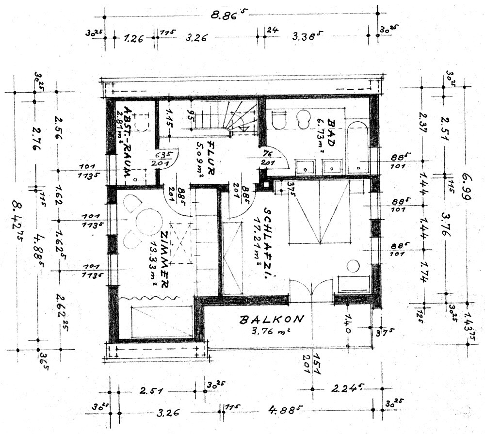

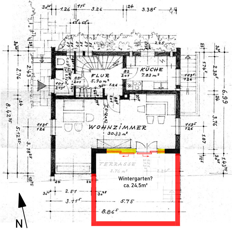

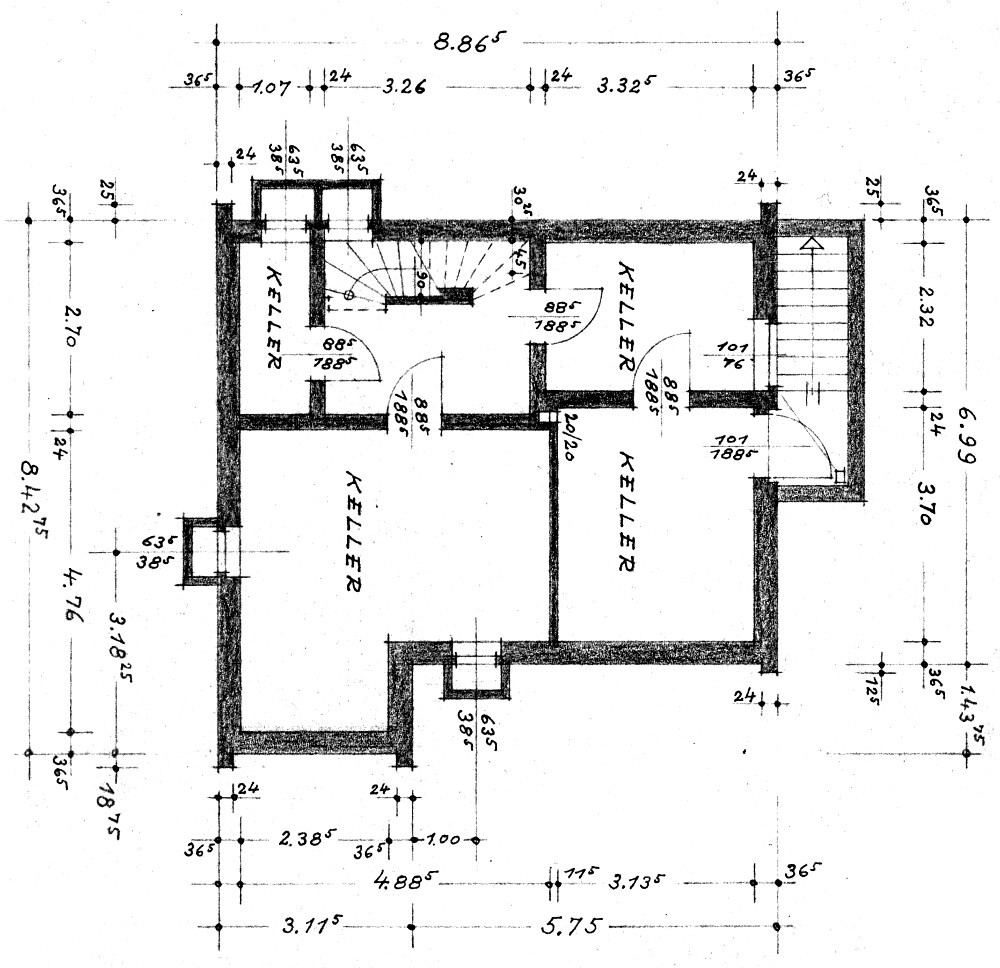

Floor plans (original condition, without conservatory):
Order: basement, ground floor, upper floor, cross section

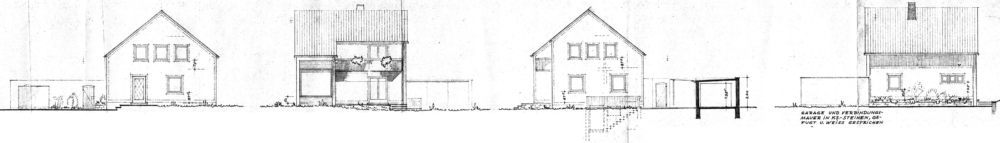

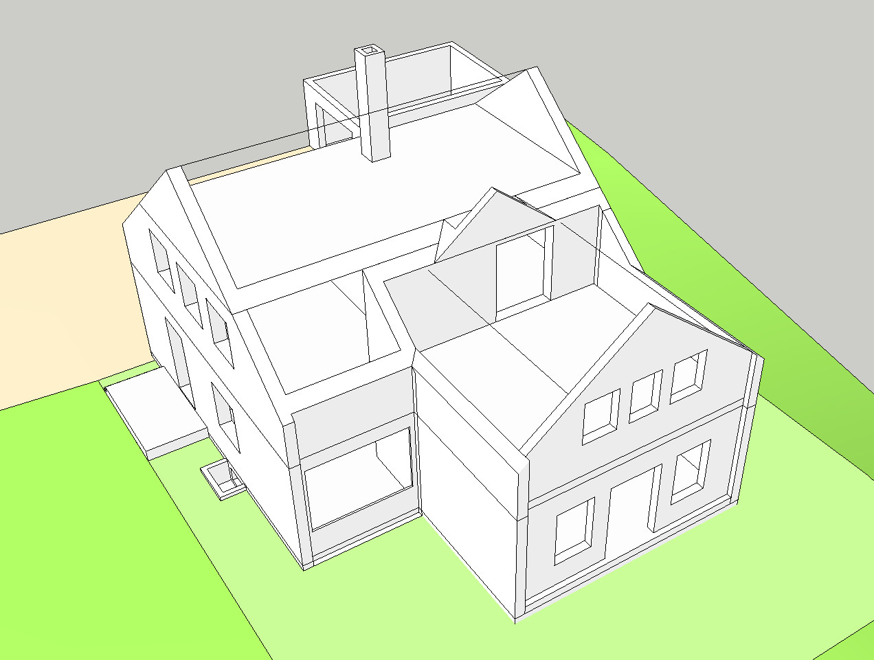

Exterior views:
3D drawing with comparison original (with old terrace) and conservatory extension (including new terrace):
(dark green lawn = building window)

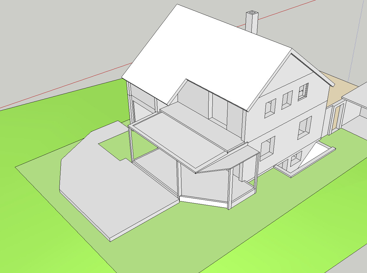

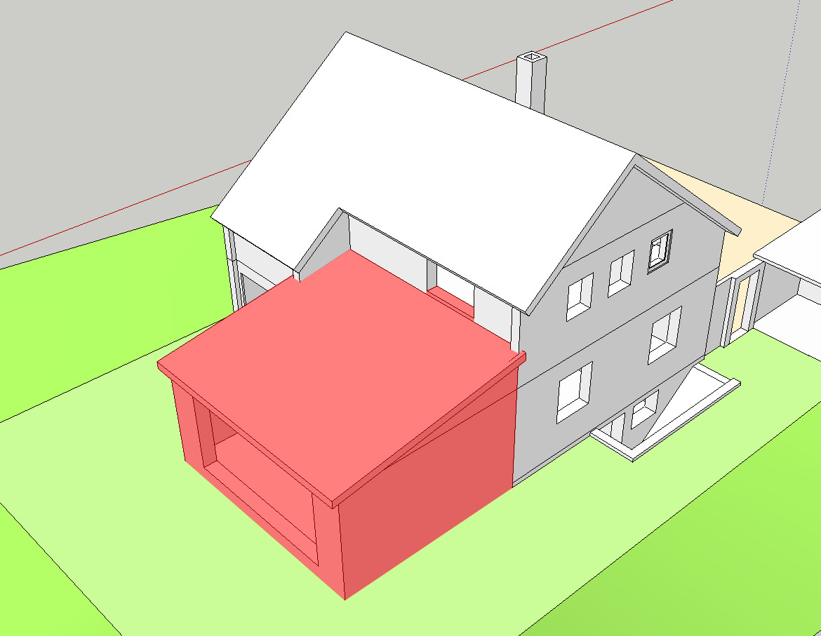

As mentioned at the beginning, we are planning in the mid-term to replace the conservatory with a better solution.
The goal is to have a room that serves a similar function. That means a sunny room with a nice view of the garden, for example through large lift-and-slide doors. However, it should also meet the requirements of a living space (i.e. proper thermal insulation, solid walls instead of aluminum profiles, proper heating, tight roof).
However, we are still unsure about some fundamental issues:
    [*]Separate room or large opening to the living room (and possibly partition there – i.e. “rotation of the living room”)
    [*]What happens with the bedroom (balcony not necessary, so far no sloped ceiling, will a dead space or a walk-through room be created)
    [*]Which roof shape (extend existing, new roof with flatter pitch in front, side wing with its own ridge direction, but no flat roof or cube)

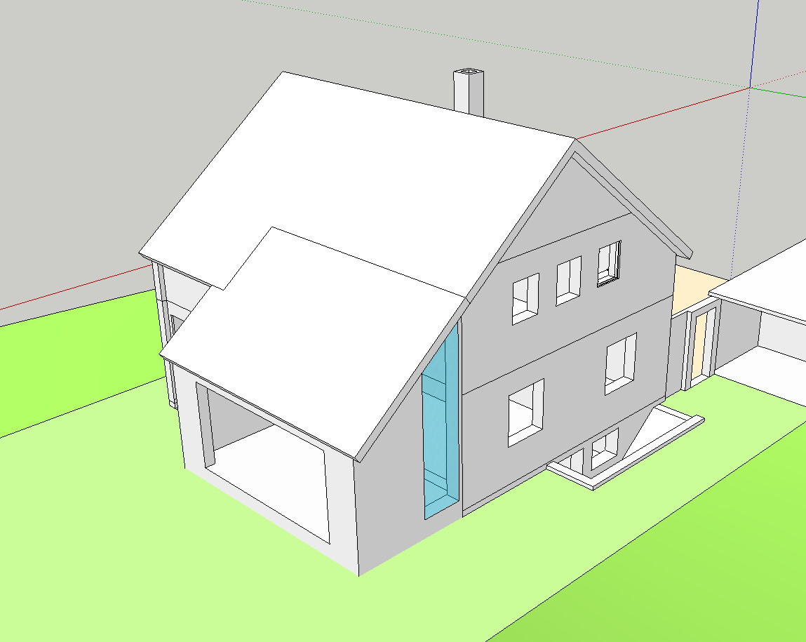

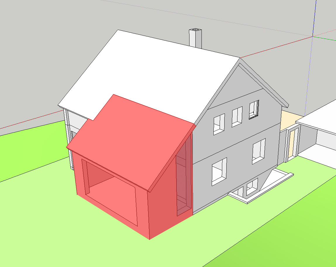

Option 1:
    [*]“Separate” extension with its own ridge
    [*]Advantage: depth variable according to space requirements, as long as proportions to main house are okay
    [*]Disadvantage: bedroom becomes a walk-through room with little light and what purpose does the additional room on the upper floor serve (observe 2m line)?
Option 2:
    [*]Own roof with flatter angle
    [*]Advantage: size remains variable, light in bedroom (balcony door becomes window)
    [*]Disadvantage: appearance and proportions, roof too flat
(Image in next post)

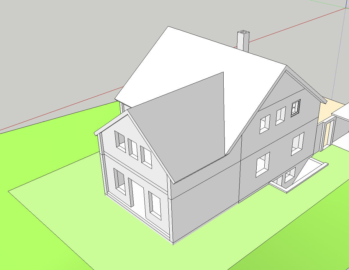

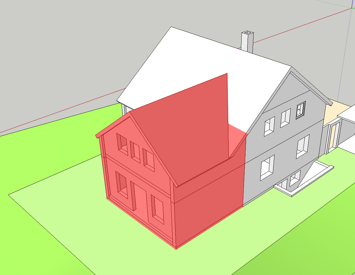

Option 3:
    [*]Extension of existing roof,
    [*]Advantage: best optical solution, subtle modern elements possible (e.g. large window), thus light in bedroom as balcony door remains as floor-to-ceiling window with a parapet
    [*]Disadvantage: bedroom window (formerly balcony door) in room, room depth exactly defined by intersection with roof.

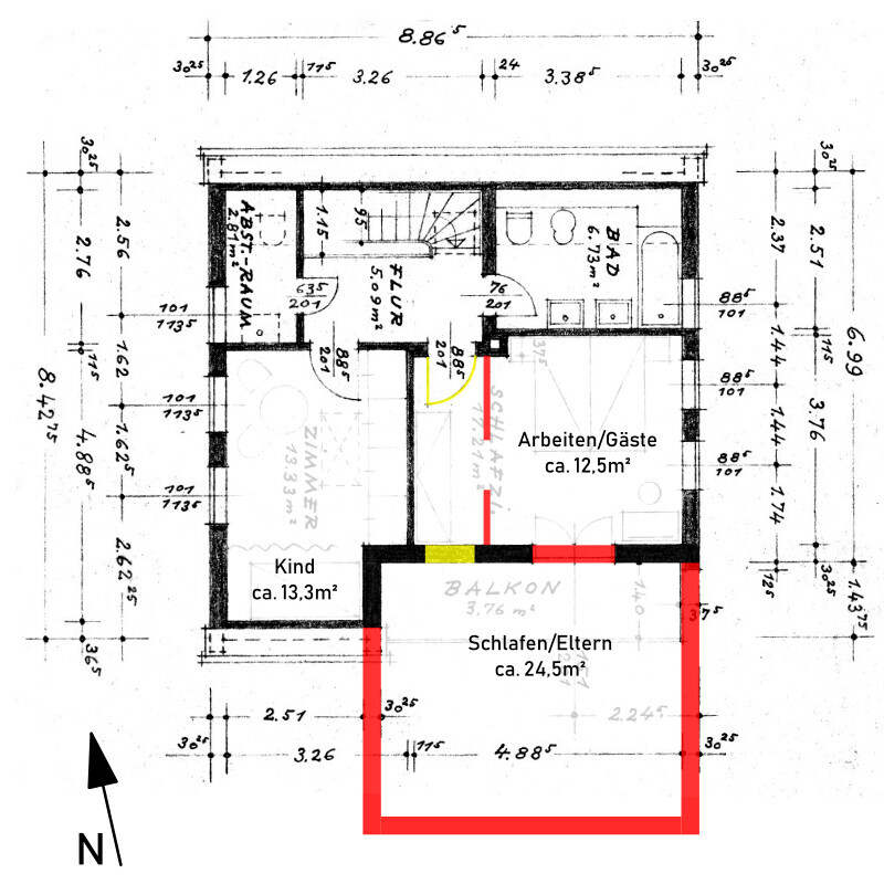

Current use:
The bedroom on the upper floor is used exactly for this purpose. That means it does not need to be larger since we spend most of the time elsewhere. A walk-in closet or a laundry temple are also unnecessary.
The bathroom is sufficiently large, after remodeling a shower + bathtub + WC + washbasin will fit there without problems. The extra shower will be removed, that will become a storage room – possibly the WC will be moved from the bathroom to there).
The other room is an office and guest room. It seems that having children will still work out, so it could soon become a children’s room. Guests can easily sleep in the living room and home office work could also be done elsewhere (it is only mobile working as needed and not external sales).
It would of course be interesting what fundamental possibilities an extension offers to get more out of the ground floor. I would rather not move the kitchen, it currently has brand new electrical, water and sewage lines and just needs renovating and new furnishing. The size is sufficient and we gladly forego an open kitchen.

Addendum: Pictures of the other variants (due to image limits)
Variante 2:
Variante 3:

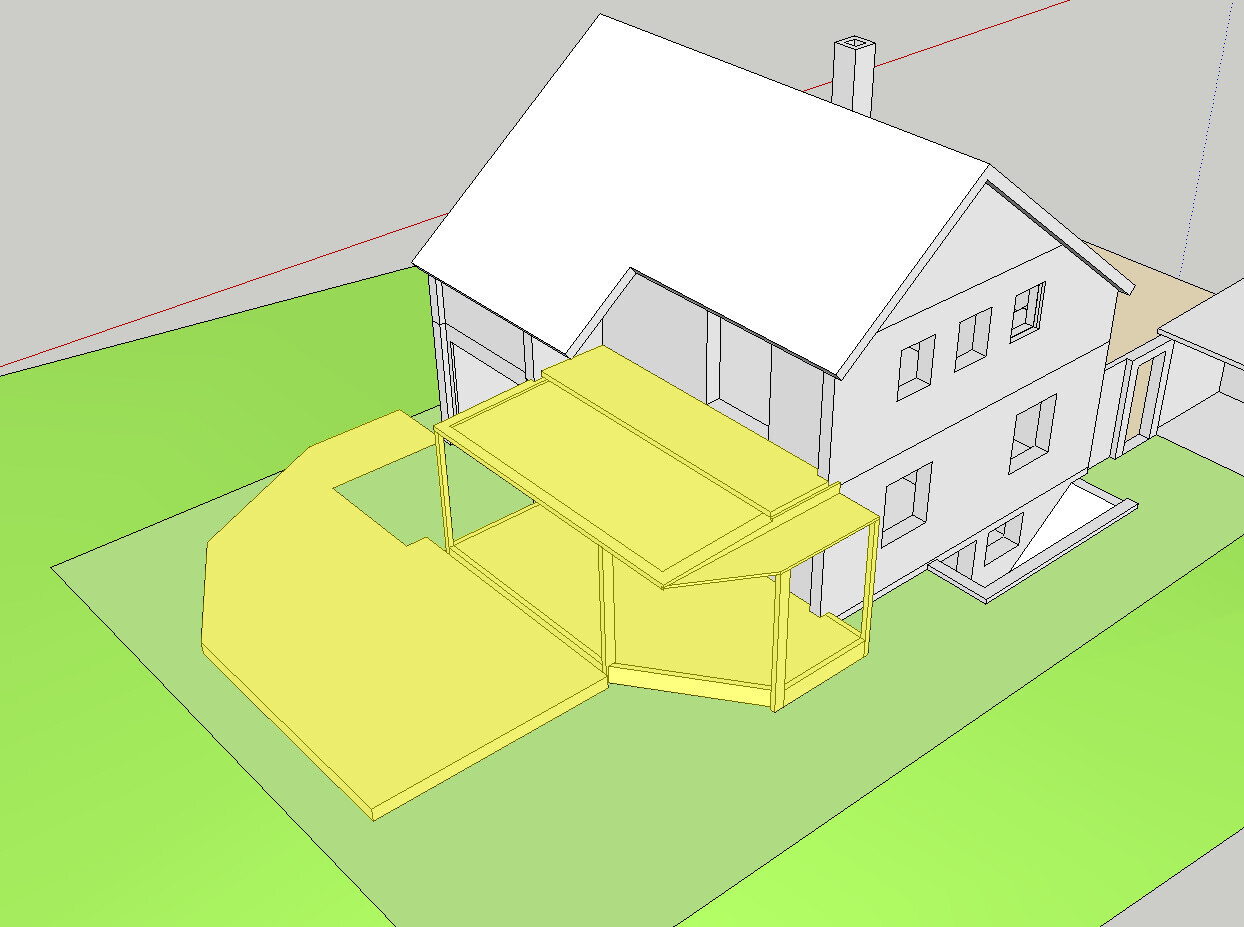

I want to revive this thread and submit the colored pictures.
First the existing situation: Here the winter garden and the balcony slab of the upper floor as well as the current terrace are marked in yellow. None of this is in good condition, it darkens the living room and should therefore be replaced.
The idea is to build a fully basement extension at the same location. The question is whether it should be one or two stories and in which design.
The first option would be a "normal" extension, which requires a bigger intervention in the roof:
The second option is only one story, but with more room height. For this, the balcony door on the upper floor becomes a window:
The third option is a continuation of the roof surface and a gallery window from the bedroom into the new room.
The second and third options are limited in size, as they depend on other existing objects (roof, window). The first option offers the most flexibility. Below are a few floor plan ideas for the 1st option.
Since there is now a child on the way, the previous guest and study room will be lost. At least for the home office, there will initially be a solution in the storage room on the upper floor west. In the long term, however, a guest and study room would be better again, especially also as a reserve in case a second child should come.
The idea would be to enlarge the living room on the ground floor by the extension. Currently, the western area is the living corner and the dining area is on the east side. By enlarging the door to the current winter garden, the eastern side could benefit from more light. However, I am unsure about the design and arrangement of the furniture. Even now it was not easy to position the couch sensibly in relation to the TV.
Alternatively, the opening could be even larger and an independent room could be created on the east side, and the western area could be separated by a wall at the level of the beam.
On the upper floor, the question arises about the long-term use. If the new room were only attached to the current bedroom, it would become a passage room. This would make use by guests or a child impossible. Therefore, the idea is to separate part as a hallway. The question is whether this can be implemented sensibly with the ceiling height due to the roof pitch on the side of the extension.

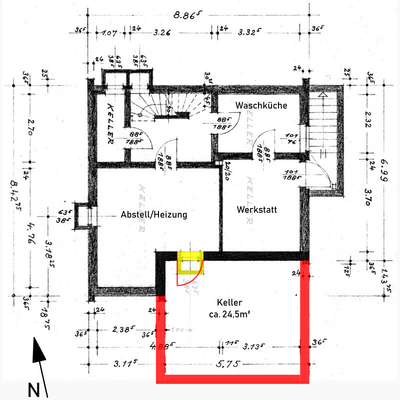

Nothing unusual happens in the basement. For accessibility of the drainage (which must be renewed anyway and is currently inaccessible under the winter garden), we are planning the extension with a basement as well.
Are there any suggestions and criticism of the first ideas? Alternatively, instead of an extension to the south, an extension to the east side is also possible. The building window is visible in the 3D views as a different shade of green. Where can I get the exact measurements? In the development plan from the 60s it is only roughly recognizable.

As a supplement:
The previous owners had also planned an extension. However, a few dimensions larger and with extensive remodeling of the existing structure. I found the approved plan in the building file, but in the end, they preferred to build completely new:
Tobibi
2019-12-03 12:13:12
  • #6
Option 2 appeals to me least visually. Approval feasibility clarified?
