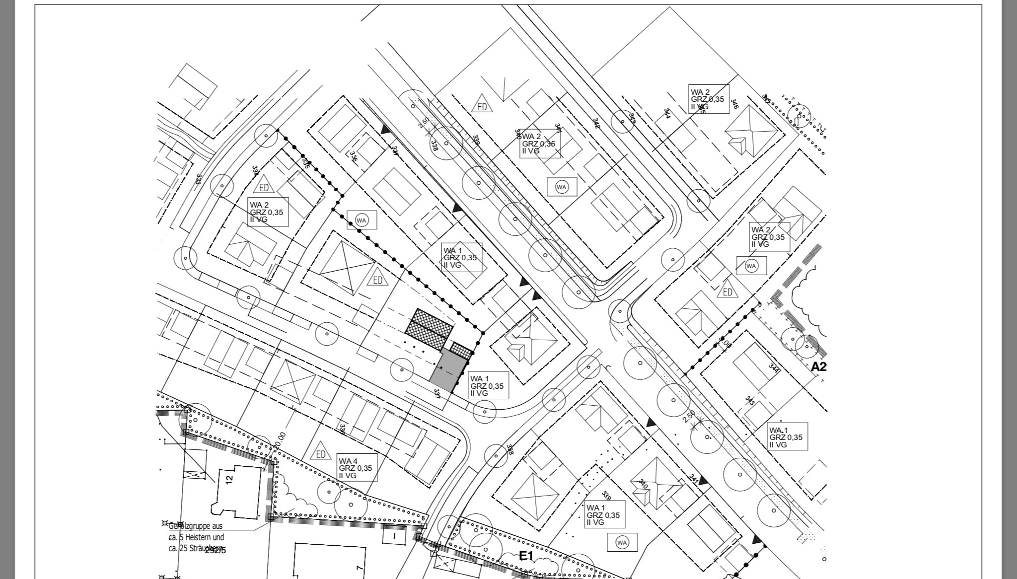

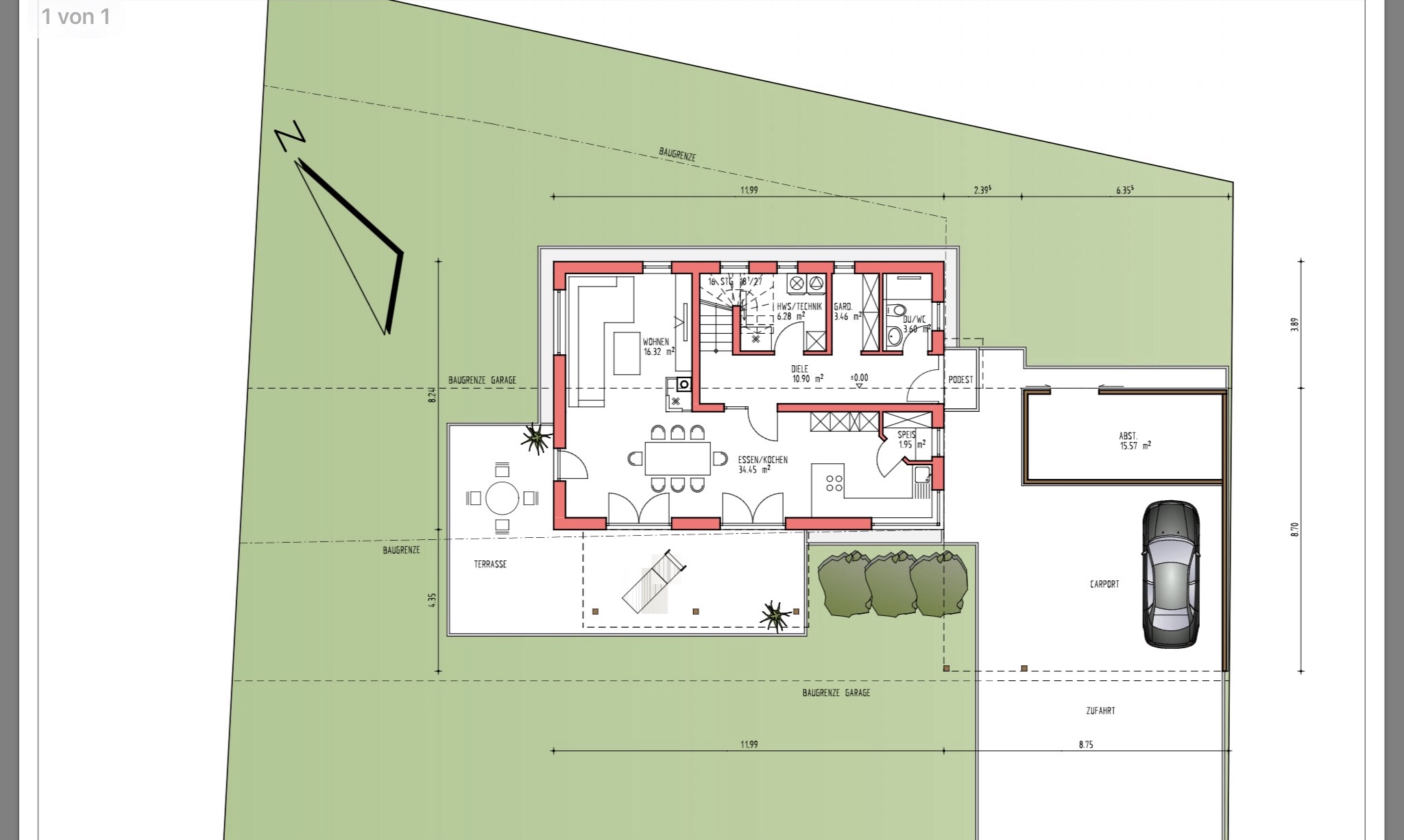

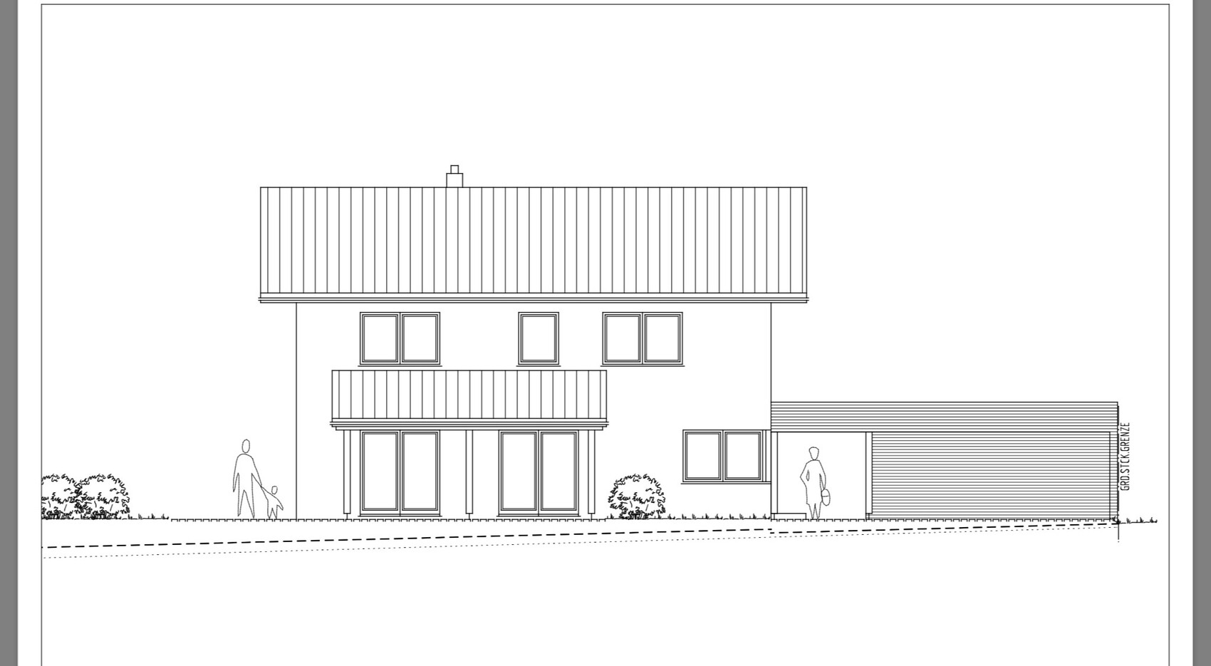

Hello everyone,
after a long browse through the posts, I would like to put our draft of a planner for a single-family house with 150 sqm living space up for discussion. We like it quite well overall, but I am still curious about opinions. Maybe you could take a look.
Development plan/restrictions
Plot size: 711 sqm
Slope: no
Floor area ratio: 0.35
Floor space index:
Building window, building line and boundary: yes, see picture
Number of parking spaces: 1 per residential unit
Number of floors: 2
Roof shape: gable, hip, tent, shed roof
Style: modern
Orientation: south

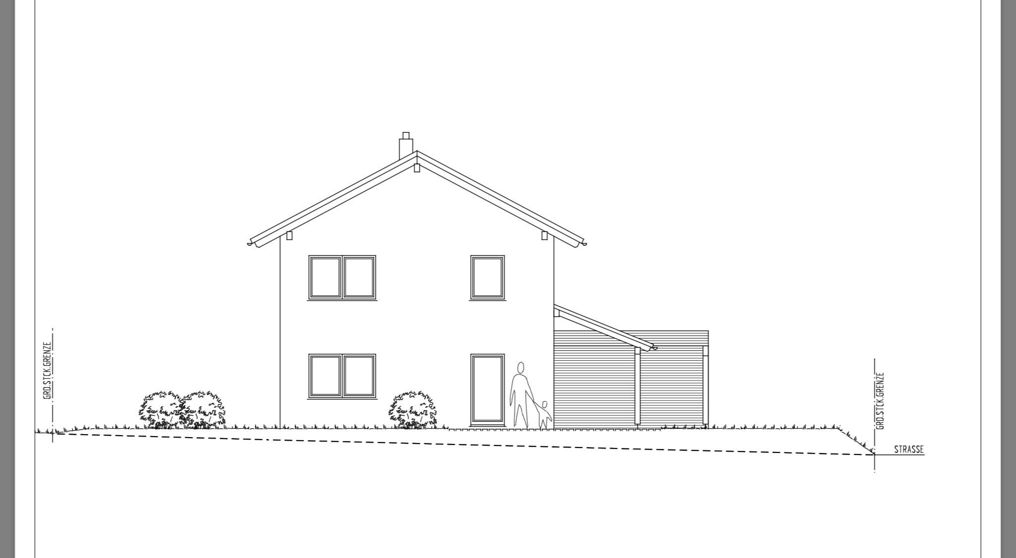

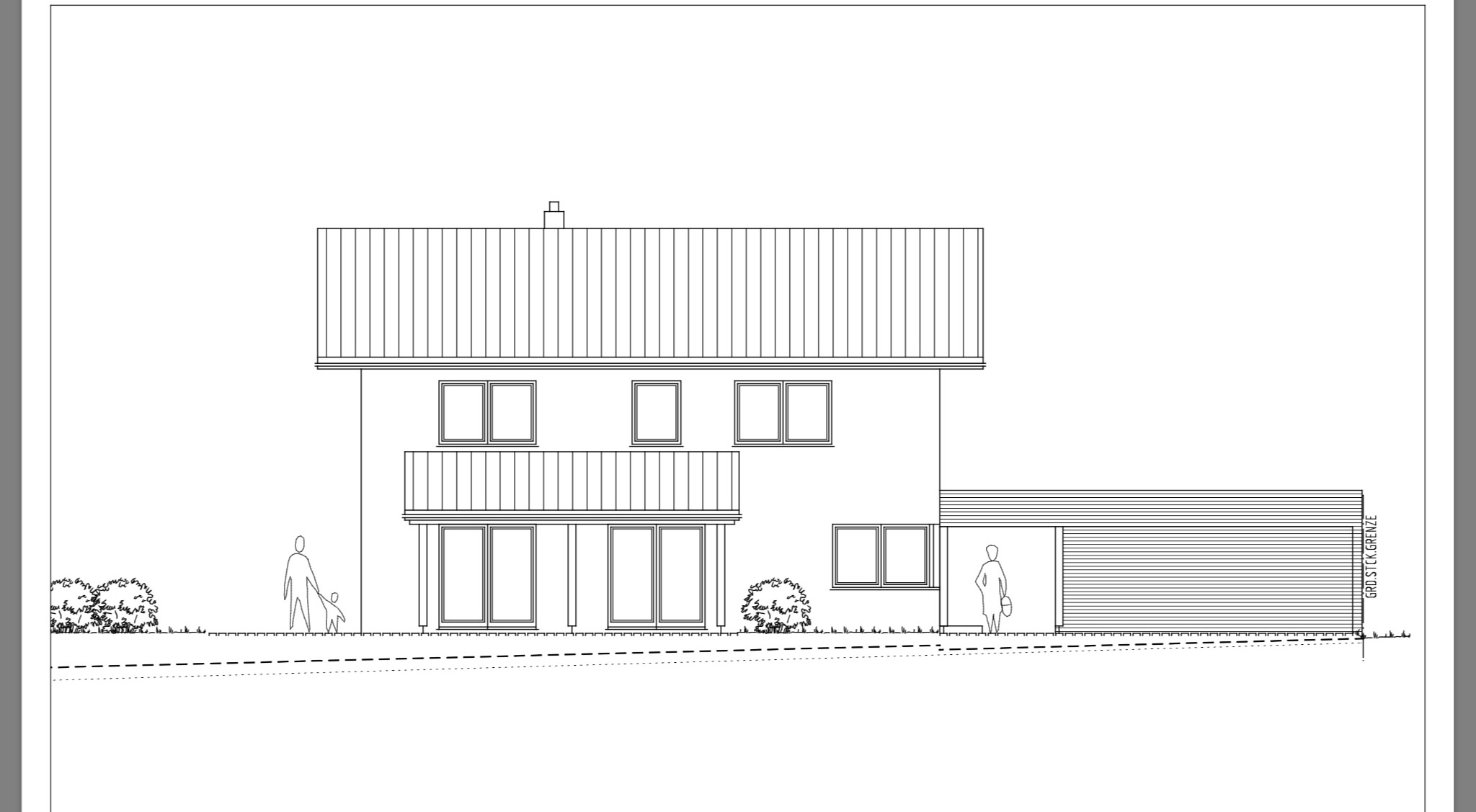

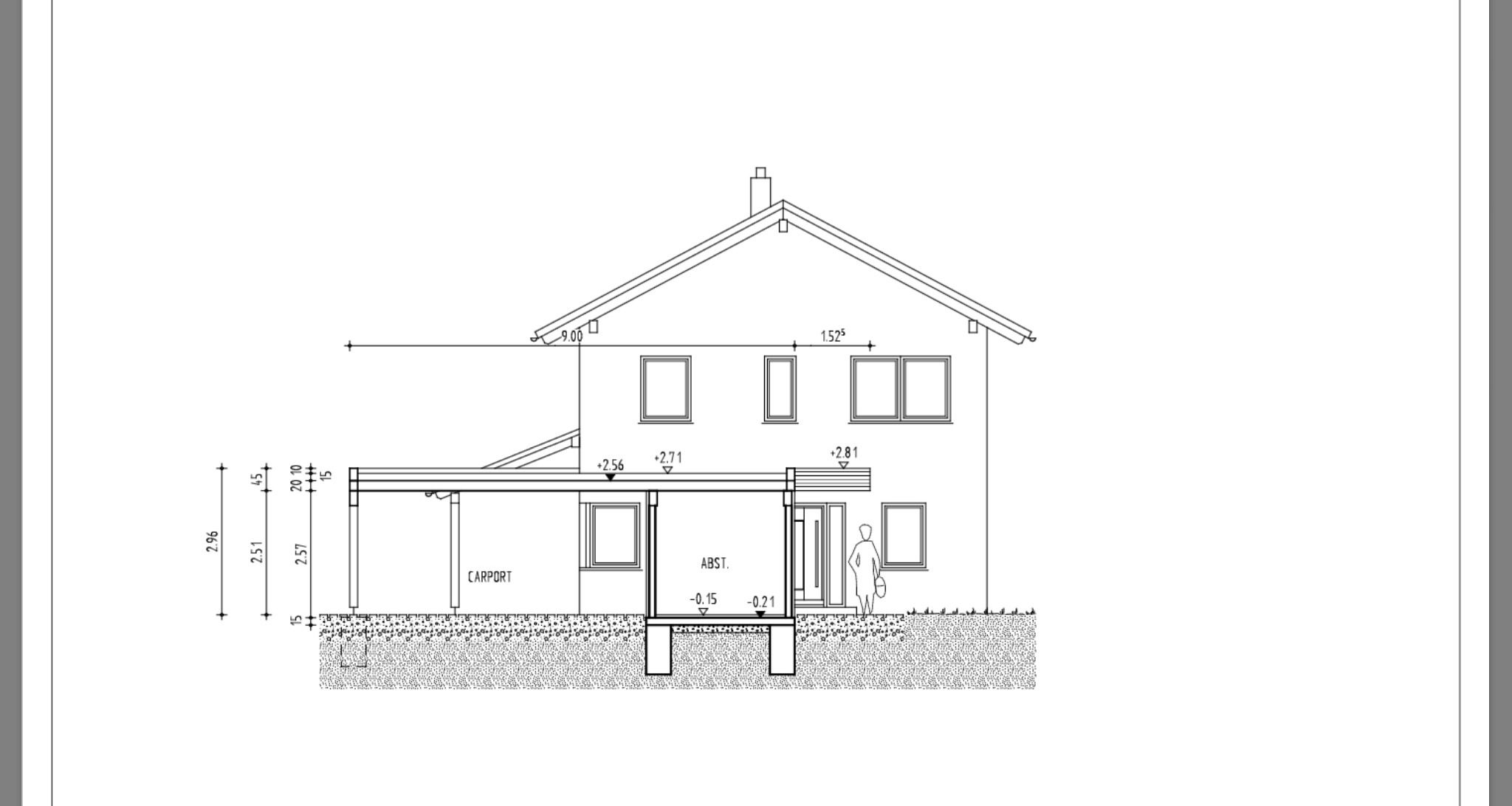

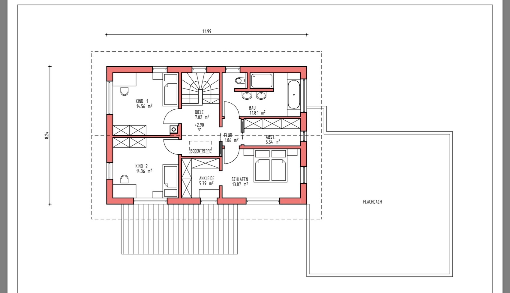

House design
Who planned it: planner (architect) of a construction company
What do you particularly like? Why? open living/dining area, kitchen with corner window was realized, bathroom upstairs with T-solution
What do you not like? Why? split dressing room ("dressing" + "storage"), possibly position of the pantry, placement of the house on the plot in general (but this will be due to the building window, lots of space loss in the north)
Price estimate according to architect/planner: not yet available
Personal price limit for the house, including equipment: €350,000
Preferred heating technology: air-to-water heat pump
If you had to give up, on which details/extensions
-can you do without: second room upstairs the same size as the children’s room
-can you not do without: ?
This is a first preliminary draft from our planner. Unfortunately without measurements, those will only be available once we approve a draft.
One of the hardest things for me is the overall positioning of the house, the building window is unfortunately not optimal. The access road runs along the south. And to make optimal use of the plot (building window), the house would basically have to be placed at the northern building boundary, but then it would not stand parallel to the road.
I would be happy about opinions and ideas!
