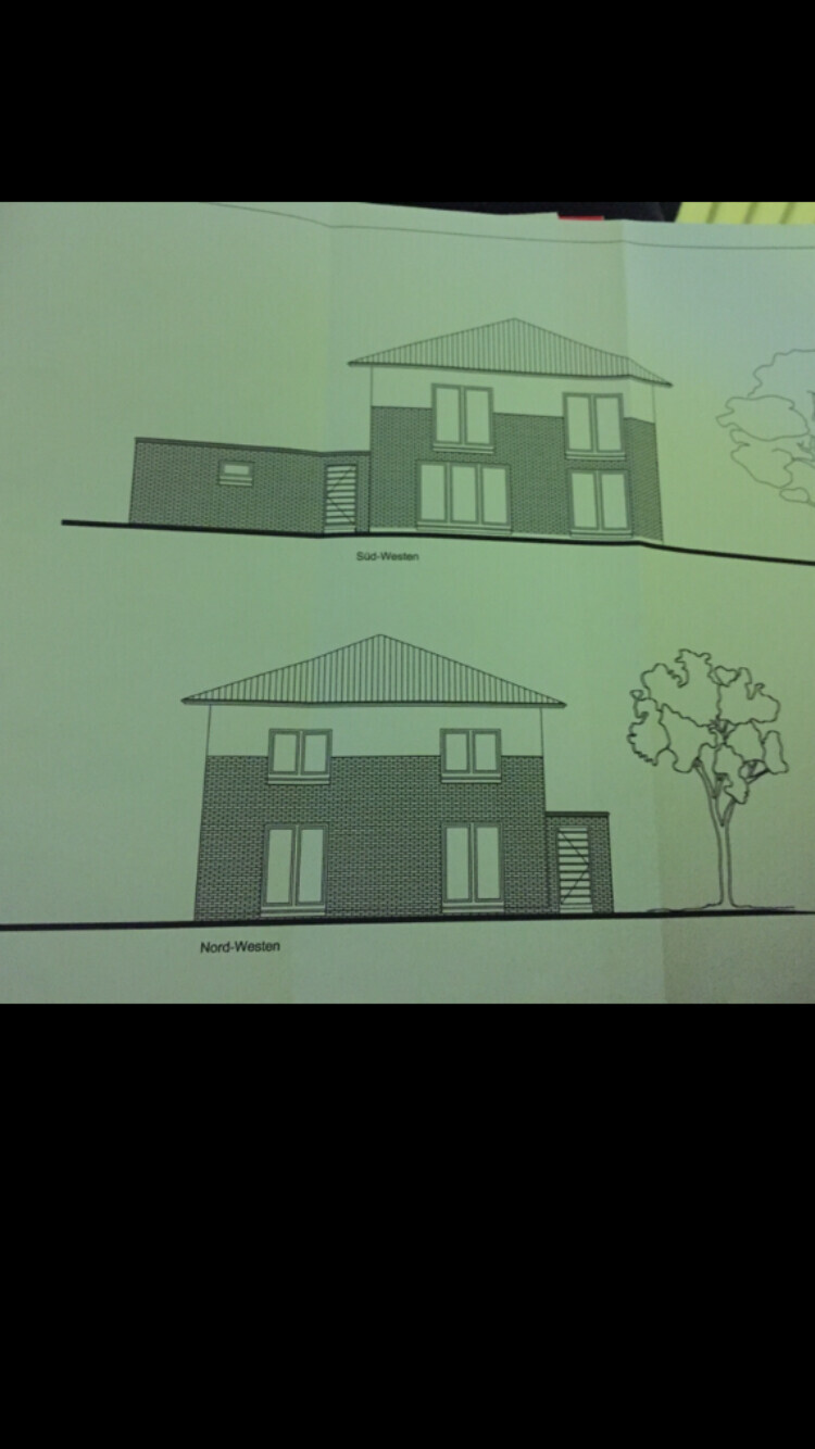

Window installation WDVS - When can the window fitter take measurements?

  • #1
Doesn't it also depend on where the windows are located? That is, in which plane (masonry, facing brick, [WDVS]) ...
Basel
2018-01-04 08:52:43
  • #2
It should look something like this.
bau.mal
2018-01-04 09:17:07
  • #3
Windows are basically placed on load-bearing blocks to transfer their own weight into the building structure.
Bieber0815
2018-01-04 09:27:40
  • #4
What do you mean by building structure? Traditionally, the installation is in the load-bearing wall, but windows can also be installed in the insulation layer; this is also done. Both variants have advantages and disadvantages.
bau.mal
2018-01-04 10:49:25
  • #5
Even if a window is to be installed in the insulation layer, it is sufficient to align the back of the frame flush with the outer edge of the masonry, since the optimal installation is located in the first third - viewed from the inside.
Basel
2018-01-04 11:17:40
  • #6
Not as easy as I had hoped. The windows are not attached to the insulation but rather fixed to the masonry with special brackets, right?
