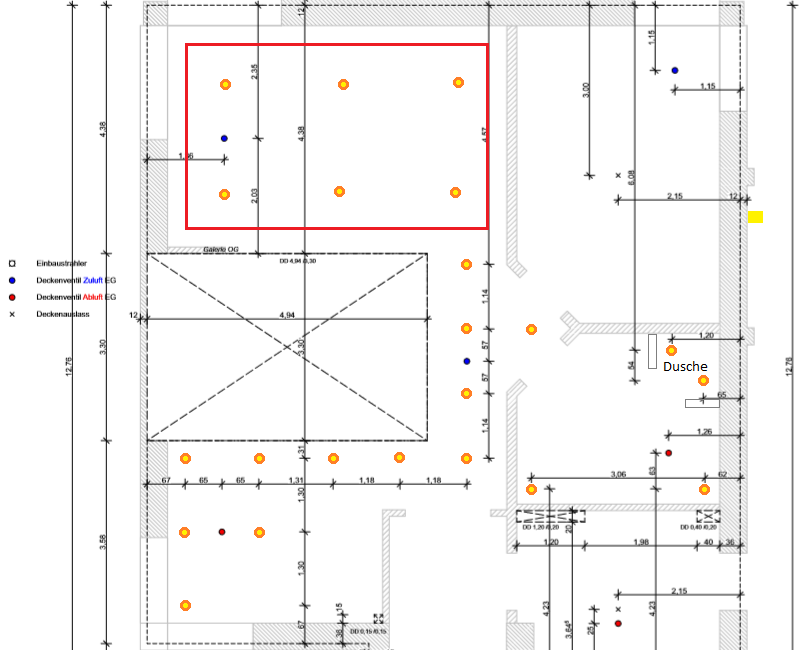

Floor plan follows...
Judyyy
2018-02-03 16:07:16
  • #2
We would like to dismantle the area marked in red and also equip it with lamps.
Best regards, Judyyy

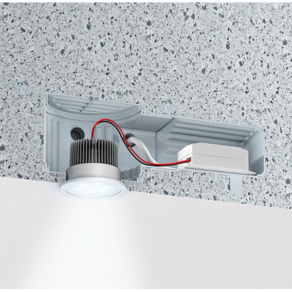

Mycraft
2018-02-03 17:11:54
  • #3
Take the 100 ones with tunnel, they are usually enough. Installed they look like this:
Judyyy
2018-02-03 20:20:54
  • #4
Hello, thank you very much for your advice.
And the tunnel for low-voltage lamps with transformer or high-voltage with external LED driver?
Best regards
Judyyy
Mycraft
2018-02-03 22:31:22
  • #5
Which lamps you use ultimately doesn't matter...yes, the tunnel is for the transformers etc.
