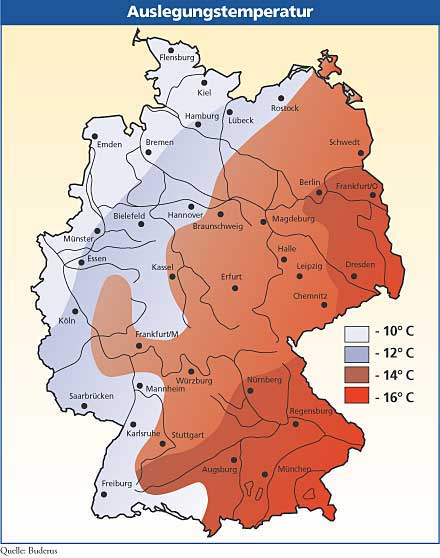

Hello everyone,
I had not found any calculation whether better insulated bricks are really worthwhile, so I calculated it myself at Ubakus:
House data: floor area 10m x 9.5m; room height 2.5m; location Munich (cold region), wall area: 221 m²
Energy loss of the wall with the following U-values:
U=0.23 = 4135 W/a
U=0.21 = 3809 W/a
U=0.18 = 3320 W/a
U=0.17 = 3163 W/a
Assuming a heat pump with an annual performance factor = 4, electricity price = €0.27, the following energy cost differences result compared to the worst bricks (0.23):
0.23 = -
0.21 = €22 /a; €880 / 40 years
0.18 = €55 /a; €2200 / 40 years
0.17 = €65 /a; €2620 / 40 years
Example bricks: Poroton Wienerberger List prices36.5
Required bricks: 3500 pieces
0.23 = €5.6 per piece
0.21 = €6 per piece; total surcharge: €2100
0.18 = €6.3 per piece; total surcharge: €2450
0.17 = €6.7 per piece; total surcharge: €3850
So somehow I don’t see a significant advantage in using better bricks. Especially if you live in a warmer region.
