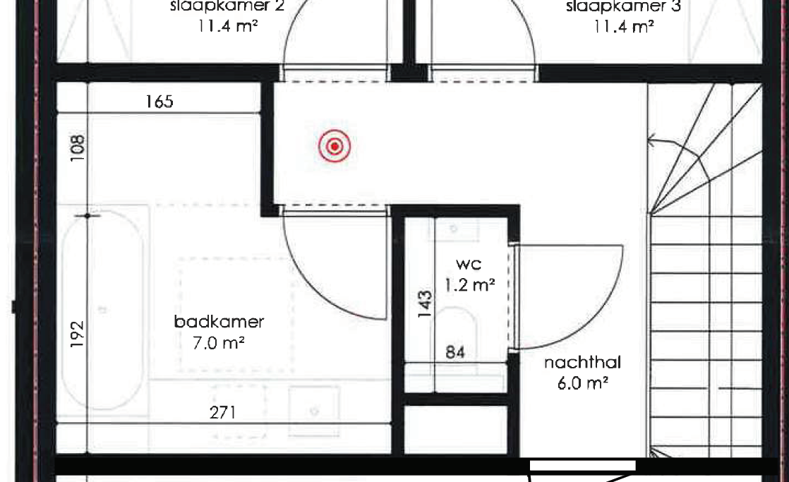

Hello,
I am currently planning the bathroom (well, around here it's called "badkamer"). Unfortunately, the bathroom is awkwardly shaped. There is a niche measuring 160 cm in length and about 100 cm in width. Would it be possible to install a walk-in shower there without flooding the bathroom during use? 160 cm in length seems narrow to me; there would only be a glass wall of 110 cm. The entrance to the shower would be on the long side.
Or is there another idea for this bathroom? It should have a shower and one or two sinks. Also a radiator and possibly a cabinet for storage.

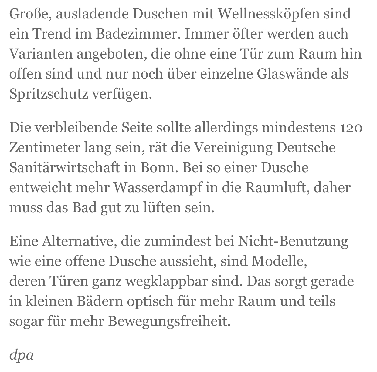

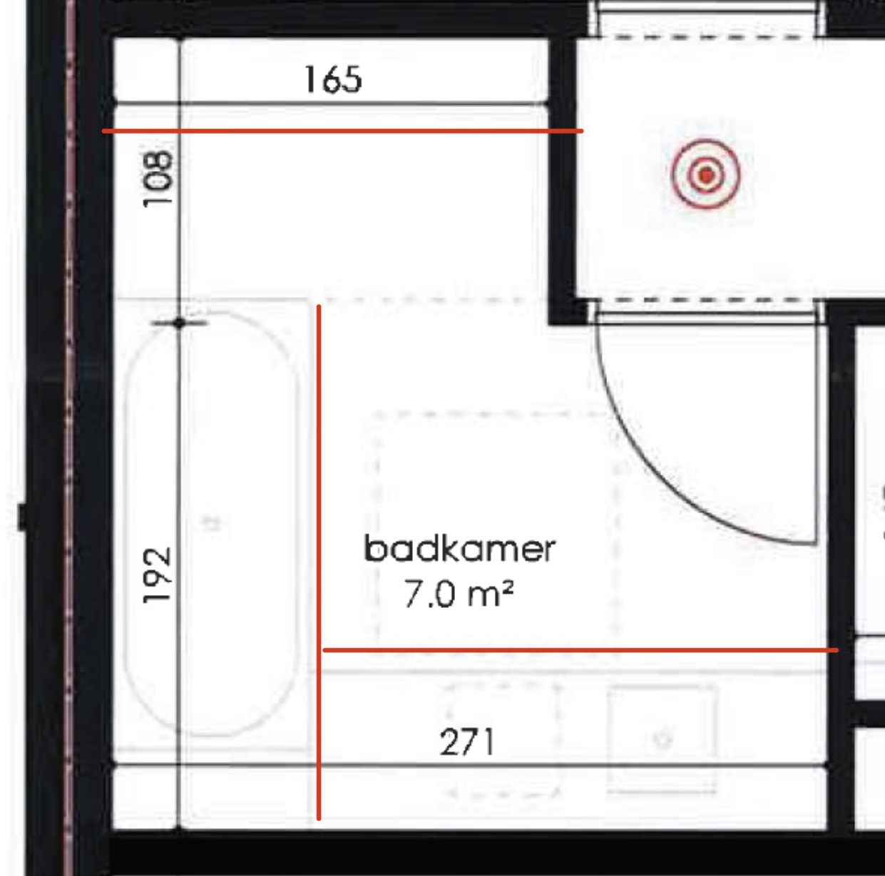

Why don't you put the washbasins up in the niche, the bathtub (1.70m length) directly opposite the entrance door, and to the left of the bathtub the partition wall for the walk-in shower. 1.50m is more than enough for that.
Bertram100
2020-01-02 23:46:06
  • #3
oh, you even fit a bathtub and a shower! How do you get to 150cm?
goalkeeper
2020-01-02 23:48:19
  • #4
Something like that.
We are currently building ourselves and even have only 1.40m - according to the bathroom planner, that's completely sufficient. But keep in mind that a few centimeters are still taken up by the pre-wall.
Bertram100
2020-01-02 23:52:26
  • #5
That you can also enter a shower from the short side, I hadn’t even thought of that yet. Actually, everything fits with your idea. So 150cm is enough for the shower partition? That’s good to know. Thank you for your idea. I hadn’t considered anything in this direction before.
