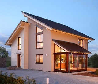

Hello community
According to development plan B of our property, it is only allowed to build a hipped roof or a gable roof with a 25 - 45 degree pitch.
Eaves height 4.70 m
We would like something more modern that stands out slightly from the crowd.
Does something like the one in the photo below definitely belong to a gable roof or a shed roof??
Thanks

My answer is not intended as a definition itself, but rather an attempt to bend the [B-Plan] :D

They are not very willing to compromise so far
wadenkneifer
2014-05-15 20:54:56
  • #4
Well, gable roofs and hip roofs are actually quite clearly defined. And they must have had their reasons for not wanting [Pultdächer]. It probably disrupts the appearance of the townscape or something...
2014-05-15 21:09:53
  • #5
Well, in my experience they (the community) tend to accept the "split gable roofs" rather, since the origin of the shed roof does not visually align so much with the horizontal :)
