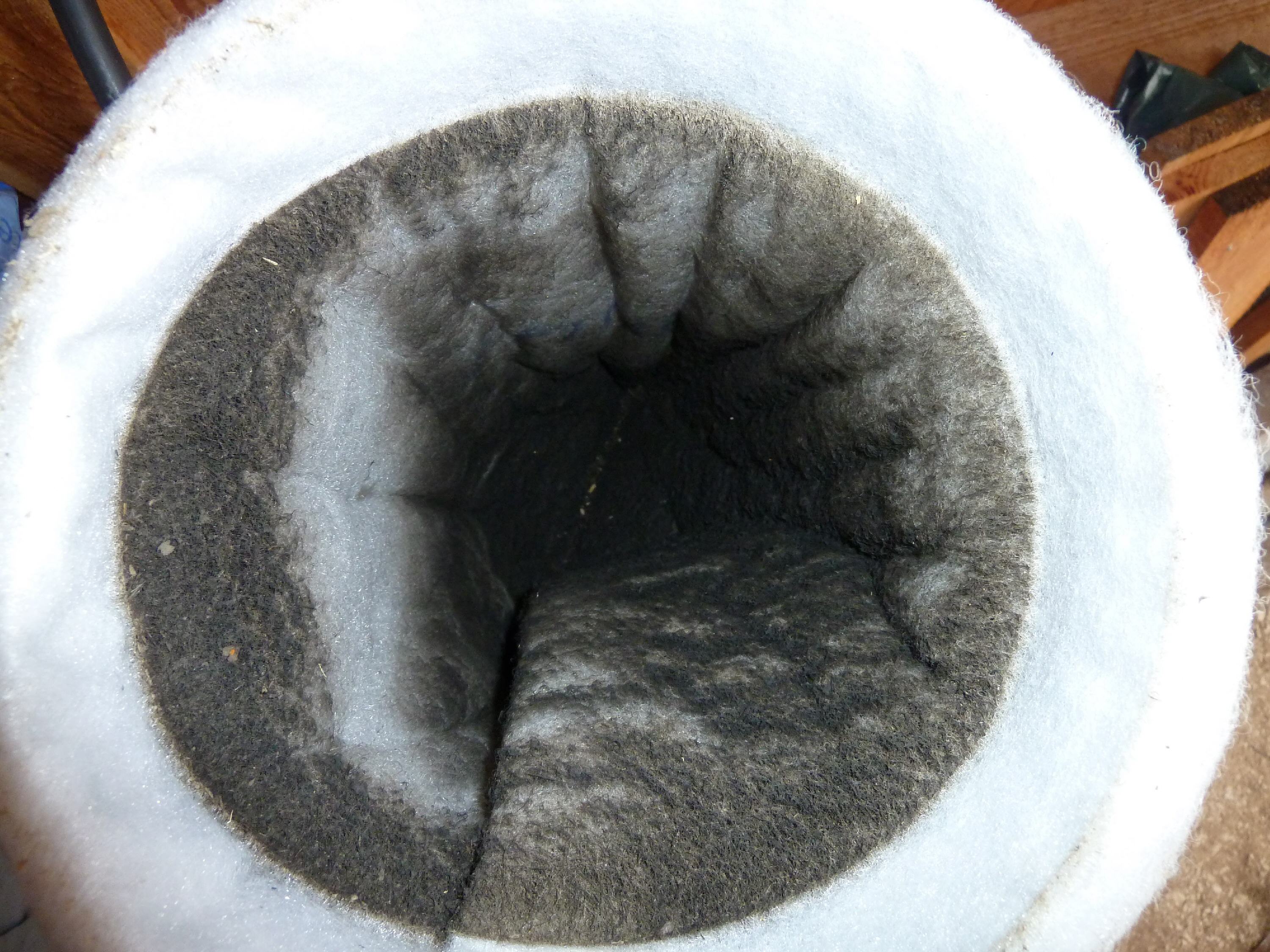

Yes, cone filters or rectangular filter bags. You can sew them yourself from fabric by the meter ... then it costs practically nothing.
Isn't it possible to at least get to the intake so that you could hang a filter bag in there every 6 months?
For example, remove the hood/fly screen, hang in the filter bag, put the hood back on/secure it?
That's roughly how we do it ... just slip a self-sewn G4 filter bag with a rim over the pipe, so that the filter bag hangs down inside the pipe.
I have a 1m-long G4 filter bag with a 20cm diameter ... we replace it at the earliest after 6 months - and that's fine.
As you can see in the photo, it is worth filtering out the dirt (soot in winter, pollen in spring) ... otherwise that ends up in the controlled residential ventilation ... with the RS-250 directly in the rotor (the supply air filter only comes after the rotor!).
