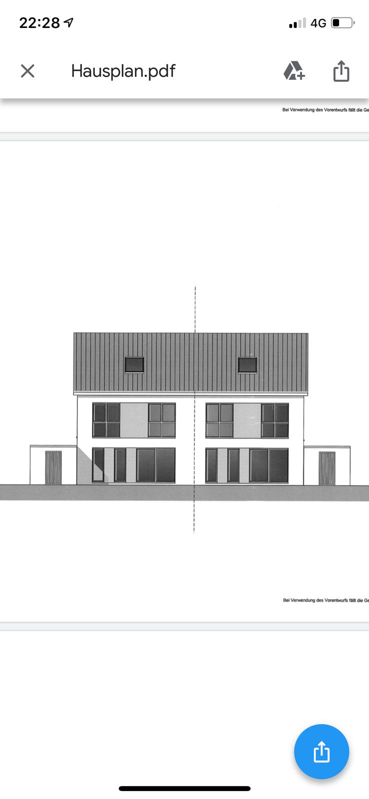

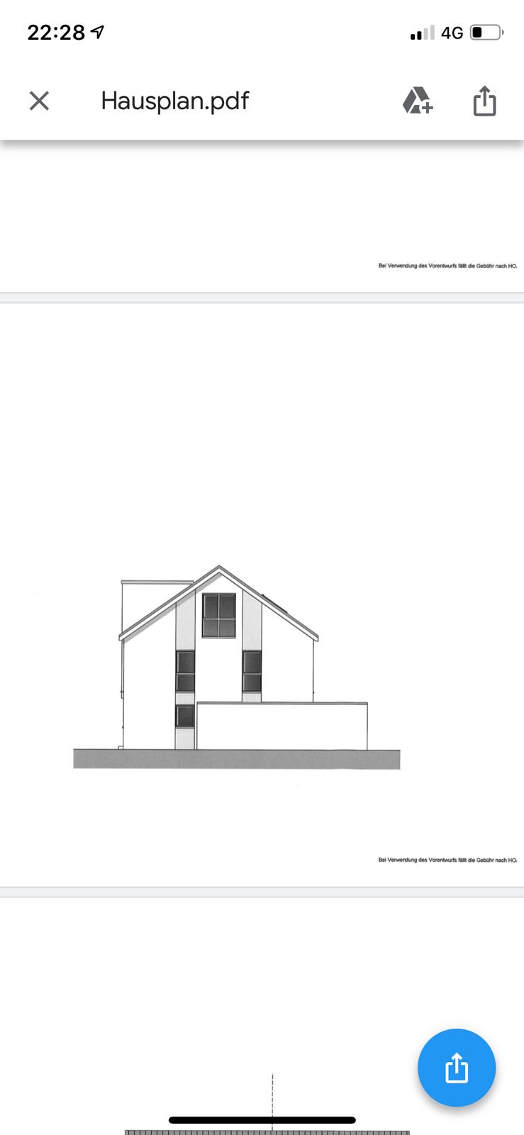

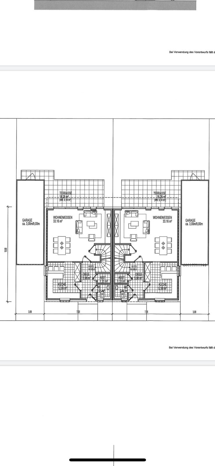

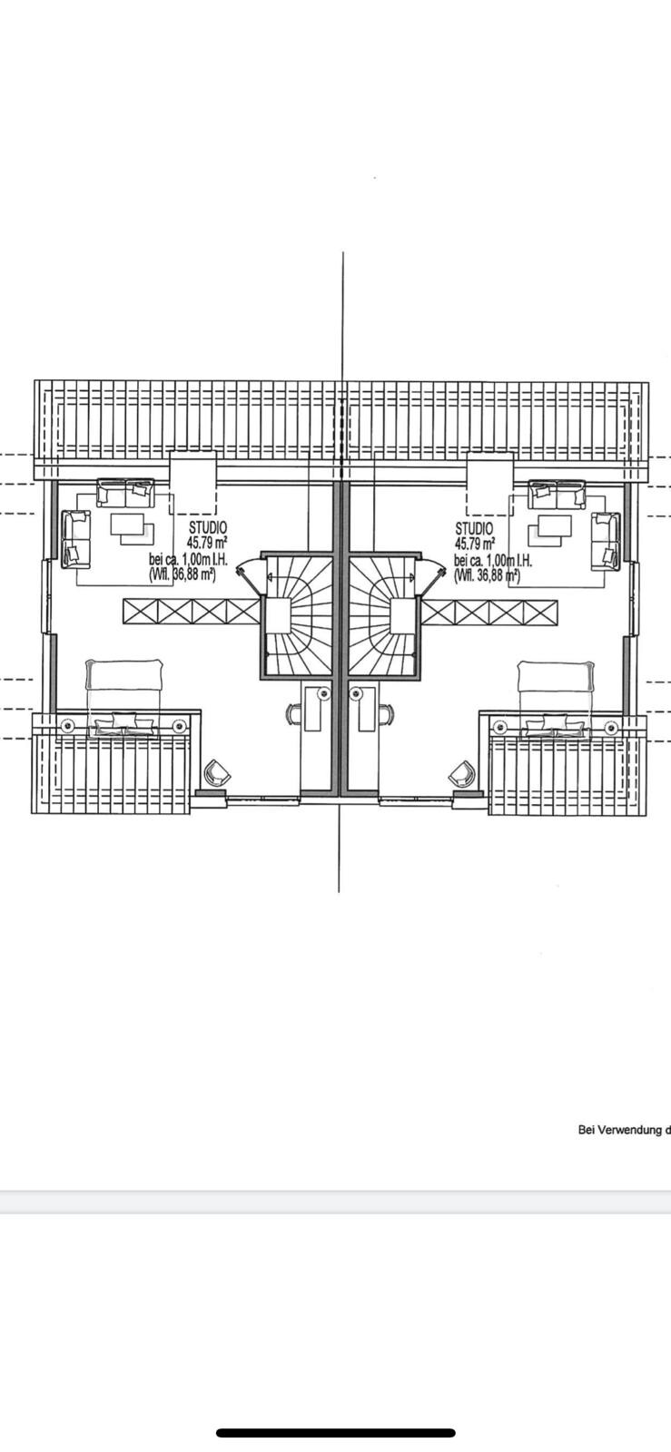

Hello everyone,
I and my surroundings are absolute novices when it comes to construction.
I have now purchased a small 219 m2 plot and will build a semi-detached house on it.
The semi-detached house will have 2.5 floors. I am attaching a picture of what it should look like and some plans.
I WOULD BE REALLY INCREDIBLY THANKFUL FOR ANY TIP.

The architect's price estimate initially appears realistic. Read up a bit and and especially compare the additional costs with your plans and the construction service description of the general contractor. I find the house plan initially workable; a bit more information about the plot would be interesting. Why not add a small bathroom in the attic? P.S. I just made the connection to your other post again, which also includes a site plan. Are you the northern or the southern plot?

A bathroom in the attic would be subject to an extra charge, but I will ask the general contractor for goodwill.
