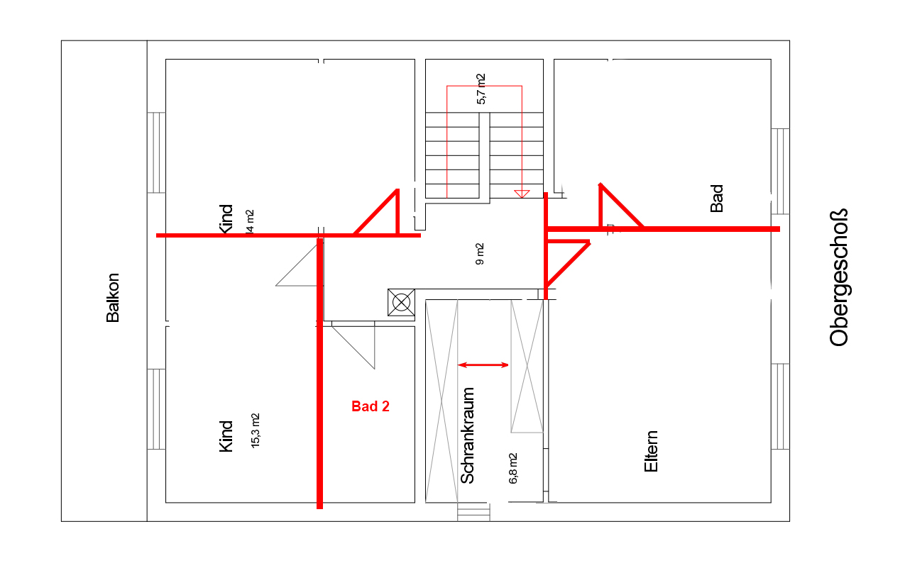

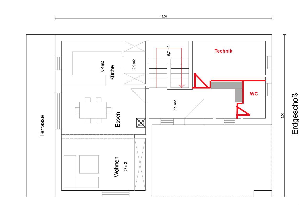

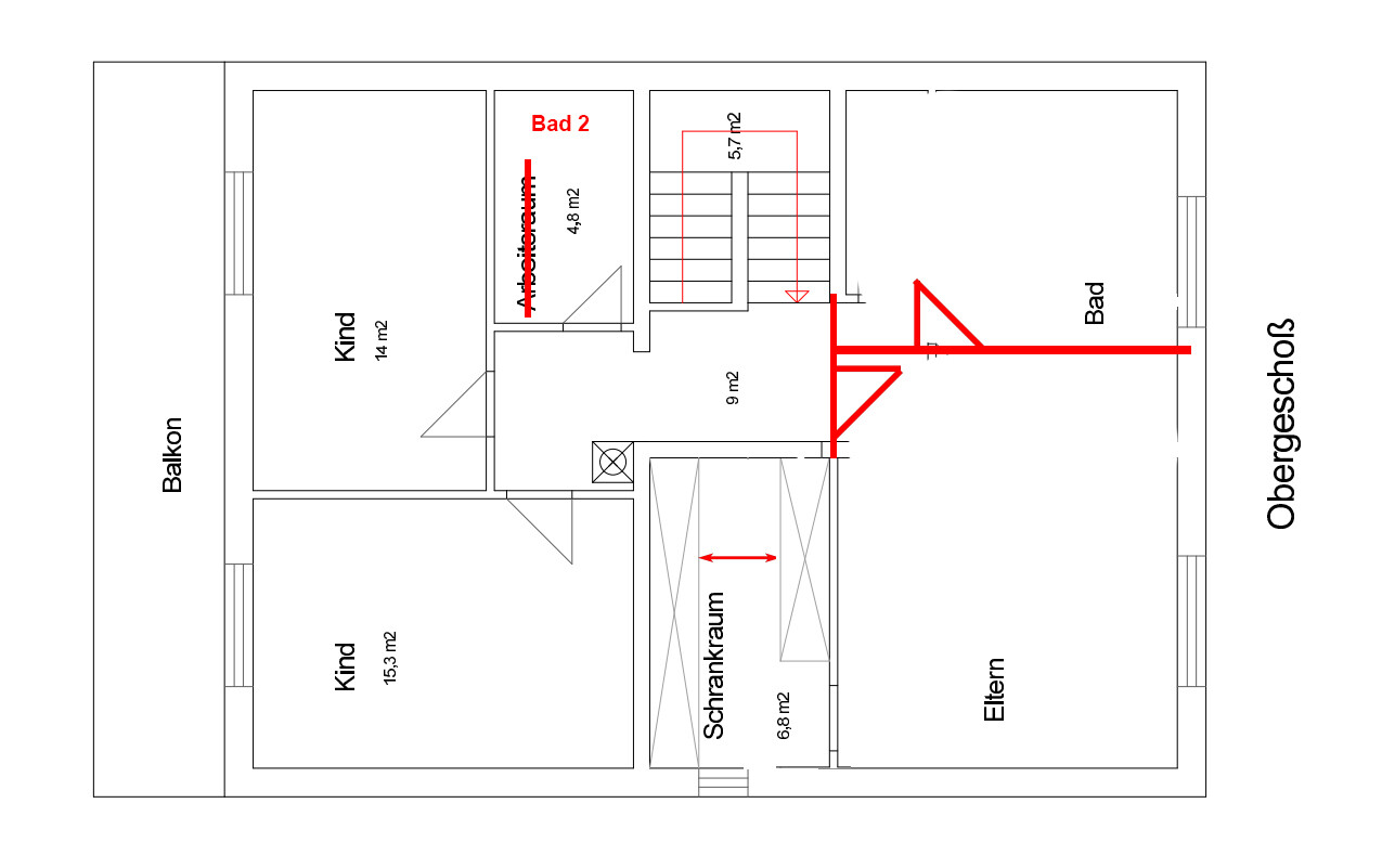

Bathroom downstairs removed, replaced by the utility room + HAR. Convert the upstairs workroom into a children's bathroom. Integrate toilets into the bathrooms and connect the master bathroom directly to the bedroom.
Oops, then Bathroom 2 has no window - sorry. I briefly forgot that. Mess.

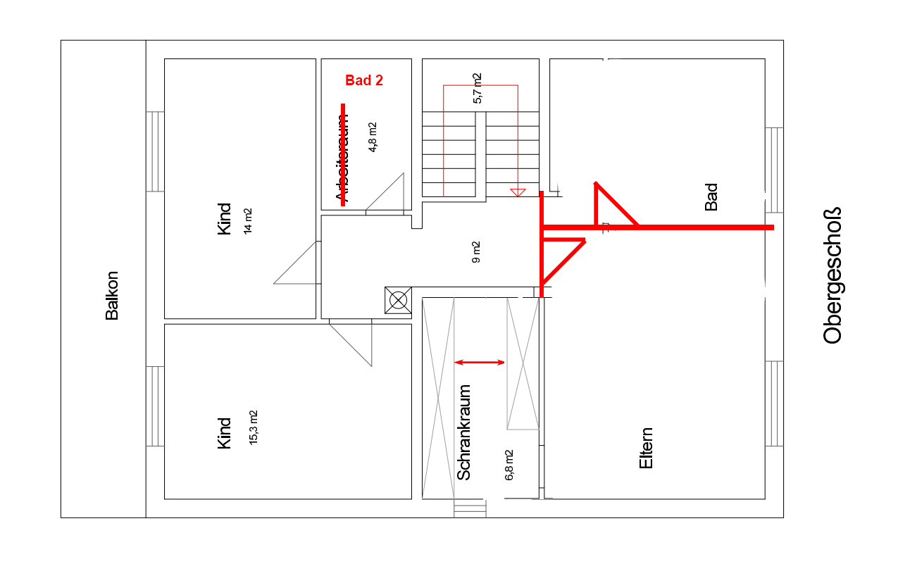

  • #2
Maybe more like this.

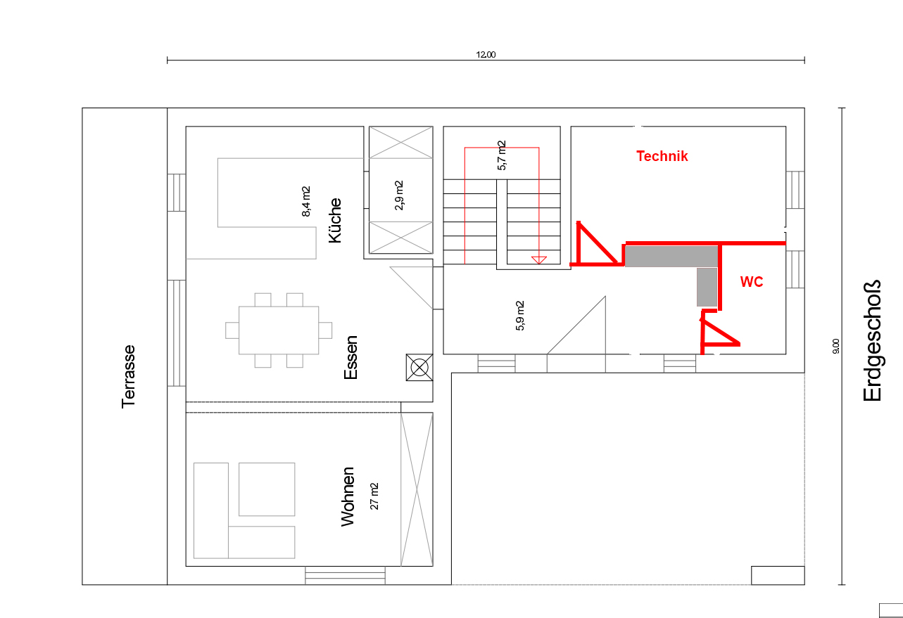

  • #3
Something like , I mean: enlarge the utility room, make the hallway more accessible, the remaining space provides enough room for a guest WC and a wardrobe.
