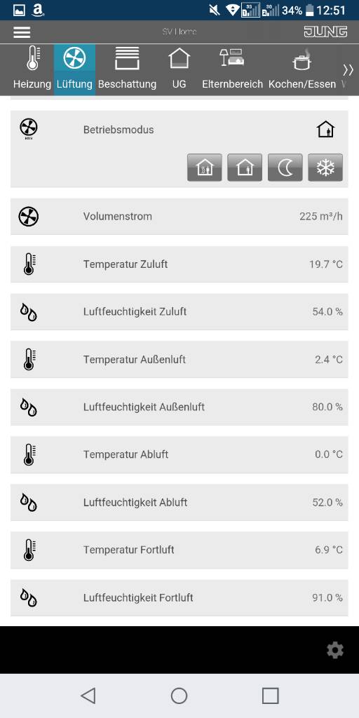

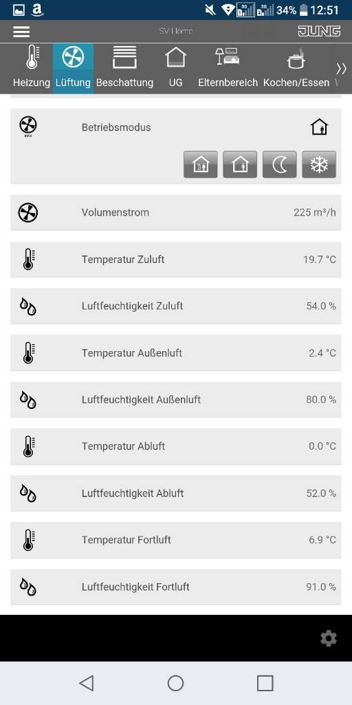

We have installed a Zehnder Q350 with an enthalpy exchanger.
I am just starting to familiarize myself with the device; yesterday I installed the KNX module and began parameterizing it. Nevertheless, it is already apparent, and something we also notice: we should not have any problems with air that is too dry.
Simply super comfortable; I am glad I insisted on the enthalpy exchanger.
