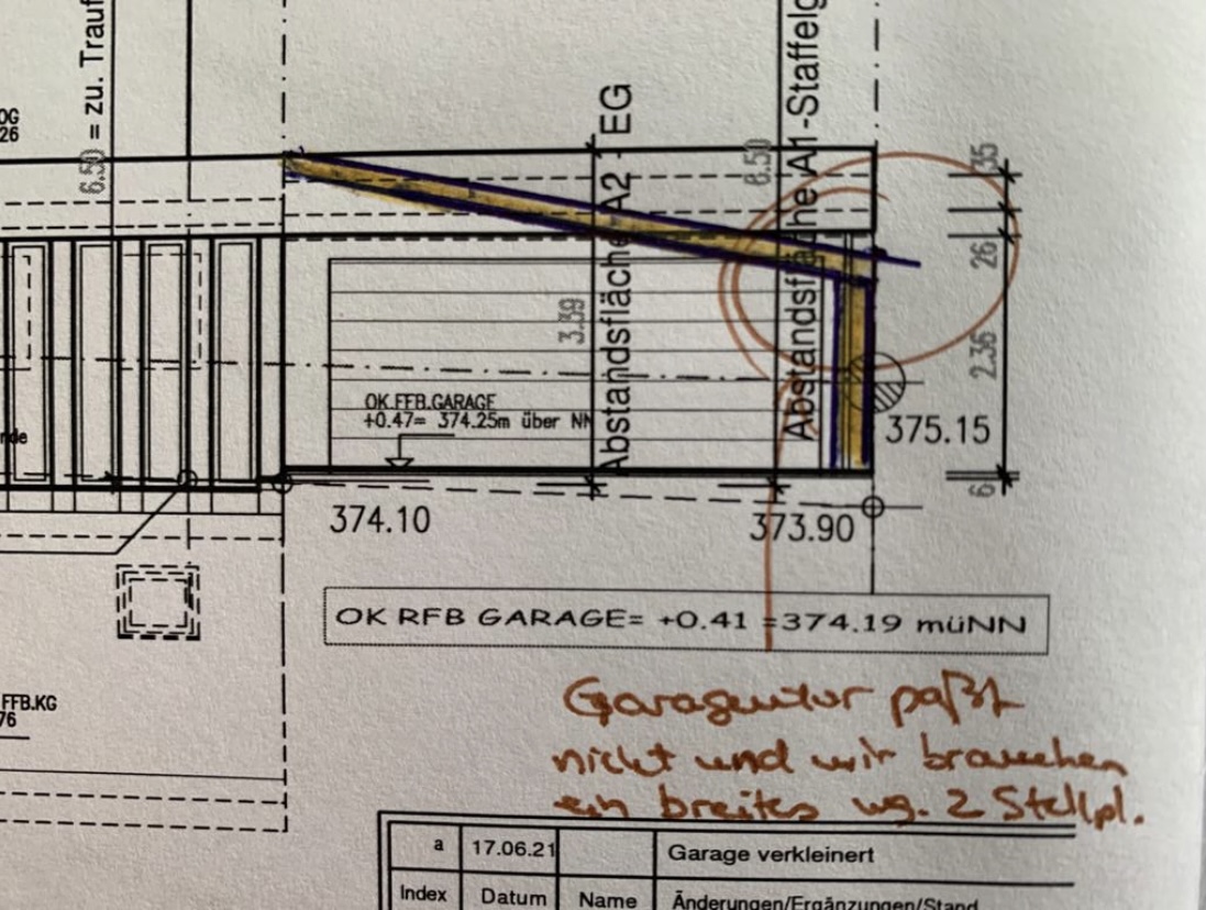

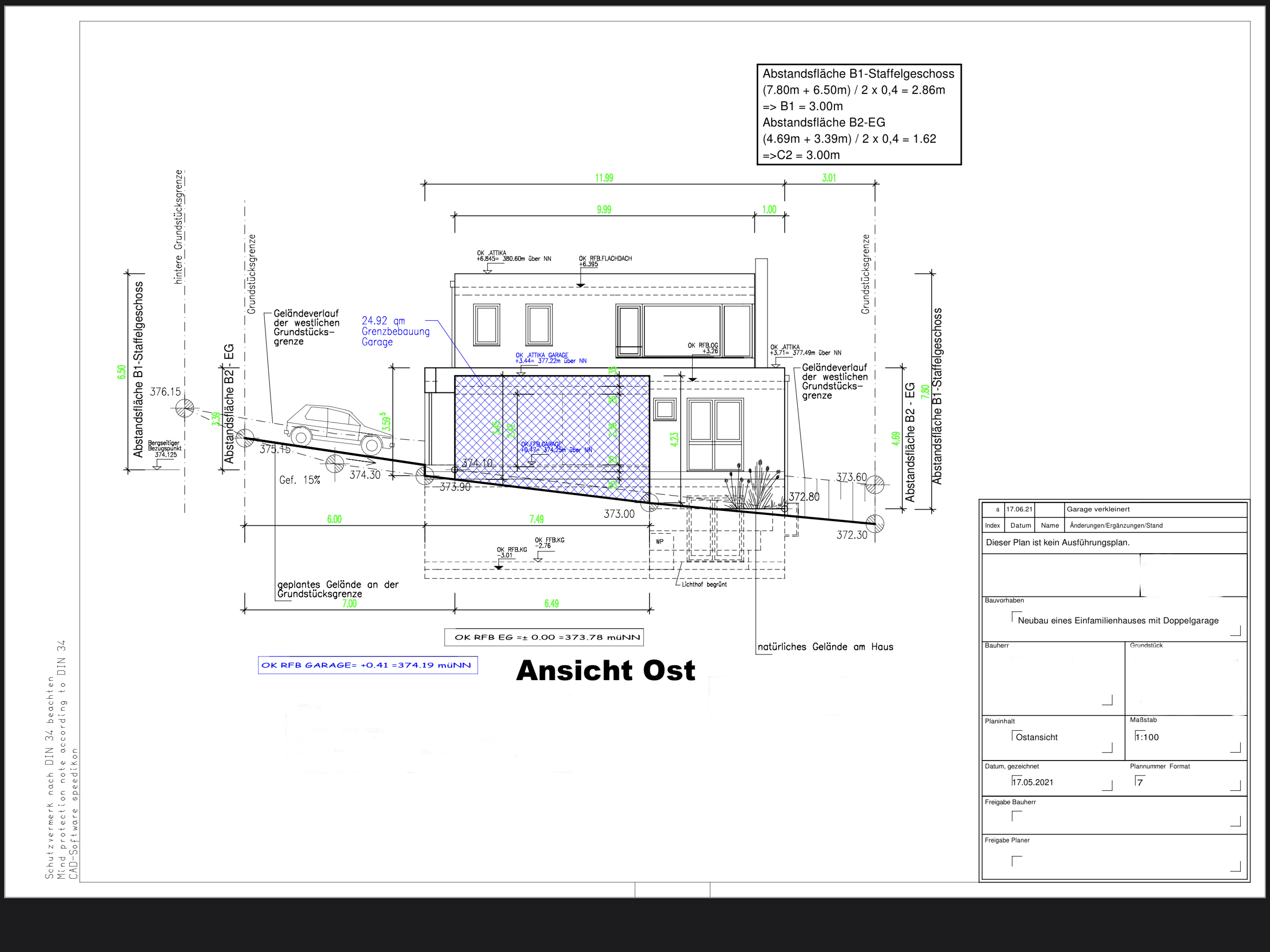

we are planning the construction of a single-family house with a double garage in Hesse. It is a new development area with a new zoning plan. We would like to place the double garage on the property boundary in order to make the best use of the available space. We recently submitted the building application; the first feedback from the building authority concerned the violation of the boundary garage against §6 (10). The first draft did not comply with the maximum boundary building area of 25 m2 as well as the average height of max. 3 meters. Our neighbors at the boundary had signed the plans (based on reciprocity, as they also want to build their double garage on the boundary).
The building authority claims that approval by the neighbors is not sufficient to approve the violation of §6 (10). A property-related atypicality would have to be present.
We have therefore revised it again and proposed the attached draft. Here the boundary building area is also reduced to under 25 m2. Only the max. 3 meters we cannot achieve (currently calculated at 3.84 m).
The building authority suggests moving the garage closer towards the street (the zoning plan only allows 1 meter here due to lateral building setbacks, which does not help with the height). Furthermore, a shed roof was proposed for the garage, but here we do not get the required height for a double gate on the right side. Moving the house to the left is also not possible, as we would otherwise go beyond the building window on the left.
Currently, the only thing I can think of is changing from a double garage to a single garage, in order to then maintain the 3-meter distance to the property boundary and thus §6 (10) would no longer be relevant. Our second car would then have to park outside the garage. Not really optimal, also not for the appearance.

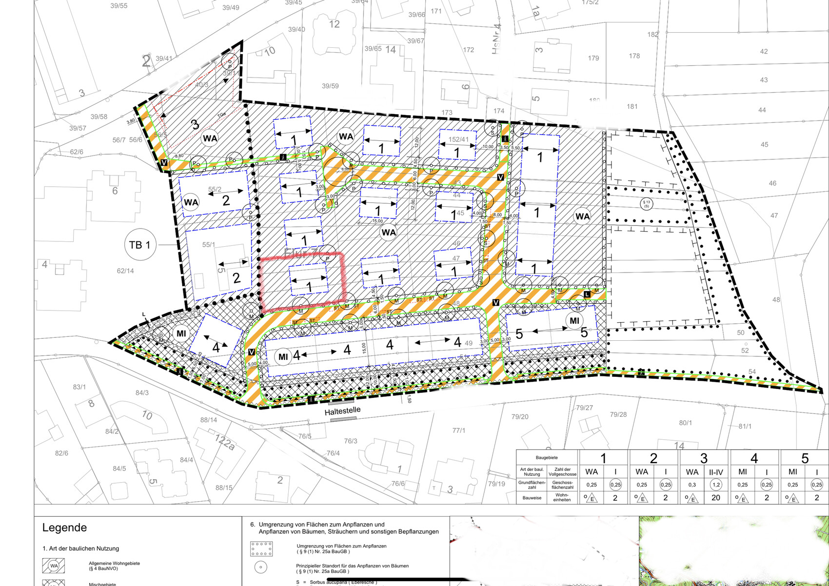

The site plan and excerpt from the development plan are attached to this post (I can also post the entire development plan if necessary, it's just terribly long...)
In the site plan, I have outlined our property in red.

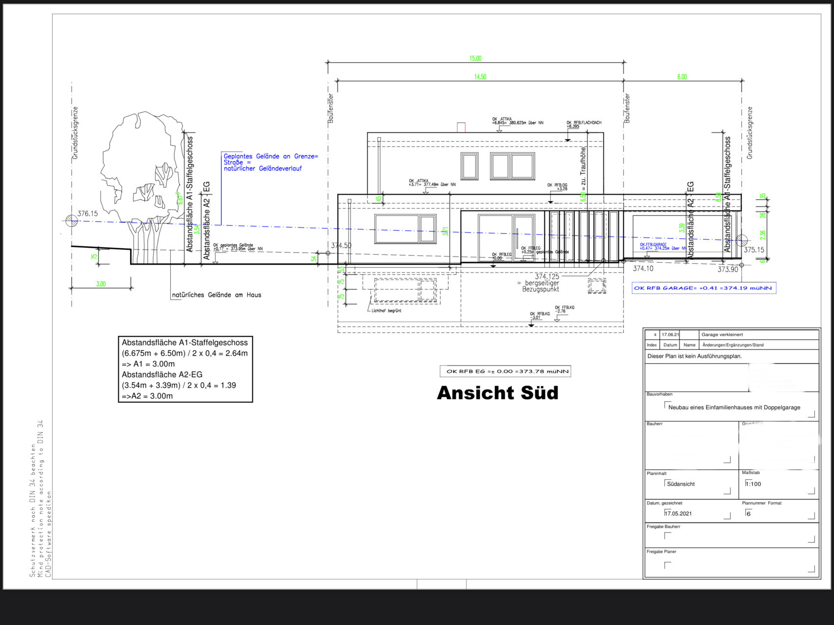

Sorry, I meant south view. According to the proposal, the shed roof should be inclined towards the east. See the sketch from our architect attached. She thinks a shed roof is not practical (and does not fit the appearance of the house).

Yes, that’s true. Maybe I’m overlooking something, but the situation appears to me as follows:
According to planning law regulation 5.2, the garage may be built on the boundary. From the building code perspective, there are now two possibilities for the garage not to trigger setback areas. The public-law assurance according to §6, para. 1, sentence 2, no. 2 or para. 10, sentence 1, no. 1.

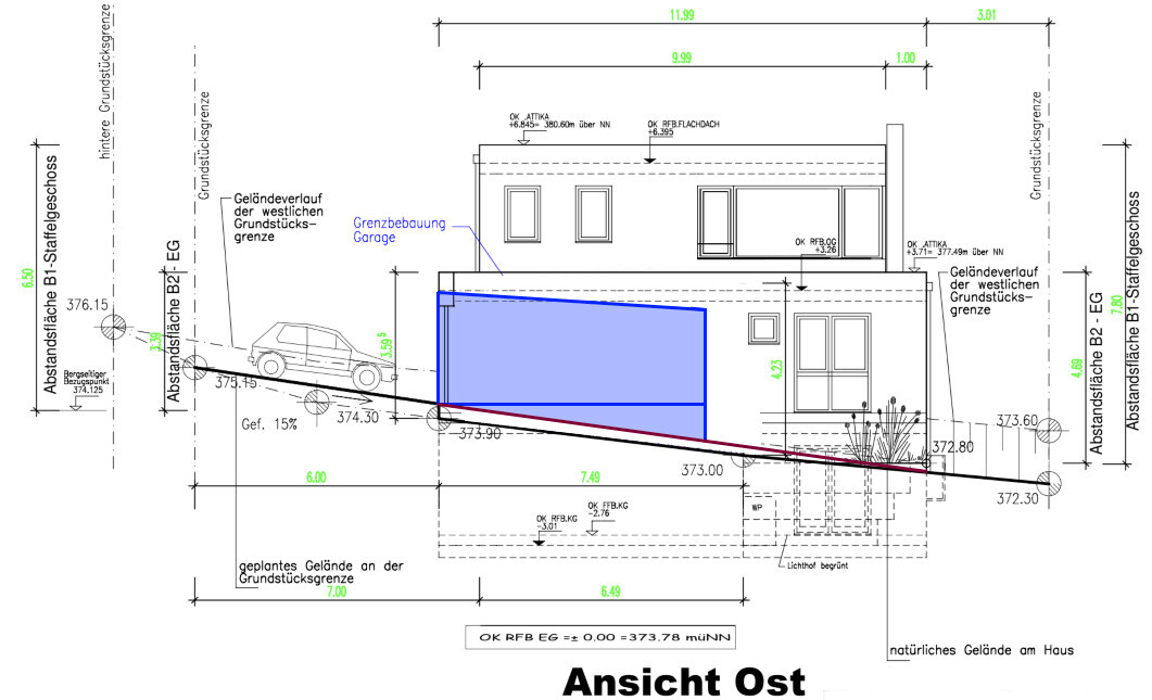

Due to the special topography, according to §2, para. 6, HBO, not the natural but the terrain surface specified in the building permit is used, so the 3m also fits.
Yes, for example "Obligation, in case of a later construction on the encumbrance property, to attach to the exterior wall of the garage planned on the building plot."
None are known to me.
I also think that’s not good. Therefore, I inclined it to the north.

I also like your draft regarding the shed roof better, I will pass that on to our architect, but it will probably still be tight because of the parapet, but at least the gate problem would be solved…
