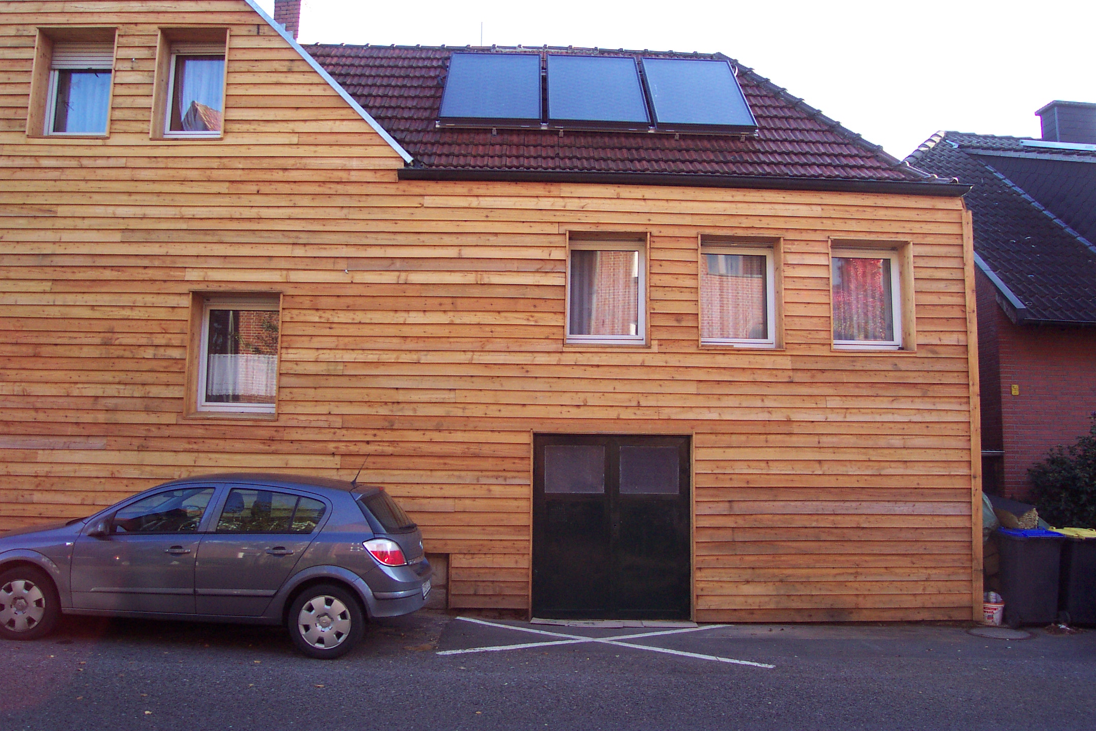

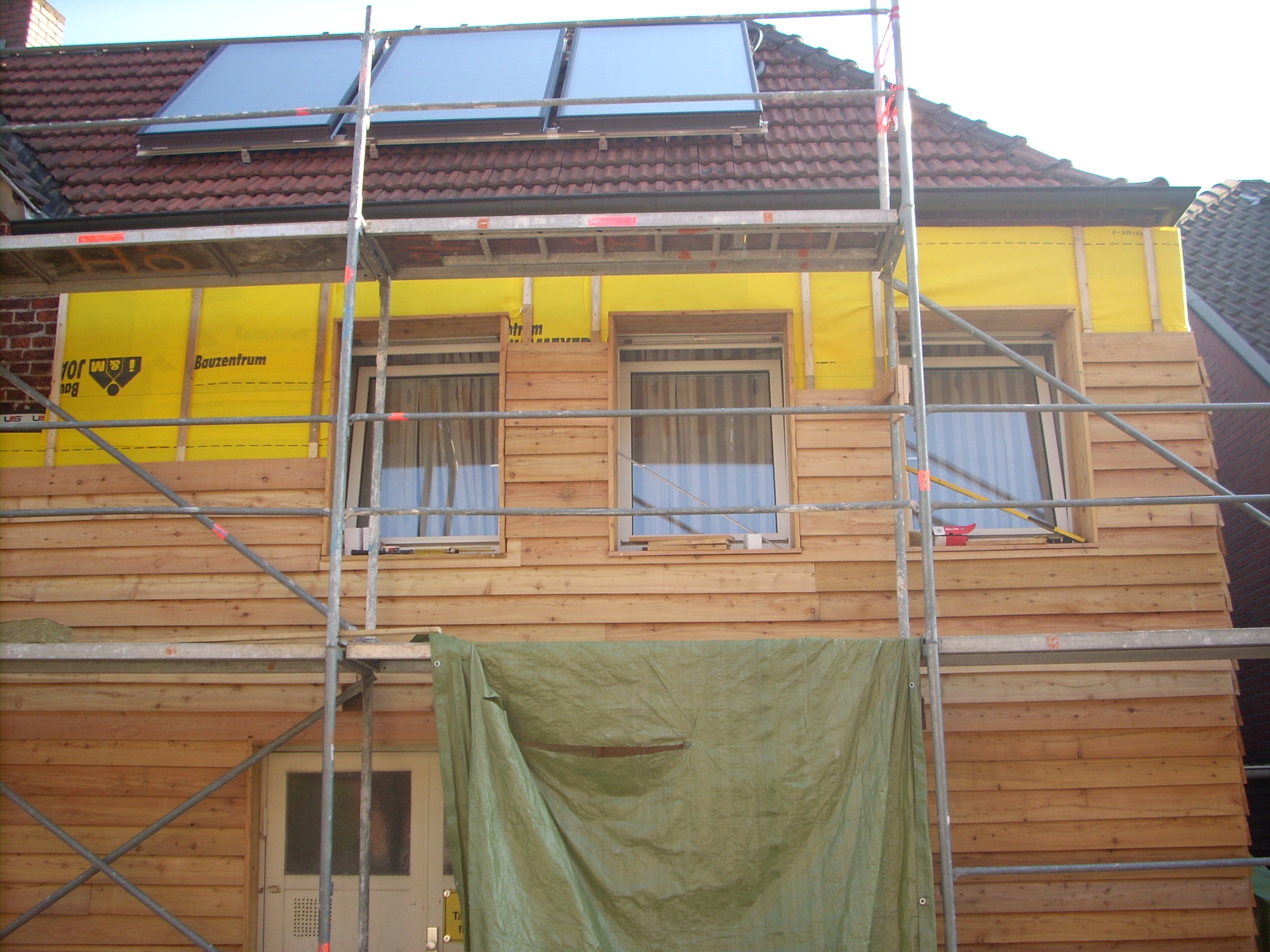

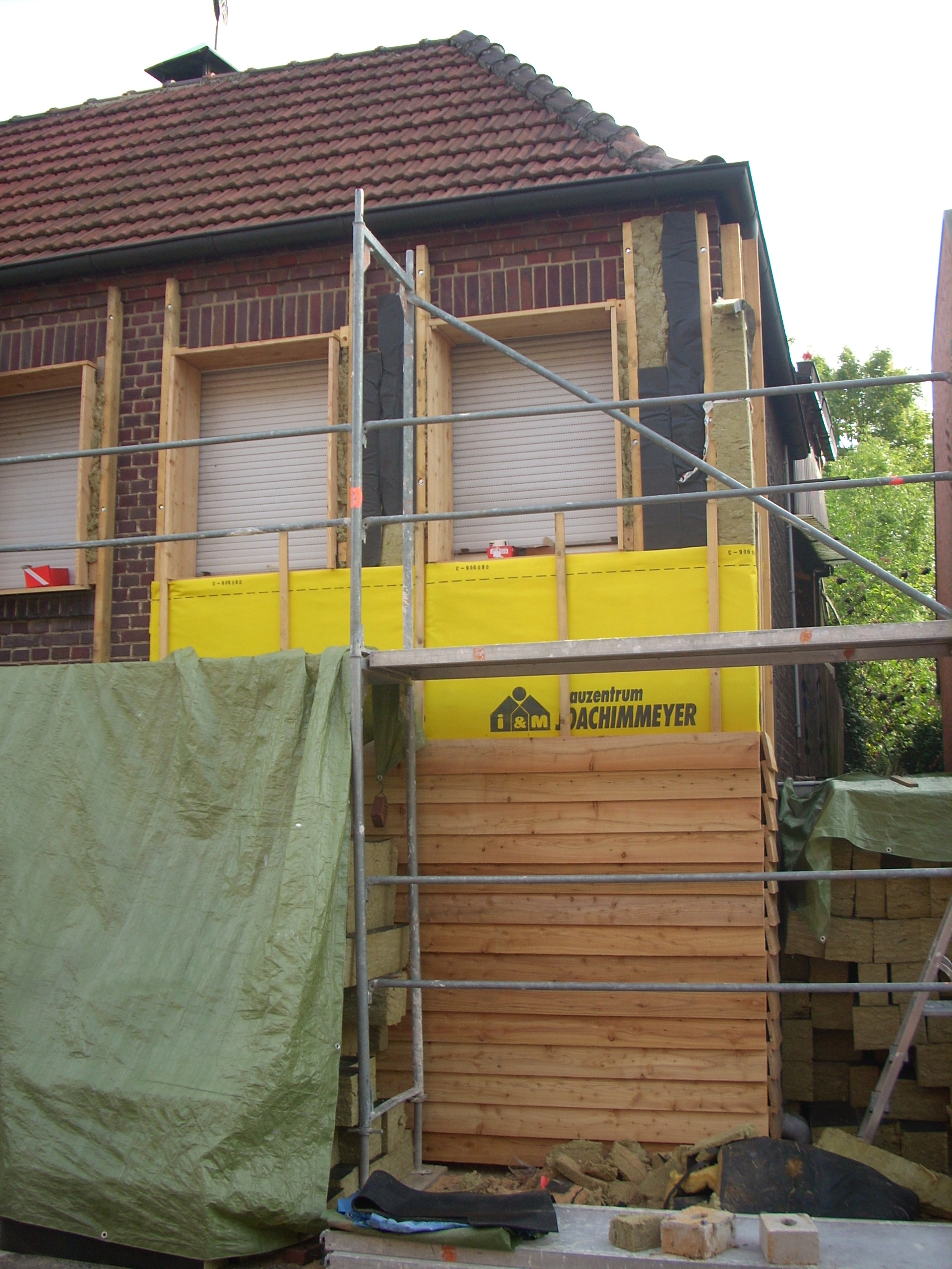

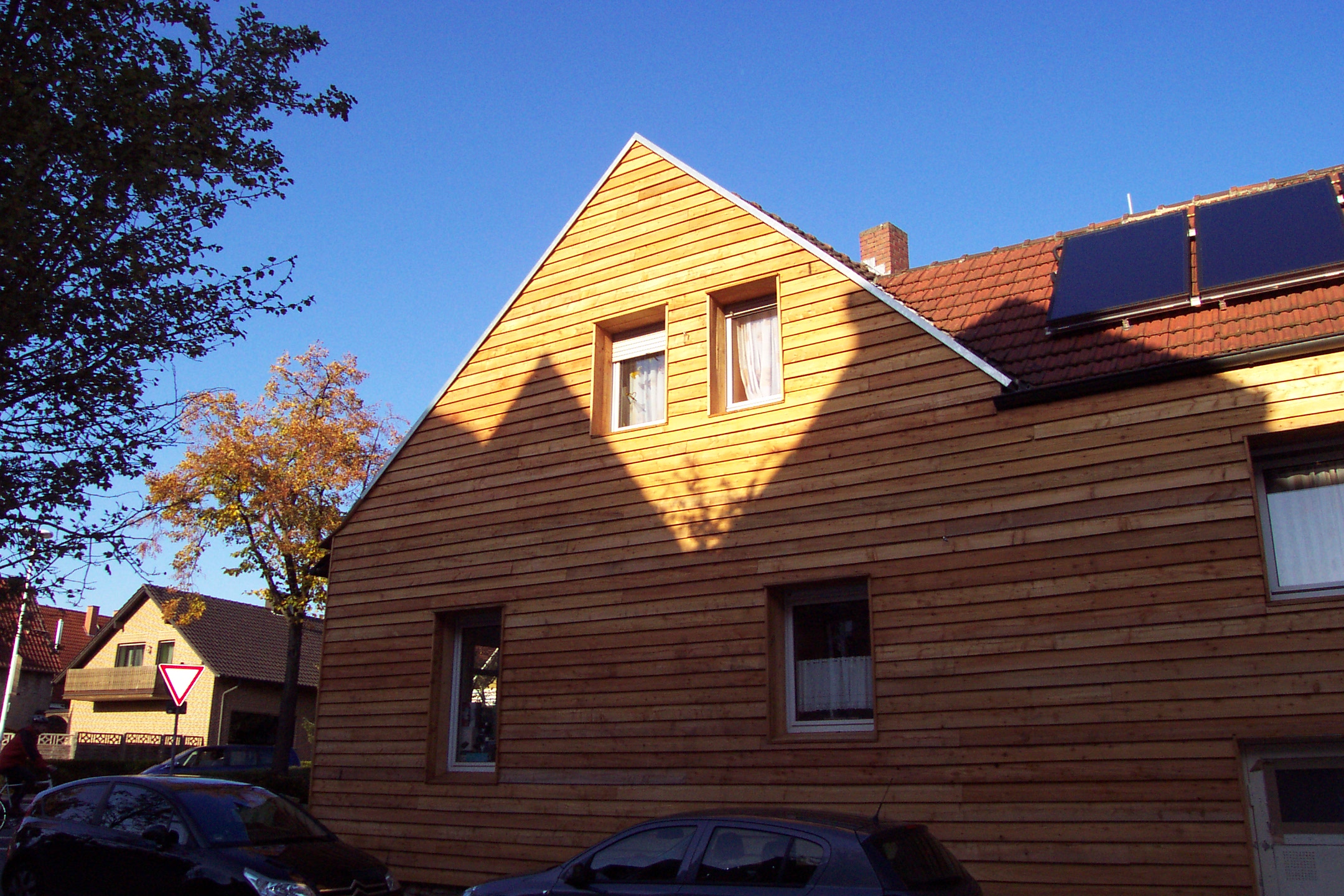

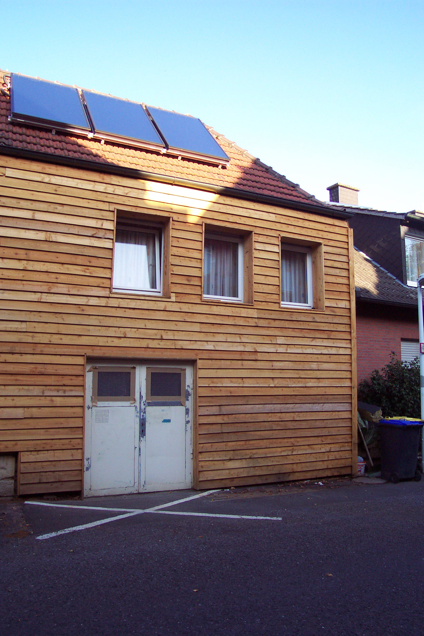

Hello,
well, relatively happy. About 15 years ago I realized a curtain facade made of wood with stone wool as a DIY project. About 100m² of facade area with larch as shiplap cladding. 10cm squared timber mounted on partially soft-burnt bricks (270-year-old house) and 10cm stone wool in between. Above that, a facade membrane ([Dachunterspannfolie?]).
The facade has received zero maintenance since then, the larch has gracefully turned gray and still looks okay (when brand new the facade looked fantastic!)
The reveal of the windows (insulation) I made from space reasons with 5mm thick neoprene! Rodent protection at the bottom with perforated aluminum sheet.
There should still be pictures of it somewhere in the forum if they haven’t been deleted.
I would do it a bit more perfectly today (have it done). Back then it was just barely affordable for me with leftover or special order squared timber, larch as a barter ;-) and insulation as scrap (had to piece it anyway due to tricky facade).
Today I would do it (like a gable on the same house) vertically as floor/ceiling cladding instead of horizontal shiplap cladding. I would accentuate the ventilation more clearly and, if possible, use somewhat thicker insulation. I would install the facade membrane with more precision and possibly combine other measures (at that time I also simultaneously replaced a very old oil heating system with a condensing boiler + solar thermal + installed an extra solar storage tank). With that, my financial resources at the time were more than exhausted.
But in the end, my somewhat amateurishly cobbled-together facade still looks okay and works without any maintenance. I also assume that another 10 years won’t change anything essential about it, but that would be relatively irrelevant to me anyway since it’s sold as of [15.12].

just found the picture folder ;-)
Maybe it will help you with your decision.
The last picture with freshly painted door ...
Pig-like work in the height of summer with "full-body condom/suit" and mask.
Sweat and stone wool fibers, well, you can imagine how well that fits together :-(
Every 5m long board mostly alone! slid myself over an "Erika" to undercut
because of drip edge. Installation above impossible for me because of pronounced fear of heights and only possible through
support from family and friends (again, big thanks!)

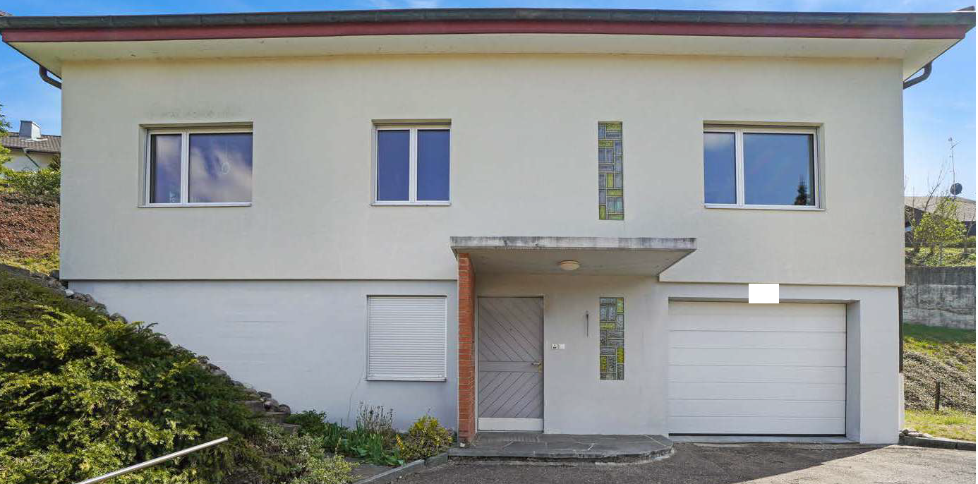

This is now the west front view/entrance area with the problem construction site aka "thermal bridge" old canopy. The thing is reinforced and cutting it away and installing a new aluminum canopy is not easy and costs a lot. I have also long considered replacing the glass blocks with frosted glass or simply insulating over them, but then there would be no sunlight in the stairwell.
Total facade area approx. 200 m2, the house is 12.8 m long (west side is the long side) and 9 meters wide, has strip foundation (basement and no cellar).
