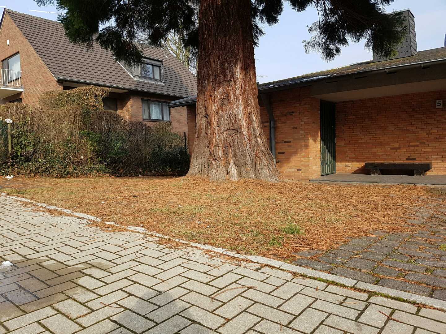

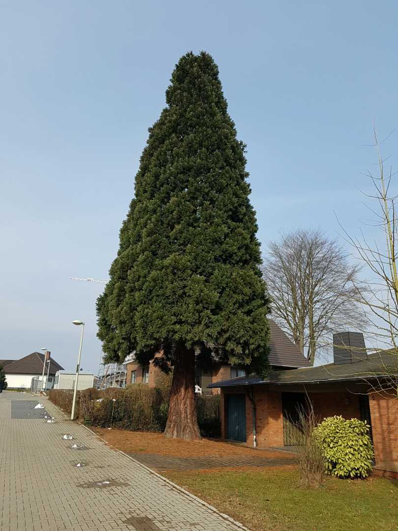

we have purchased a property and in the front yard stands a huge sequoia!
The tree was one of the reasons for buying the property because we find it so fantastic and impressive. Now the seller told us at the notary that the tree will continue to grow. It is this tree here:
Sequoiadendron giganteum
I doubt that it will grow as large as in its native habitat, but I think one should definitely consider how to proceed now.
Preferably, the tree should remain standing. The house will be demolished and a new building erected. We are happy to align the construction a bit around the tree and also make some compromises if necessary.
BUT:
1) We are afraid that the tree might eventually fall onto the roof.
2) If we already include the tree in the planning, we would like to know what lifespan to expect and how vital the tree is. Can it even tolerate a new building with the corresponding activities in and on the ground?

I don't think the tree will fall on your roof.
I would rather be concerned about the possible roots. See Wikipedia:
Roots
In their natural distribution area, giant sequoias form a shallow and extensive root system that does not reach very deep. The roots of older trees usually do not penetrate more than one meter deep but spread up to 30 meters sideways and can grow through areas of up to 0.3 hectares. In Central Europe, younger trees have also been found to have taproots up to 1.80 meters deep.

The tree is quite close to the currently basemented house. Do you think the roots have, so to speak, adapted to the masonry basement? At least, I haven't seen any breakthroughs underneath....

For this, as you mentioned, the expert would probably have to be consulted. But presumably, the roots will be lying around it. The question is also what you want to build there. With a basement or without a basement? Also the question of how it will technically look with water pipes, electricity, etc. on the property.
