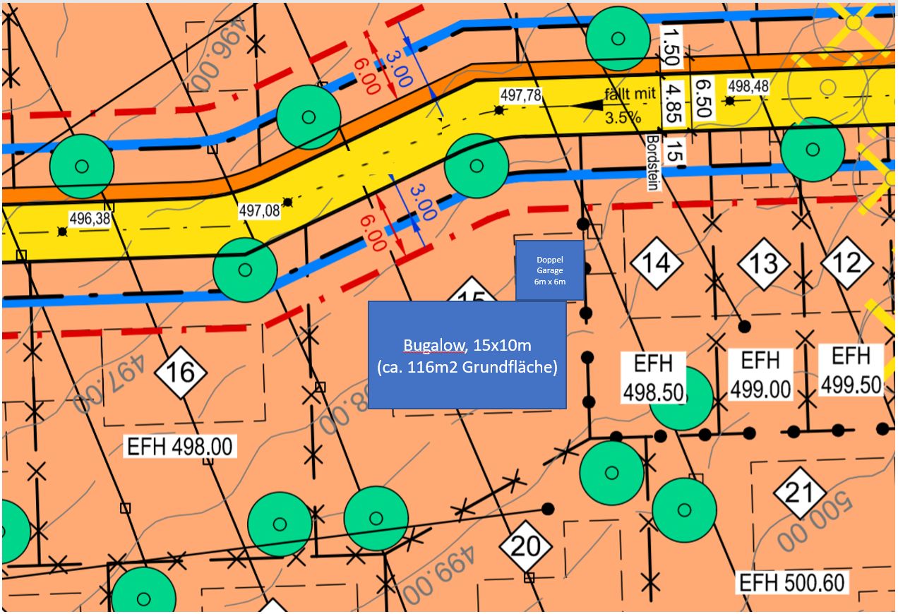

Dear Construction Forum
I am still at the very beginning of planning a single-family house. The following framework conditions apply:
Currently, I am trying to find out whether a bungalow could work for the desired project. The idea would be as follows:
Very rough cost estimate (so far without soil survey):
I see the following advantages to the idea:
Does the proposal make sense, or would a two-story single-family house with about 150m2 be more sensible, especially for the plot? The office would then be on the upper floor but would have to be smaller. The main advantage of this solution would be the additional garden area.
I am aware that all this is still very rough. My goal in the first step would be to find out what possible variants there are.
Many thanks for all tips and advice.
[*]Plot available, all roofs and building types allowed
[*]House construction budget: 500,000 EUR including ancillary costs and kitchen
[*]Living area 115m2
[*]Office with 60m2 (single room)
[*]Double garage
[*]If possible, KFW 55
[*]Since the plot is relatively large (712m2), a bungalow could be placed
[*]The bungalow would have a relatively small but sufficient living area
[*]The bungalow will be fully basemented and, except for the "office," the basement will be usable storage space
[*]The office will be the only basement room equipped with heating.
[*]Bungalow: 115*2500 => 287,000 EUR
[*]Basement: 115*750 => 86,250
[*]Ancillary costs: => 74,650 (20%)
[*]Everything necessary for daily life on one level. Especially when getting older.
[*]Office cooler in summer than on the upper floor
[*]No sloping ceilings in the office
[*]Technical room can be placed in the basement
[*]Additional usable/storage space in the basement
