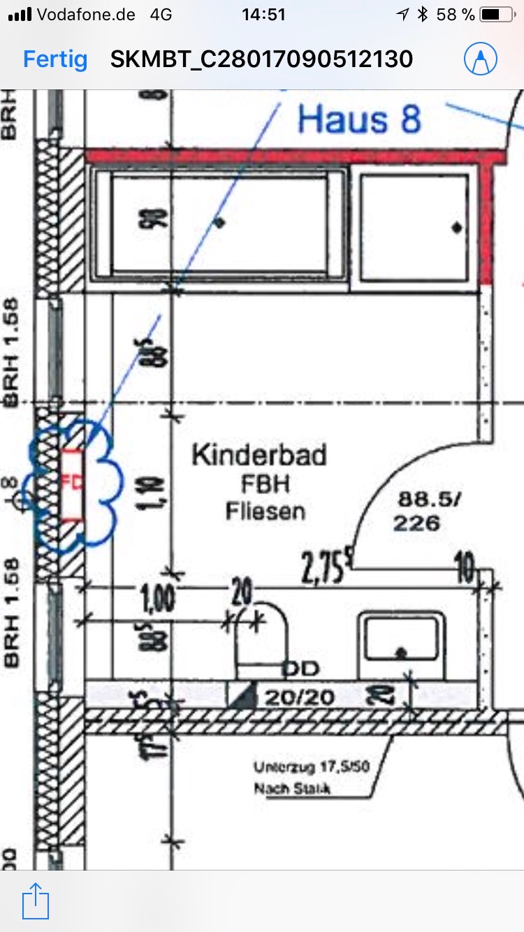

we are currently working on the bathroom planning and are not really satisfied with the result from our bathroom studio.
I would like to ask here for ideas and alternatives.
Our bathroom is 3.81 meters long and 2.75 meters wide, so just under 12 sqm in size.

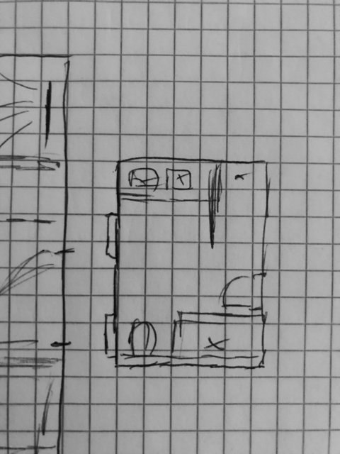

The bathroom studio recommended a T layout, but here we only have a passage width to the shower and toilet of 55 cm each. That seems very narrow to me.
I am attaching the pictures, the first is the floor plan of the bathroom, the second is the idea from the bathroom studio.
Thank you very much,
Karen

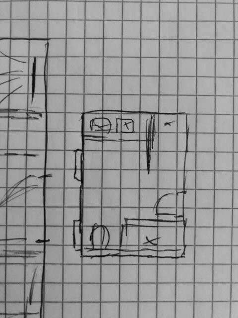

This is the sketch of the bathroom planner

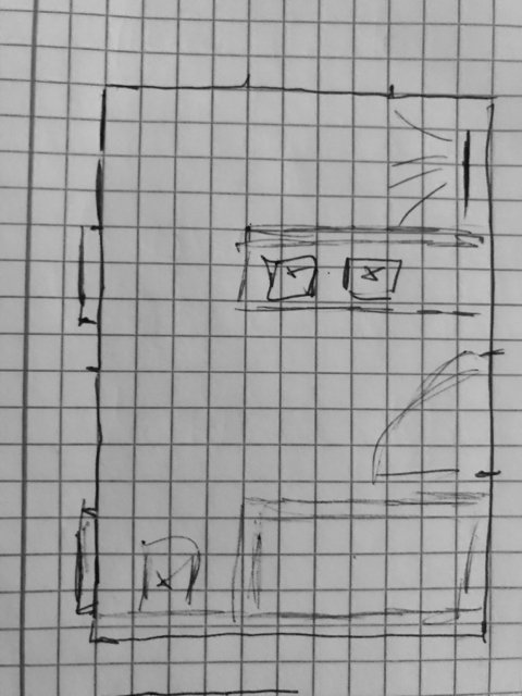

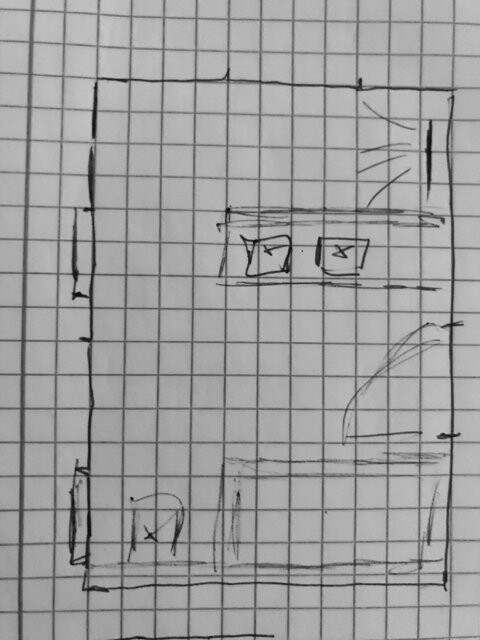

Simple suggestions, because there are no measurements:
The first suggestion has the disadvantage that the washbasin is at the door.
I don’t see a T-solution.

as ypg criticized in the second proposal: my parents-in-law and we have that and if someone opens the door while the other is brushing their teeth, it can already lead to bruises.
