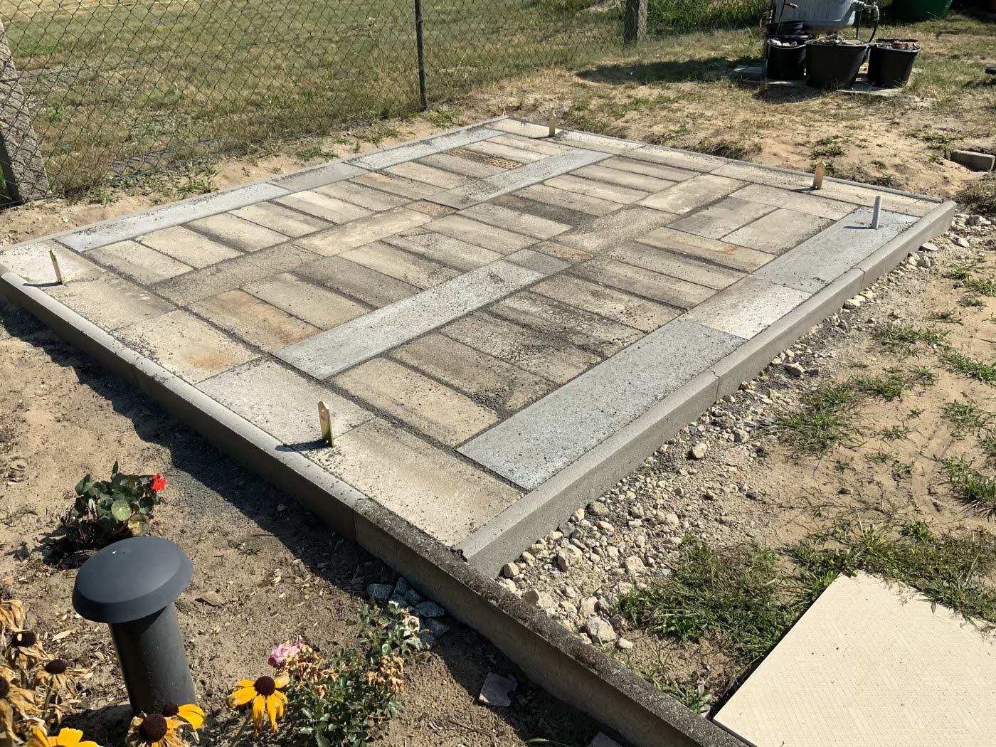

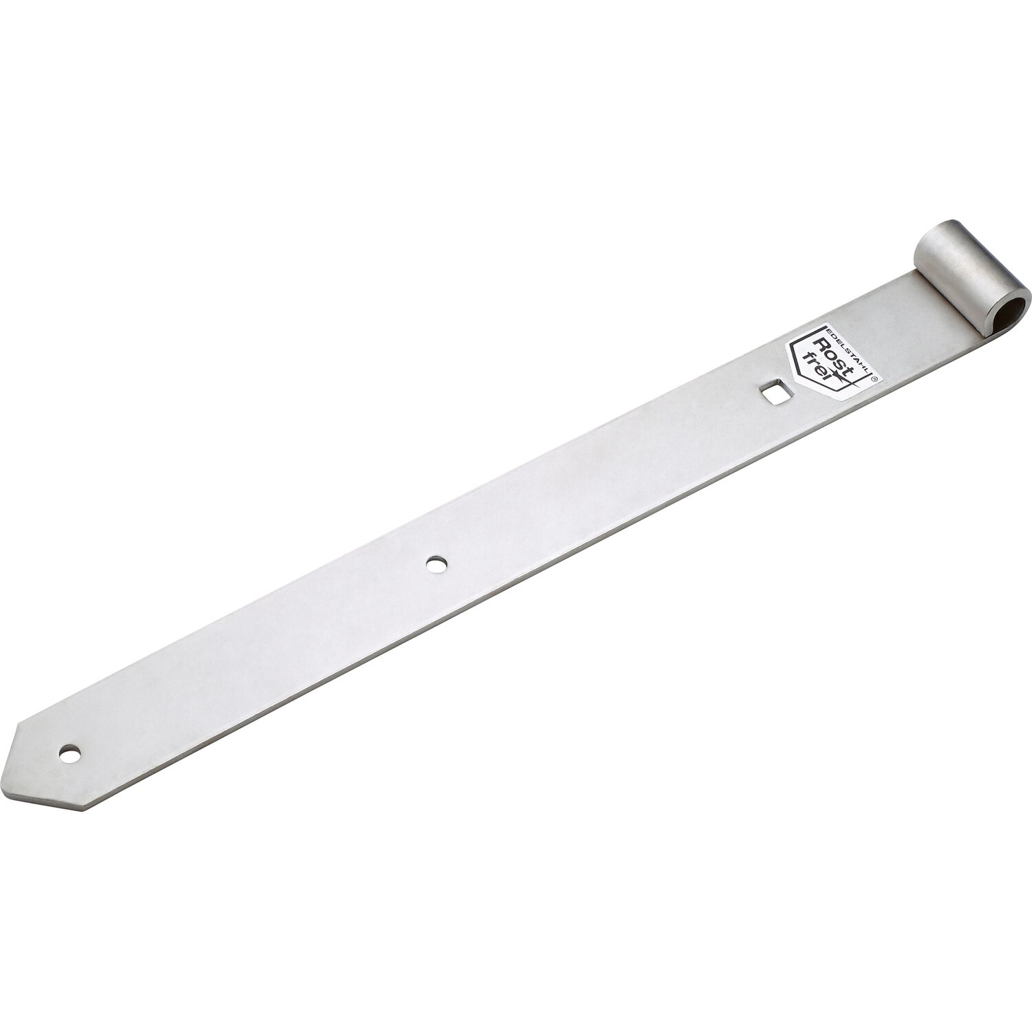

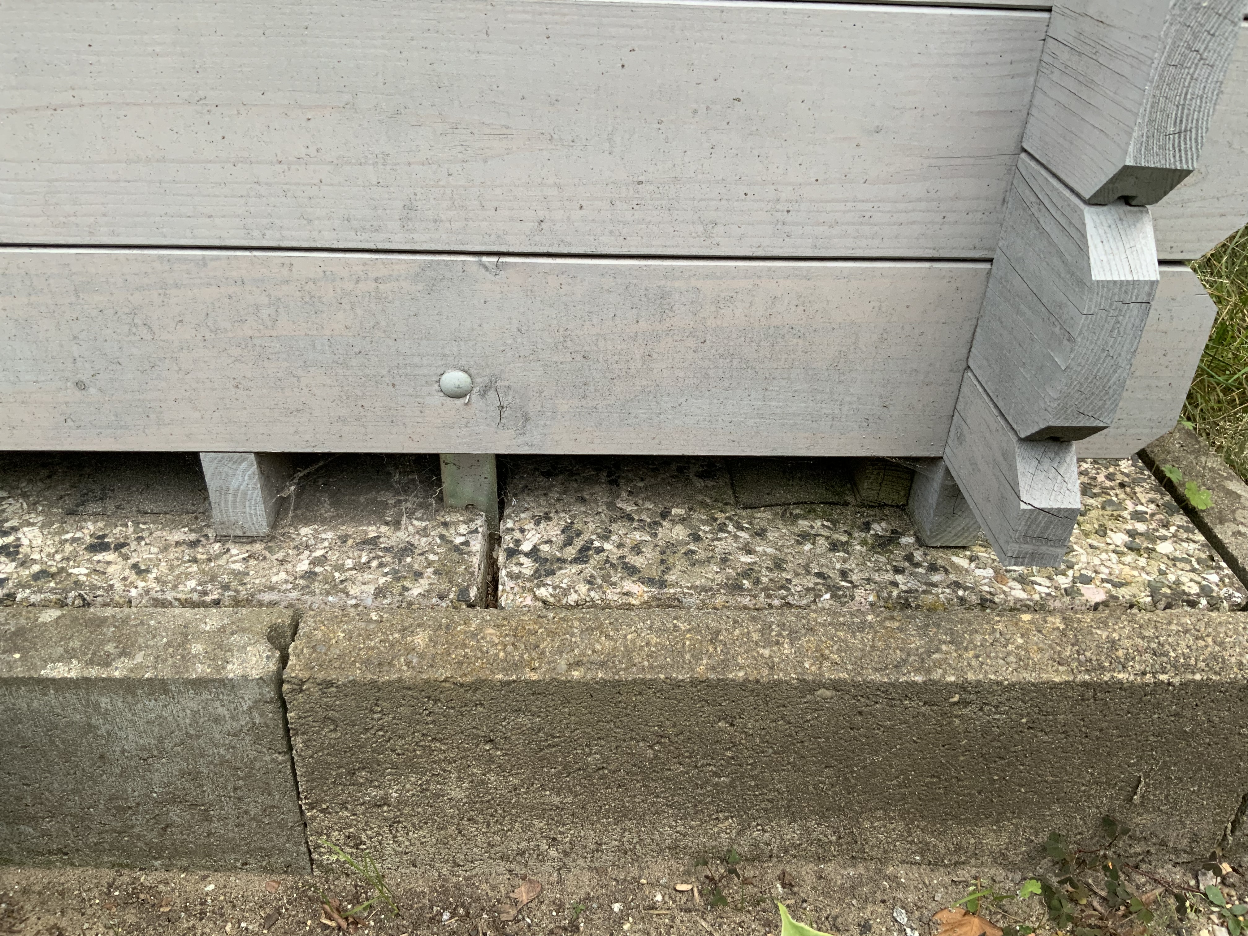

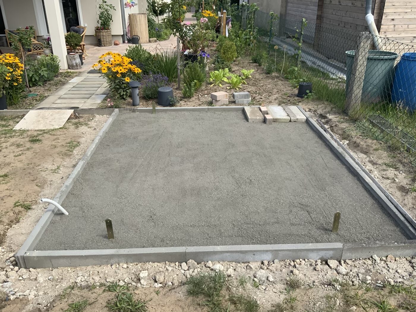

We have concreted in 4 load straps for this. We also inserted a piece of reinforcing steel through the eyelet and fixed everything together with concrete under the slab foundation. We then screwed the straps to the hut … here are pictures..

Great! That sounds very good. Silly question... I have also thought about it, but can I drill into a curb? I would have drilled and put in bolt anchors... it will break, right?
