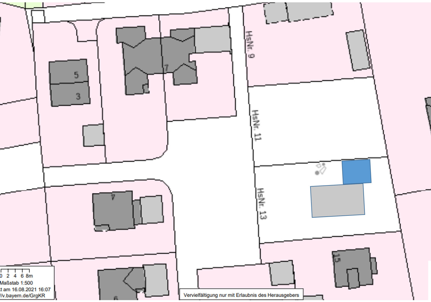

Size of the plot: 838 m²

Not ideal is the distance to the property boundary in the south. However, the plot is “only” 21 m wide and therefore more space is difficult. We also definitely want a double garage. To the west the plot is very open (no house nearby), so the terrace faces this direction.

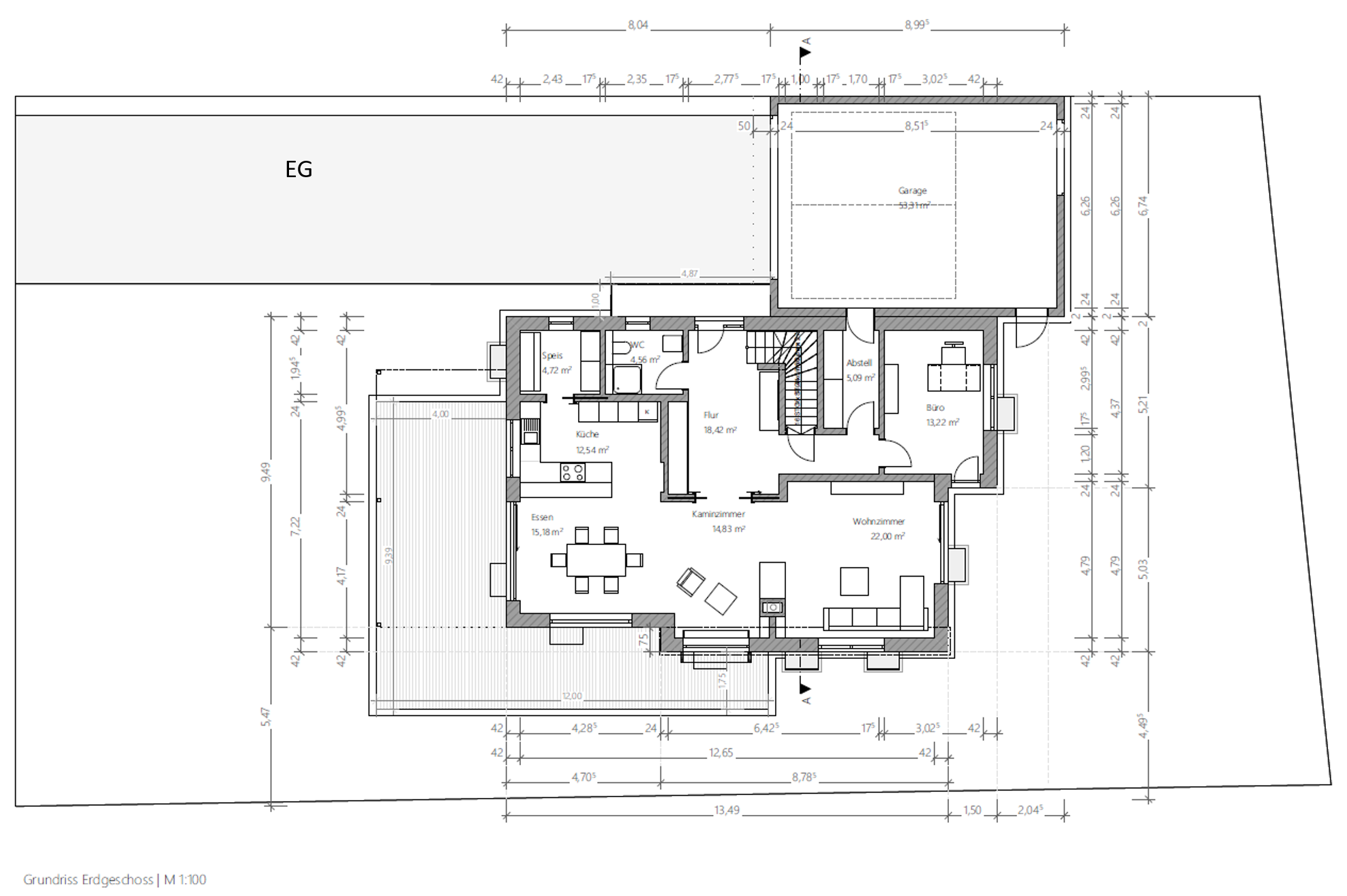

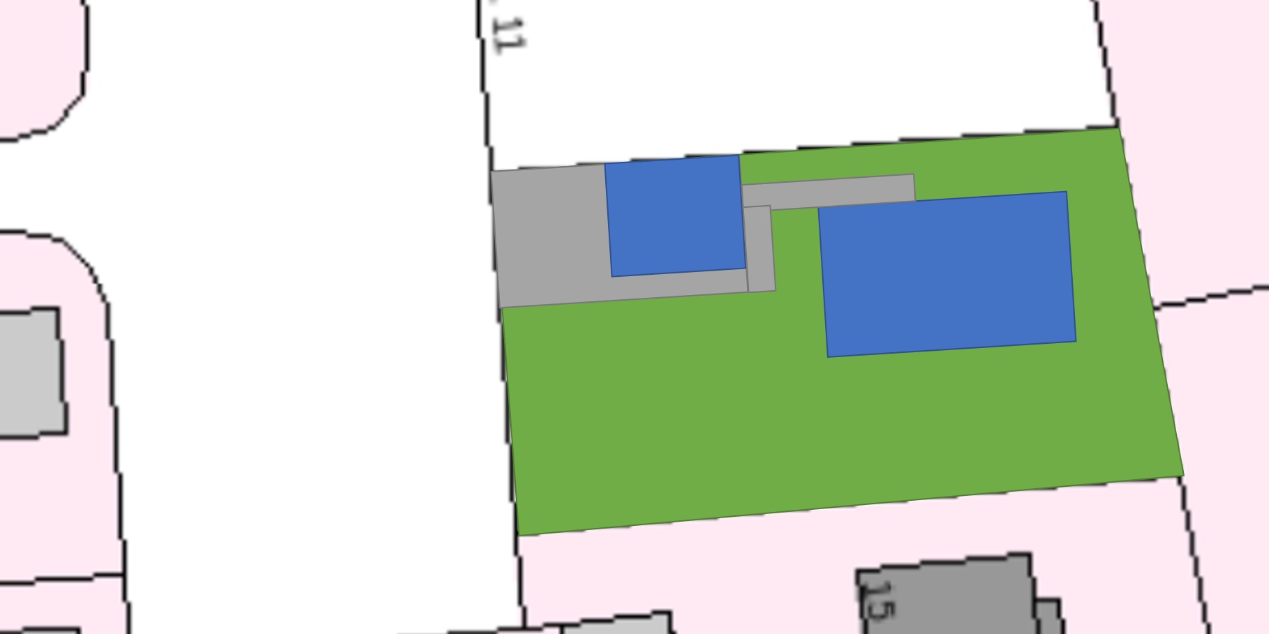

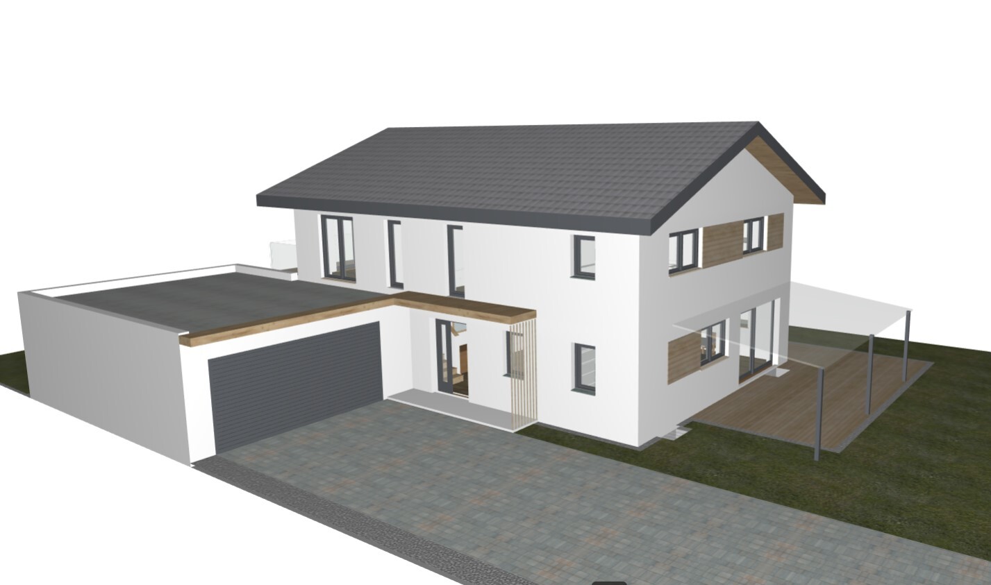

The plot is oriented from west to east, approx. 39 m long and approx. 21 m wide. The house has the same orientation (currently 9.5 m wide, 13.5 m long). We like the garage on the north directly at the house. This keeps the west of the garden nice and free. To the south at 4 m distance is a neighbor’s house, but to the west there is no house yet (lots of evening sun). The garage is directly at the house because we did not want to build over the west area with a garage but rather have a maximum free view. Otherwise, my wife is a teacher (office as home office).
What is the most important/basic question about the floor plan summarized in 130 characters?
We would be interested in the opinion of other builders. Is there a flaw in the plan? Does something not make sense? Is something too narrow? For example, we hope that the space in the dining room is sufficient (3.50 m between south window and kitchen block; but this should also be the passage to the terrace).

Does the garage have to or should be connected to the house? If not, maybe something like this: If yes, with the generous budget one could also imagine a partially underneath-the-house garage. And that strange balcony worm-like extension on the east side could be replaced by a roof terrace on the garage in the west.

That was also my first thought. There is indeed the desire to keep the west free, but for that, the south is sacrificed (4m of space is nothing). I would rather try to create some more room in the south (especially since the fireplace and living room are there). If instead of a solid garage, a somewhat airier carport is placed in the northwest, you also gain a bit more privacy towards the northern property. Perhaps the house could also be rotated 15-20° clockwise?

Overall, I like it. However, I consider the workspace in the kitchen to be insufficient.

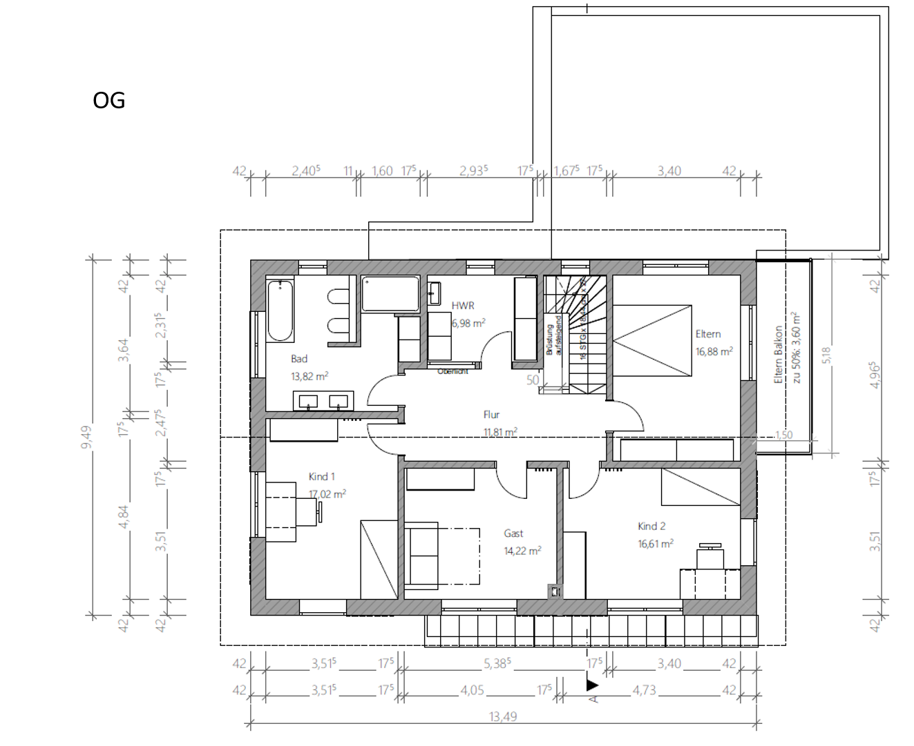

How does the wall structure of 42 cm come about? – the so-called "emancipated" arrangement of the load-bearing walls (which seem overdosed to me here) will make the structural engineer’s head really smoke. And of course, I once again see plenty of planned botch-up spots. The sliding doors running in the walls also do not seem optimally planned to me. In my opinion, the kitchen is too small, and the bedroom balcony as well as the living room projection are expensive jokes. I recommend, although by no means "everything is bad", a replanning (and in doing so the separation of the building bodies "house" and "garage").

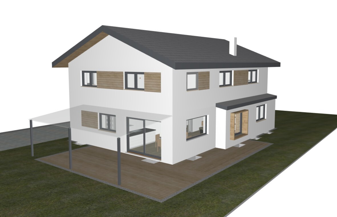

Was the house bulged out according to the needs? In the living room, to have more space in the hallway, and in the office, because otherwise there would be no space.
These are cost eaters and areas where moisture can get into the ground floor medium-term. It doesn’t have to, the architect or the construction supervisor will probably veto it anyway, as long as the house gets built and lasts 5 years ;)
Personally, I also see such bulges as a relaxation of the facade, here I see no added value. To me, it looks arbitrary, especially the narrow bay window on the south side.
Rather, I would translate the upper floor somewhere as a curtain, then you would have a natural canopy.

Still: despite the pantry, the working surface in the kitchen is too small. In my tidy two-person household with storage space in the utility room, I have about half again as much and had to add on for the cooker hood and Diet+Dat … so it will never be enough.
Who is the shower on the ground floor for? It’s so alone without a bedroom.
Who is the guest room upstairs for? Since you have no overnight guests, is it a placeholder room?
Did the balcony upstairs come about by chance or what is it for?
What I find really unpleasant are the light wells everywhere – also where you plan a terrace or/and a terrace door.
You definitely plan that differently because it’s not nice. They also look quite arbitrarily placed... a straight 5 with stars.
I rather see the storage room on the ground floor as redundant because you have a pantry and a large wardrobe where shoe polishing equipment could also fit if necessary. Since laundry is done upstairs, it makes sense to have it up there.

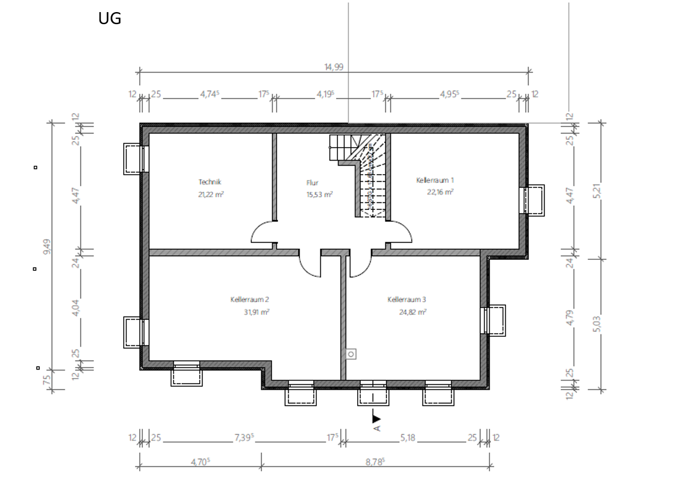

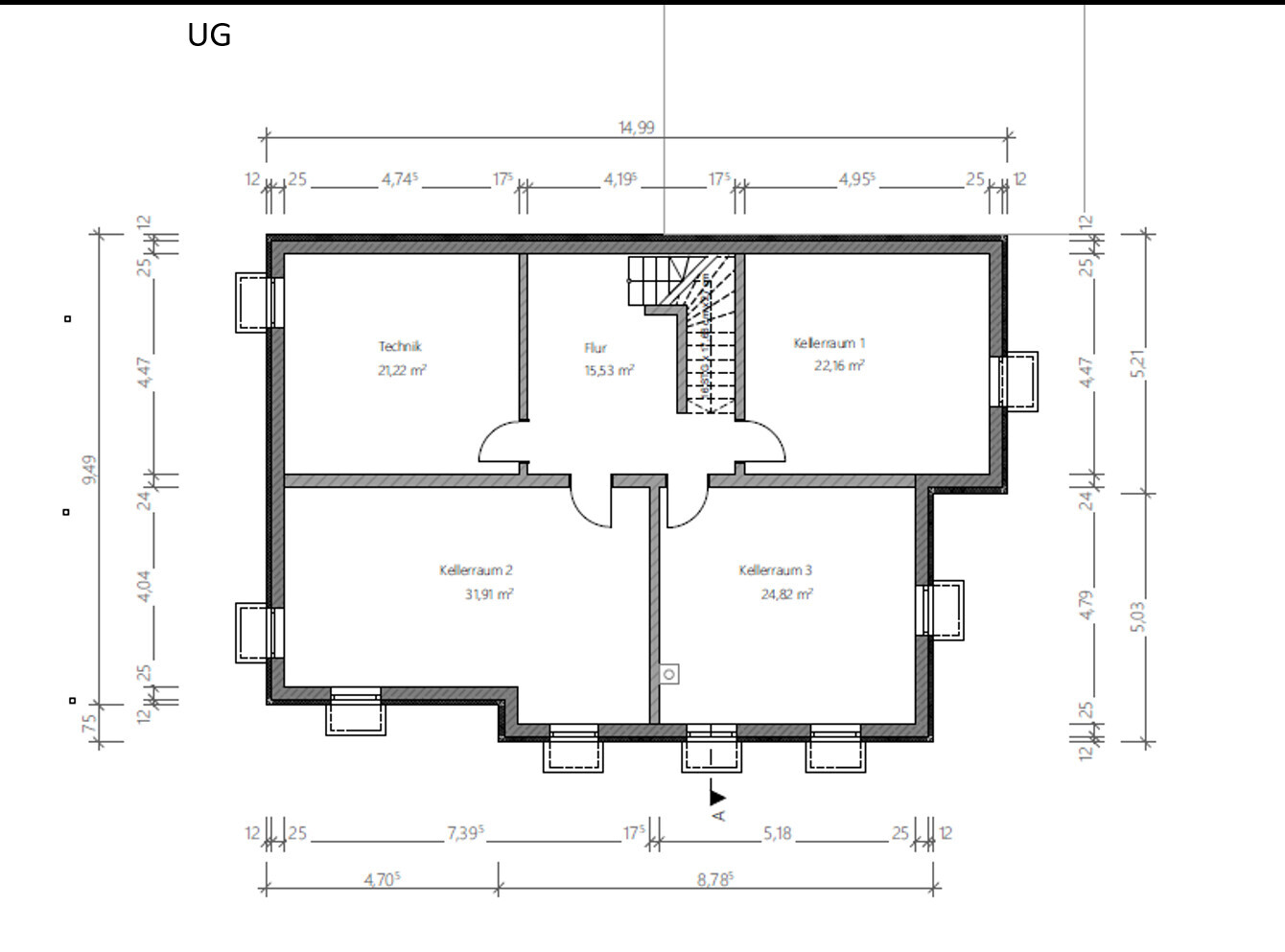

What is the basement even for? I would do without it, adapt the house size a bit there where you need less or a bit more. But everyone has to decide about the basement themselves – some build only because they have too much junk.
And yes, I would also do it like , because glued-on garages always look so blocky. If you link them with the house, you also get a good technical and vehicle storage room there.
If the basement remains, then I would also plan a nice big light well in the basement for a great common room or the office there.
