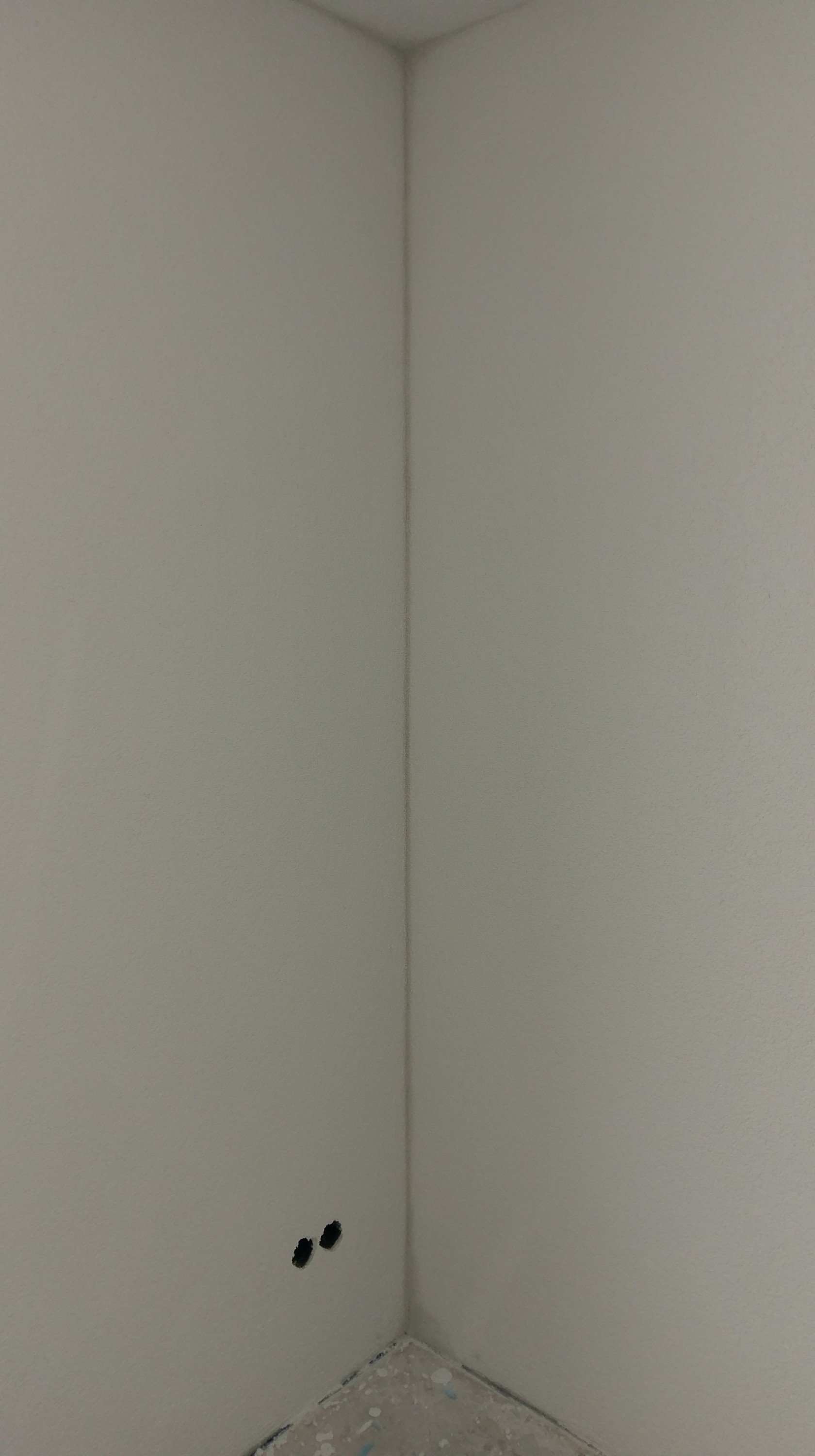

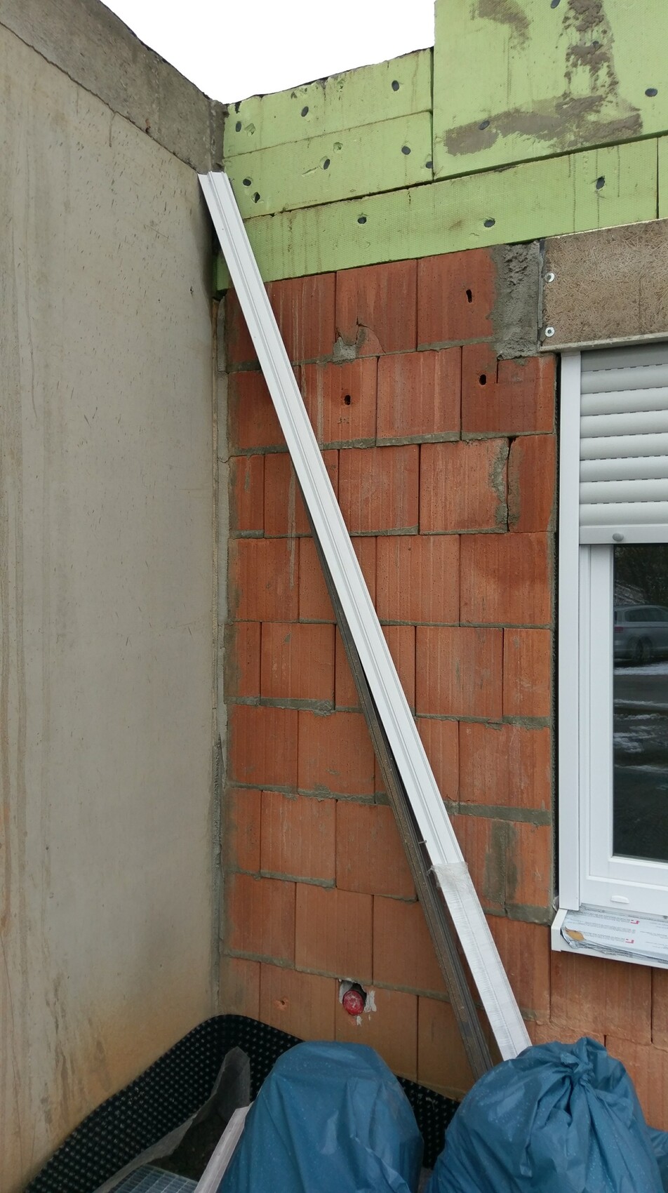

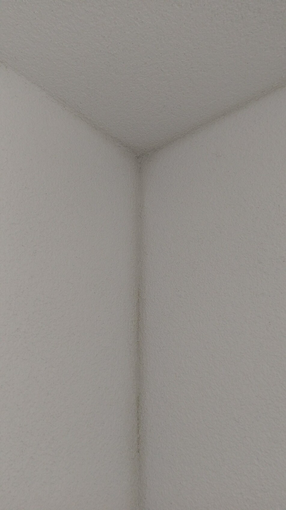

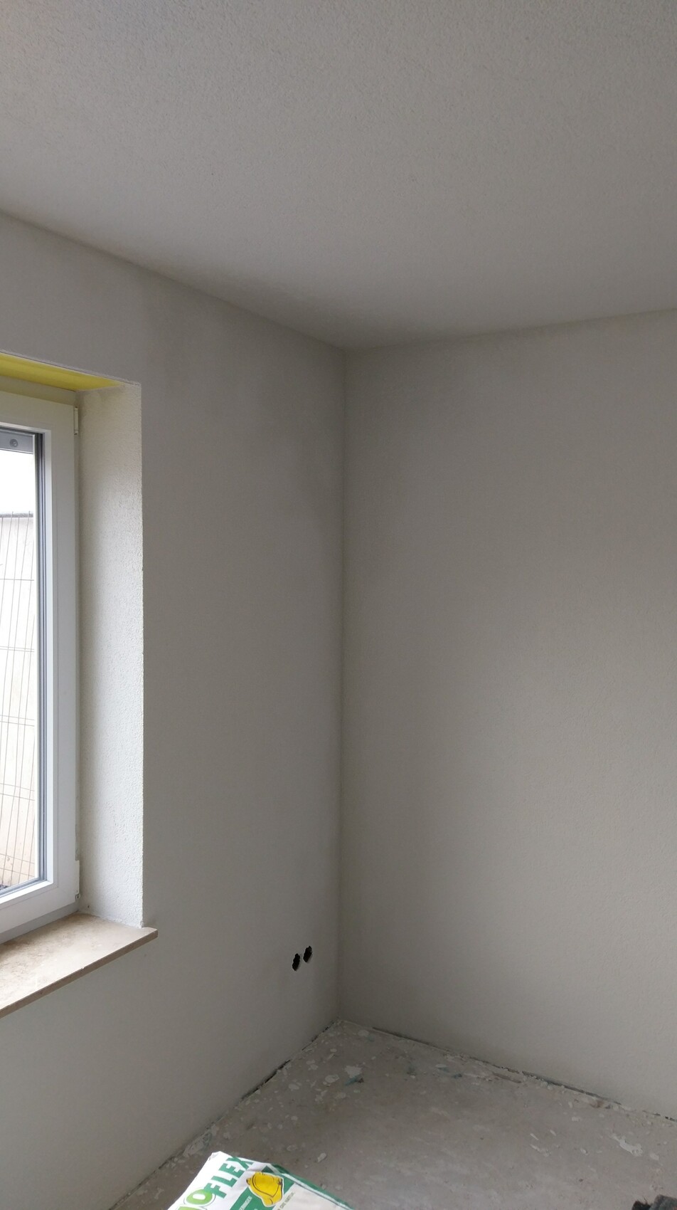

Good evening,
Our new building is underway and the interior work is in full swing. The underfloor heating has been running for about 5 weeks.
We built with Winnerberger t 10 36.5 without additional facade insulation. 3 of the 4 walls are underground because we have a hillside location.
Where the brick wall meets the concrete wall, the indoor temperature at the corner is about 10 °C (outside temperature 1 °C).
The remaining walls are about 15 °C.
We measured for the first time today. I will do this daily now.
What do you think, do we possibly need to insulate the exterior facade after all?
From my point of view, that would be a clear planning error, wouldn’t it?

Ever set up a construction dryer before? Corners dry last ;)
Marchonisch
2017-12-10 20:24:16
  • #3
Yes, at the beginning when the basic cleaning was done. For about 4 weeks. But do you think the temperatures are OK?
lastdrop
2017-12-10 20:26:47
  • #4
I think you cannot meaningfully measure temperatures in exterior corners in winter in the new building as a shell with missing exterior plaster.
Marchonisch
2017-12-10 20:38:12
  • #5
Probably not clearly worded, I measured from the inside. In other words, the values from my first post are all from the inside.
lastdrop
2017-12-10 21:47:44
  • #6
Yes, understood already.
