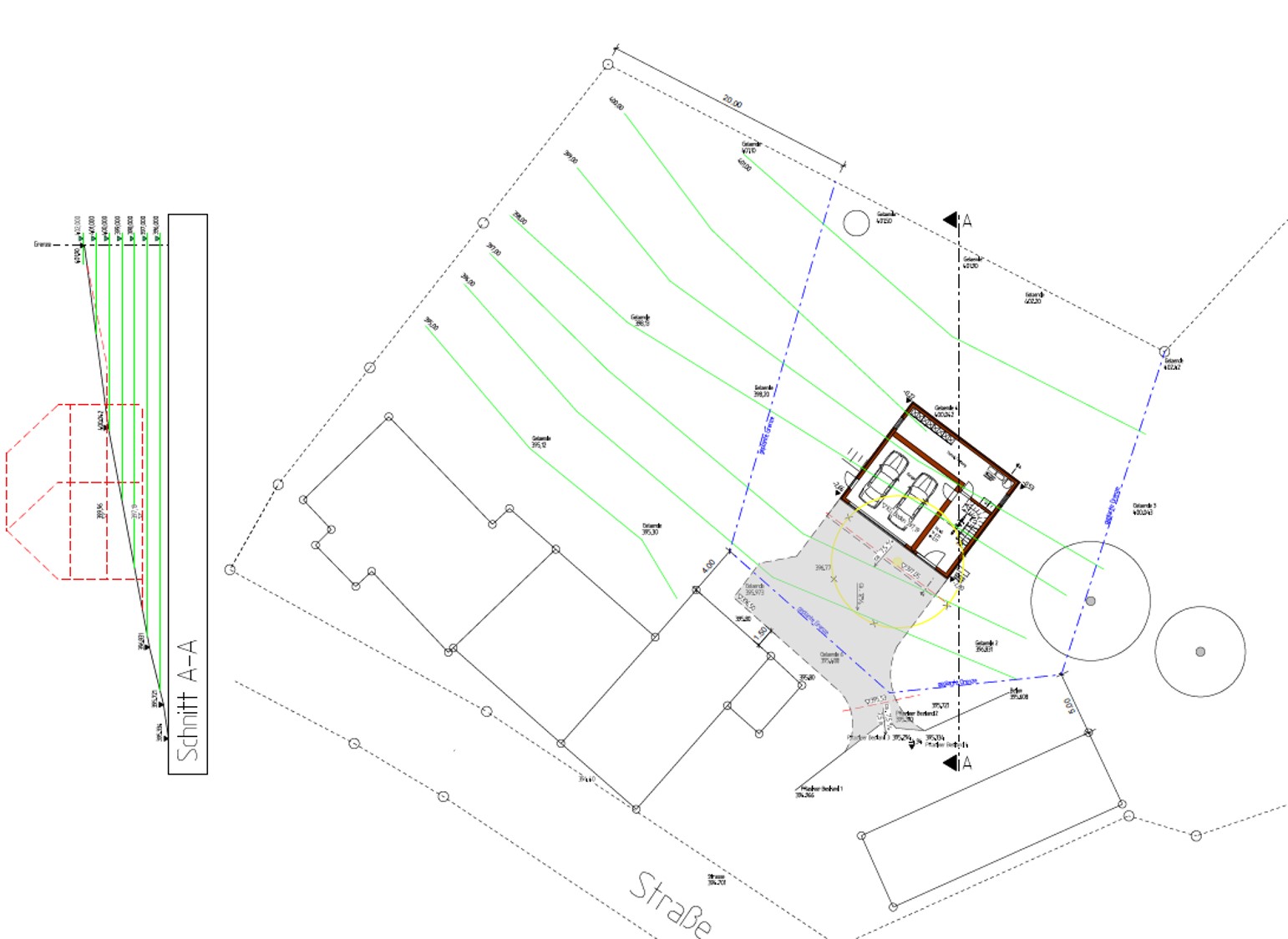

I would be very grateful for your comments and suggestions on the information below and look forward to your feedback. Also appreciated is whether the cost framework seems realistic for a rural area in northern Bavaria.
The construction will take place on my parents’ property, so I do not have any costs for land acquisition.
Development plan/restrictions
Plot size: approx. 1000 m²
Slope: incline of 10.4° / 18.4% in the area of the construction project
Floor area ratio: no development plan
Floor space index: no development plan
Building window, building line and boundary: see site plan
Edge development: no
Number of parking spaces: 2
Number of floors: 1.5-2
Roof type: gable roof
Style: classic-modern
Orientation: according to slope + parallel to existing buildings
Maximum heights/limits: none
Other requirements: none

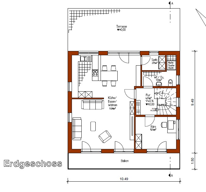

Hello, thank you for your introduction. Can you please upload the [EG] again? It cannot be opened.
ChL1234
2020-12-25 02:33:30
  • #3
Hello ypg, I have uploaded it again, it should work now. Best regards

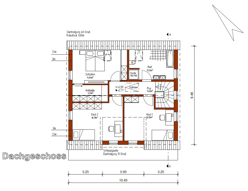

Hello, I basically like it too. What I would reconsider is the layout in the bathroom and the dining area. It seems a bit small to me?

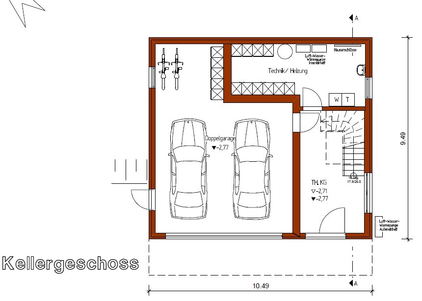

I would also plan the wardrobe in the basement; I am not sure where you would like to have it.
On the upper floor, I would also plan a door from the dressing room to the hallway. Or assign the dressing room directly to the bedroom.
