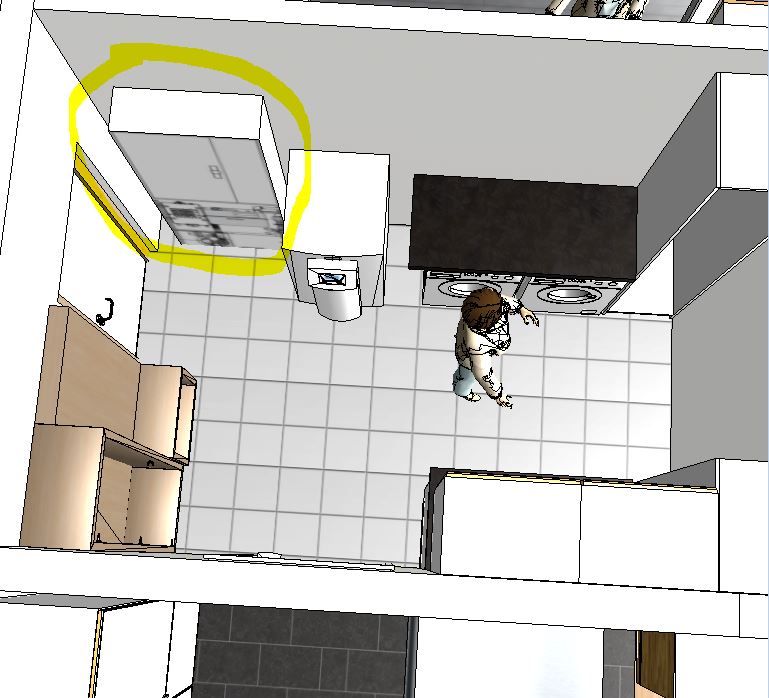

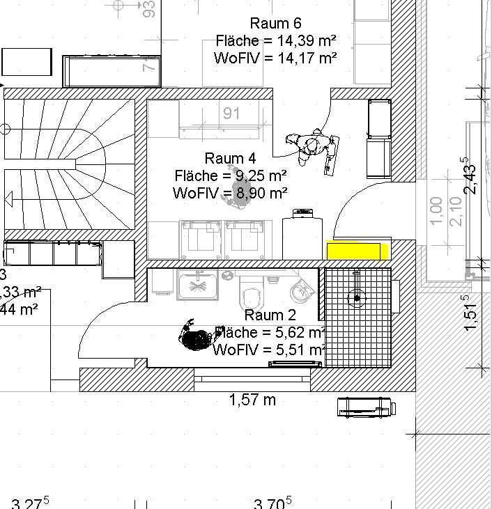

Hello everyone,
I am currently planning the multi-utility introduction in our utility room. I would like to install it in a space-saving and non-intrusive way. The furniture and doors, etc. are not finalized yet. However, the room will not adjoin any outer wall. There will be a separate side door to the garage. I would like to have the MSH installed behind this door. At the same time, I would then hang the electrical box above it.
Does anyone have a similar setup? Is this feasible without problems? How much space should be left approximately?
We are building without a basement. Connections for electricity, water, telecom, reserve.

For us, it was a requirement that NOTHING is below the electrical box. I had planned a water connection and the washing machine there, but then they would have refused to approve it. Placement behind the door should not be a problem, but you should clarify whether the electrical box can be above it!

1.60m in front of the meter cabinet and nothing underneath. House entry under the water distribution is okay. The house connection box for electricity and telecommunications must also go somewhere.

And the water meter also has to find space. Seems a bit too tight overall.
