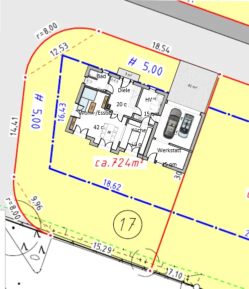

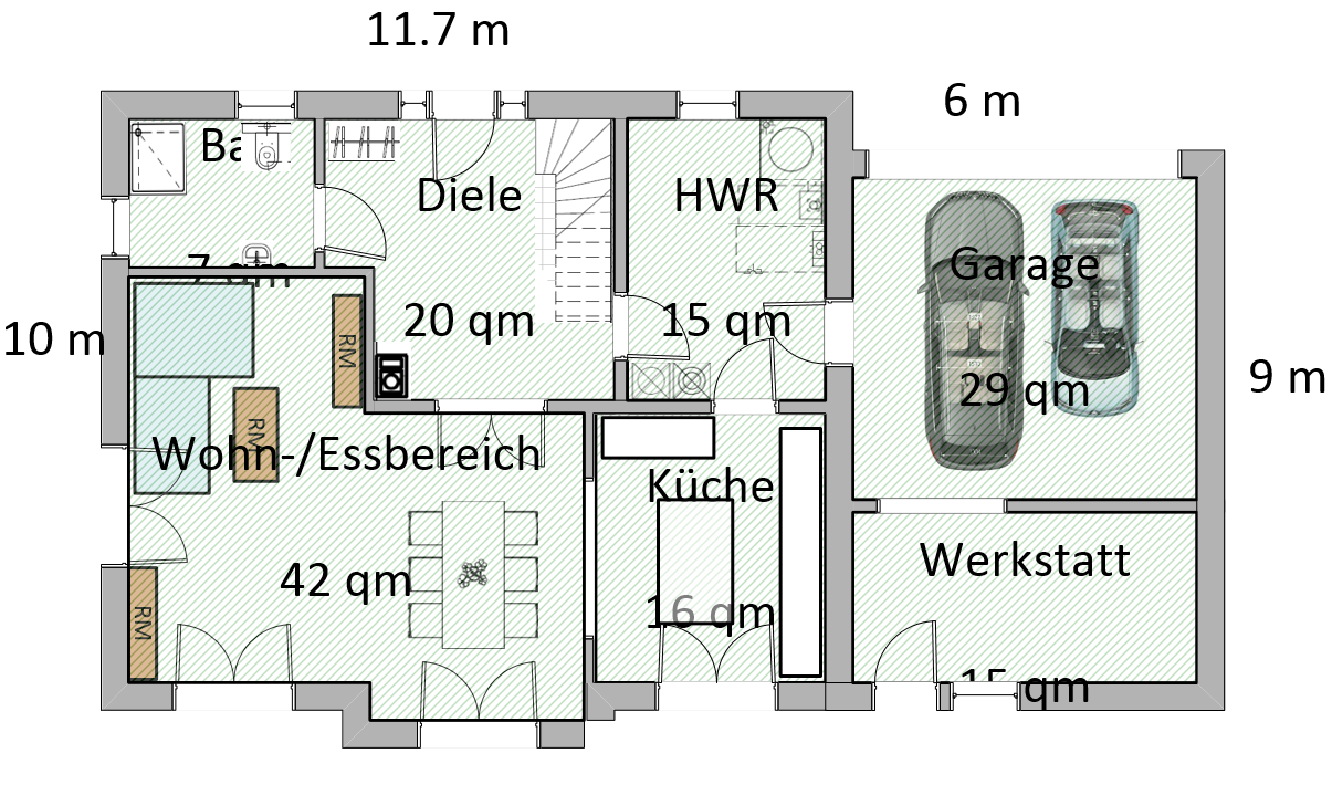

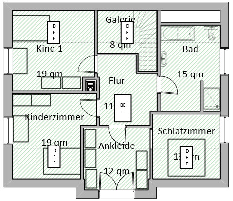

Hello everyone,
We are currently planning a new construction project in Bornhöved and would like to get your unfiltered opinion. Attached is the completed questionnaire.
Development plan/restrictions
Plot size: 723 m²
Slope: No
Floor area ratio: 0.25
Floor space index:
Building window, building line and boundary: see drawing
Edge development: Yes, with ancillary facilities, max. 9 m
Number of parking spaces: 2
Number of floors: Open construction
Roof shape: Open construction
Style: Open construction
Orientation: Open construction
Maximum heights/limits: 9 m
Other requirements
Builders’ requirements
Style, roof shape, building type: Gable roof with captain’s gable
Basement, floors:
Number of people, age: 4 persons, 2 adults (32) and 2 children (0+3 years)
Room requirements on ground and upper floor: 3 bedrooms on the upper floor
Office: Family use or home office? No office currently planned
Guest sleepers per year: 1-2, no guest room required
Open or closed architecture: Half/Half --> Planned double sliding door between kitchen and living/dining area
Conservative or modern construction: Conservative
Open kitchen, kitchen island: yes
Number of dining places: Dining room, counter at kitchen island
Fireplace: yes
Music/stereo wall: no
Balcony, roof terrace: no
Garage, carport: Double garage
Utility garden, greenhouse: no
Other wishes/special features/daily routine, also reasons why this or that should or should not be included: Sliding door from kitchen to dining room so the kitchen can be closed off if needed (at Christmas), when eating.
House design
Who created the design:
- Do-it-yourself
What do you particularly like? Why? Gallery in the staircase which gives the hallway below more space and brightness. Tiled walk-in showers, no more cleaning windows
What do you not like? Why? Position of the chimney flue in the hallway downstairs
Price estimate according to architect/planner:
Personal price limit for the house, including fittings:
Preferred heating technology: Gas with solar thermal for domestic hot water, underfloor heating
If you have to do without, which details/extensions
- Can you do without:
- Cannot do without: The gallery has already become quite firmly established
Why has the design turned out the way it is now?
A mix of many examples
What makes it particularly good or bad in your eyes?
Pleasant size of the utility room, garage and the rooms. We also like that there is always another room between the children’s rooms and the bedroom.
I find the orientation needs improvement, as the garage is located in the southeast and sunlight comes relatively late into the living area.
What is the most important/basic question about the floor plan summarized in 130 characters?
How can the floor plan be optimized regarding sun orientation and the placement of the chimney flue?
