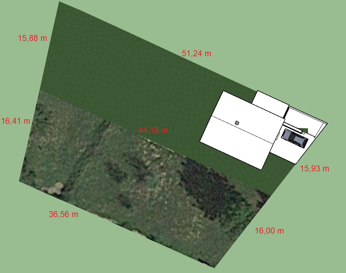

Hello,

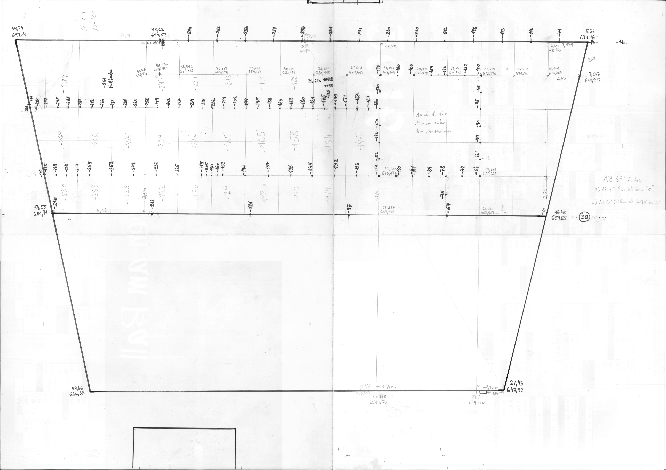

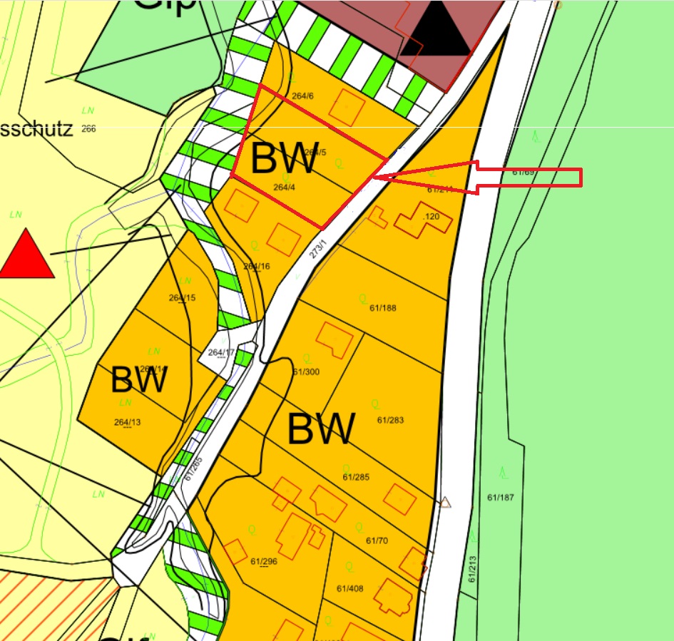

we have two plots of land near Vienna. We plan to build on the northern plot, the southwestern plot will be kept as a garden and will not be developed. The plots are located on a gently sloping hillside. The access road is very quiet and leads to 10 other houses before it turns into a forest road.
We plan a single-family house with approx. 145m2 of living space and the possibility to expand this in a further step by converting the half-basement if more space is needed. It is important to us to have a cost- and energy-efficient construction method without bay windows, excessively high ceilings, etc.
Development plan/restrictions
The plot is located in Lower Austria near Vienna.
Plot size – 739 m2, the southern plot with 643m2 also belongs to us and will be used as a garden (not built over)
Slope – yes – approx. 270 cm (see attached detailed plan, the official elevation plan is currently being created)
Floor area ratio – 25% of the plot area and 10% of the plot area for ancillary buildings
Floor space index – does not exist
Building window, building line and boundary - Half the building height, but at least 3m building setback front, rear and on the sides of the plot, only ancillary buildings (garage, carport, shed…) may be erected in the building setback / In open development, a lateral building setback of ancillary buildings must be kept free
Edge development - Ancillary buildings may have up to 100m2 footprint (total) and a height of 3m (on a sloping site, this height may be exceeded downhill)
Number of parking spaces – 2 parking spaces / plot access – max. 7m width / carport and garage in the front building setback with a minimum distance of 1m to the street / depth of garage and carport max. 12m / street-side front of carport and garage max. 7m
Number of floors - max. 2 floors + basement
Roof shape – no specification
Style – no specification
Orientation – no specification
Maximum heights/limits – 9m at the highest point, or max. 8m average per side (measured from existing level)
Further requirements It is possible that we will have to cede approx. 55cm to the municipality on the street side.

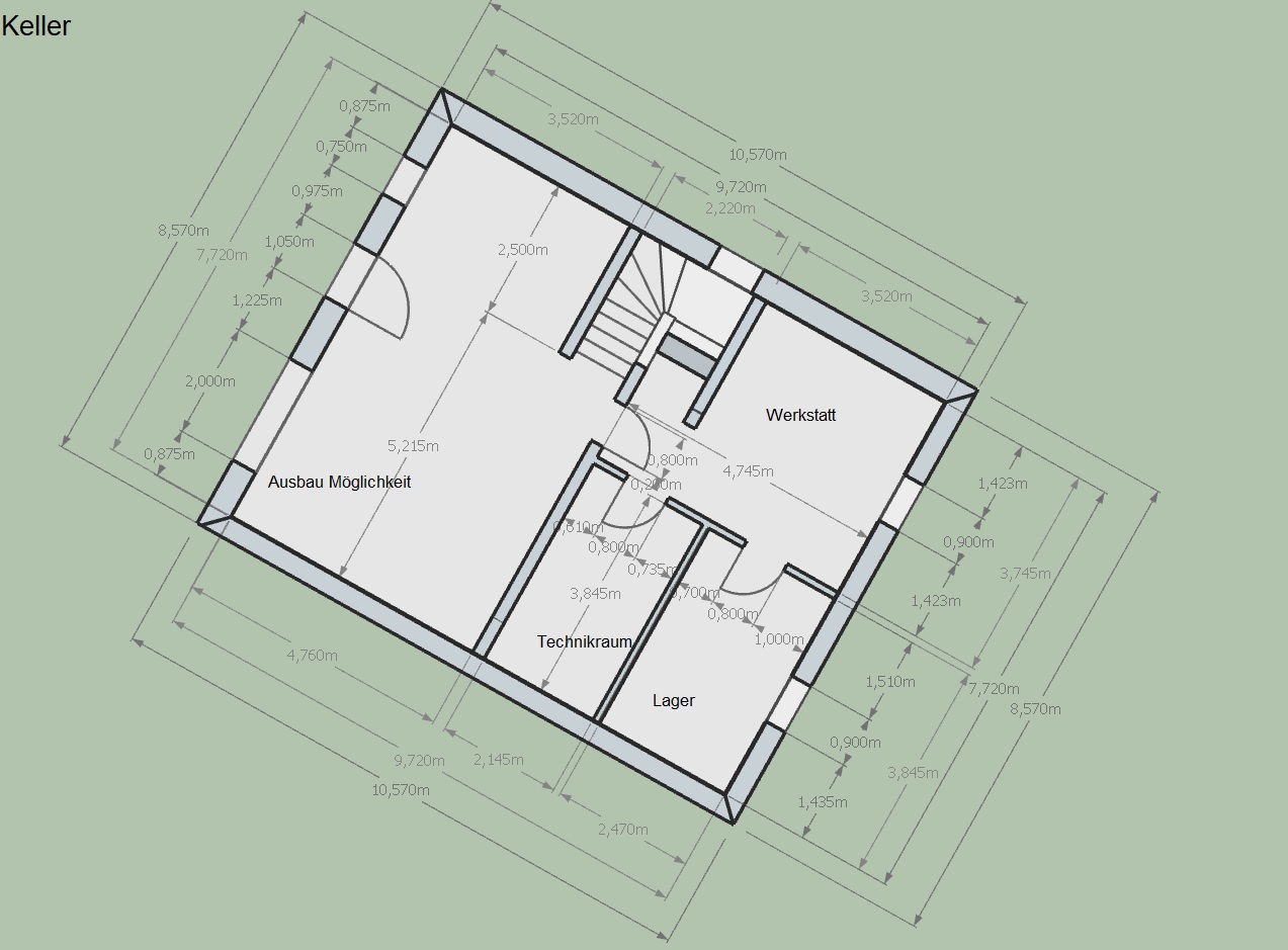

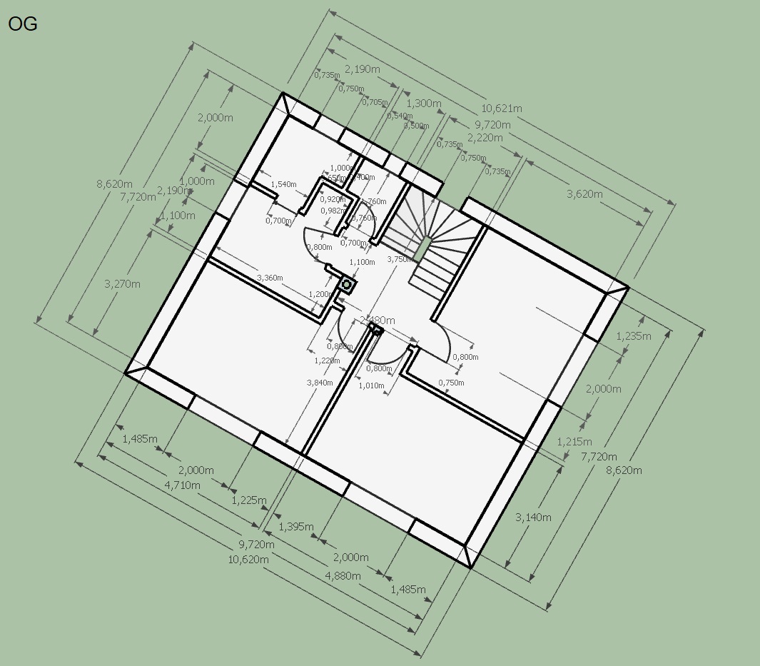

Upper floor

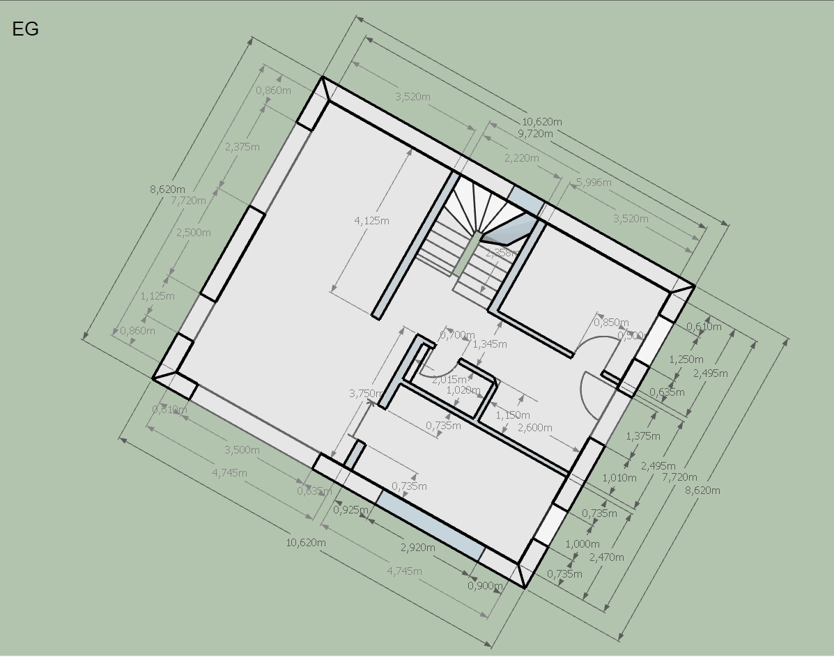

Ground floor
Basement

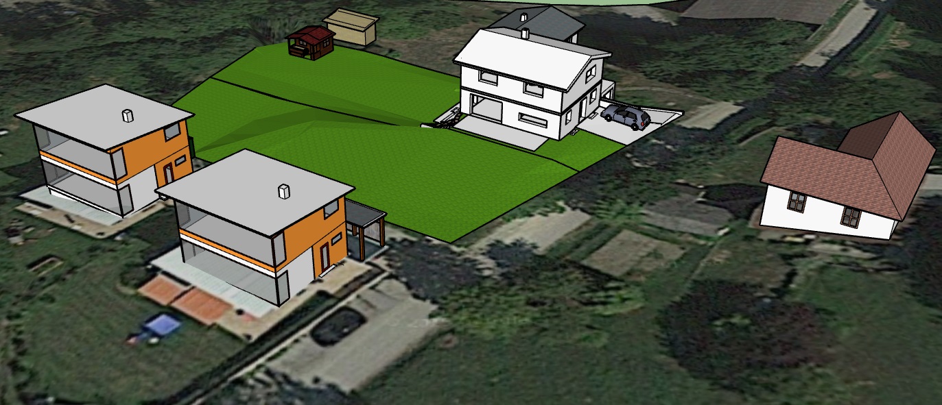

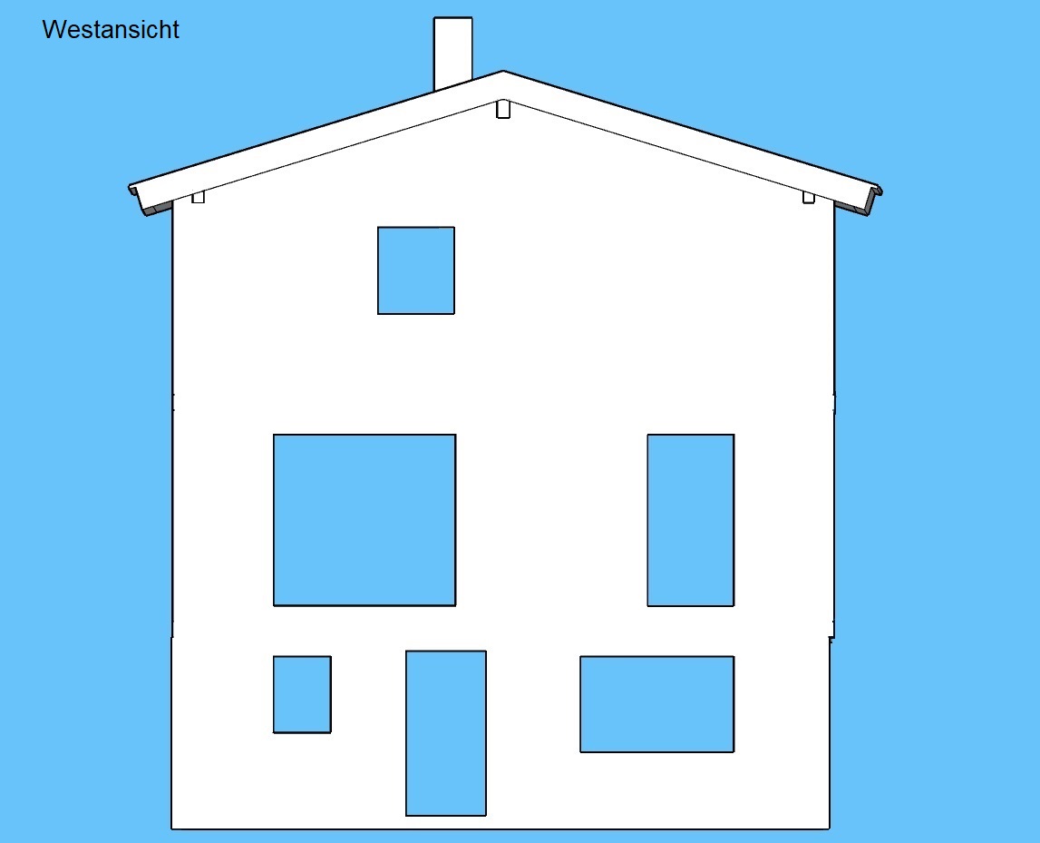

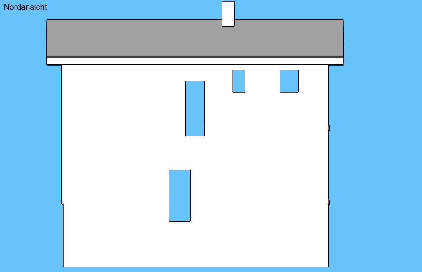

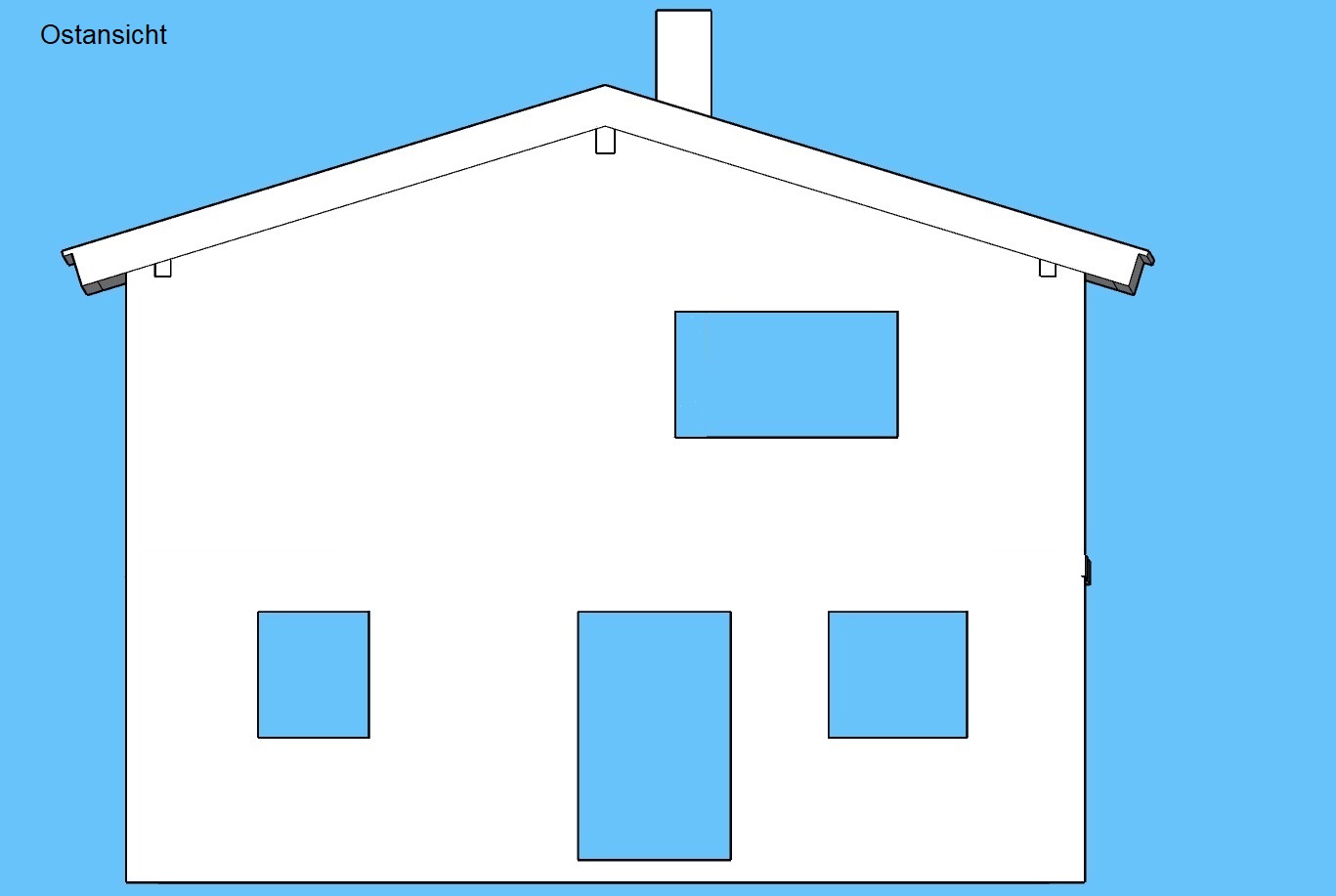

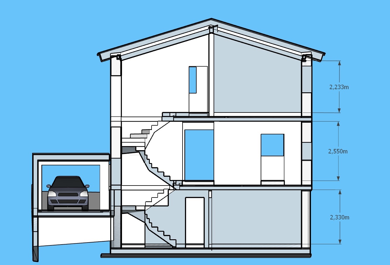

Why is the design the way it is now?
The plot has a slope, so the habitable basement is recommended so that the house entrance (ground floor) is at street level.
Due to the height difference and the narrow width of the plot, the gable roof with a knee wall of 2.2m was planned to increase the building width and still comply with the setback (half the building height).
Since there is no neighboring plot to the west and thus an unobstructed view is guaranteed, we placed the living room to the west (the basement is accessible from the garden on the west, which means the living room has no garden access). The dining room/kitchen is located to the south, as the garden is accessible at ground level here. From the kitchen you have a view of the south garden and can keep an eye on the children and go directly to the outdoor dining area.
The garage access is located halfway between the basement and ground floor and is connected to the house by a door.
The office serves as a retreat.
In the habitable basement, the illuminated part can be expanded in the future to a fitness area/guest room/office or possibly an additional children's room, or the third room on the upper floor can be used as a children's room and the master area moved to the habitable basement... Since the backwater level of the sewage pipe is at street level and the sewer does not run below the basement level, no sewage pipes are planned in the basement so that no lifting device for sewage is needed.
On the upper floor, we placed value on the three rooms of equal size with at least 16m2, so they can be swapped and for example also be used as an office/guest room instead of a children's room. Since we currently have the toilet separate from the bathroom and this is very practical, we have implemented this in the house as well. The utility room will be mainly used for washing laundry and storage of cleaning utensils (ironing is done in the living room) and has the advantage that laundry piles can be hidden behind a door. Neither the toilet nor the utility room is adjacent to a room (noise disturbance) and no water pipes are planned in the wall towards the children's room.
Corresponding/which wishes were implemented by the architect? n/a
What makes it particularly good or bad in your opinion?
The slope of the site was well incorporated into the design due to the habitable basement. Despite the narrow plot, a good house width could be achieved.
After weighing our requirements and wishes, the most important elements could be implemented.

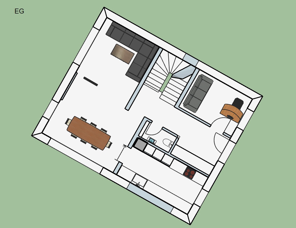

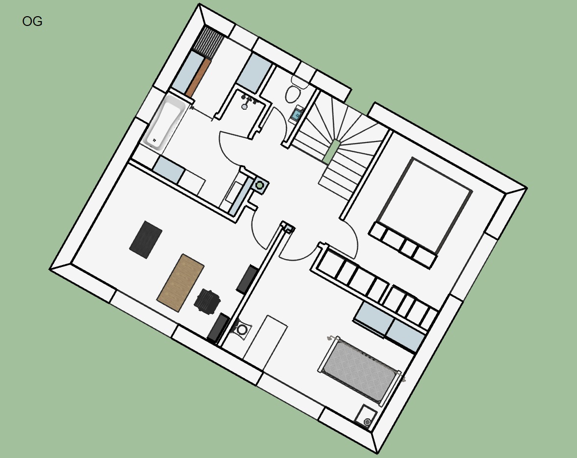

What do you particularly like? Why?
Upper floor
[*]Bathroom/WC separate
[*]Separate utility room for washing/drying laundry (because drain in basement only possible with a pump and washing can be done where it occurs)
[*]WC and utility room not adjacent to rooms, therefore less noise disturbance
[*]All rooms are the same size (at least 16m2) – rooms can be swapped
[*]Children's rooms facing south
[*]Master bedroom facing east to be woken by the sun.
Ground floor
[*]No open kitchen, but with a view of the dining table when the door is open
[*]Living and dining room not separated
[*]Living room with view over the west garden

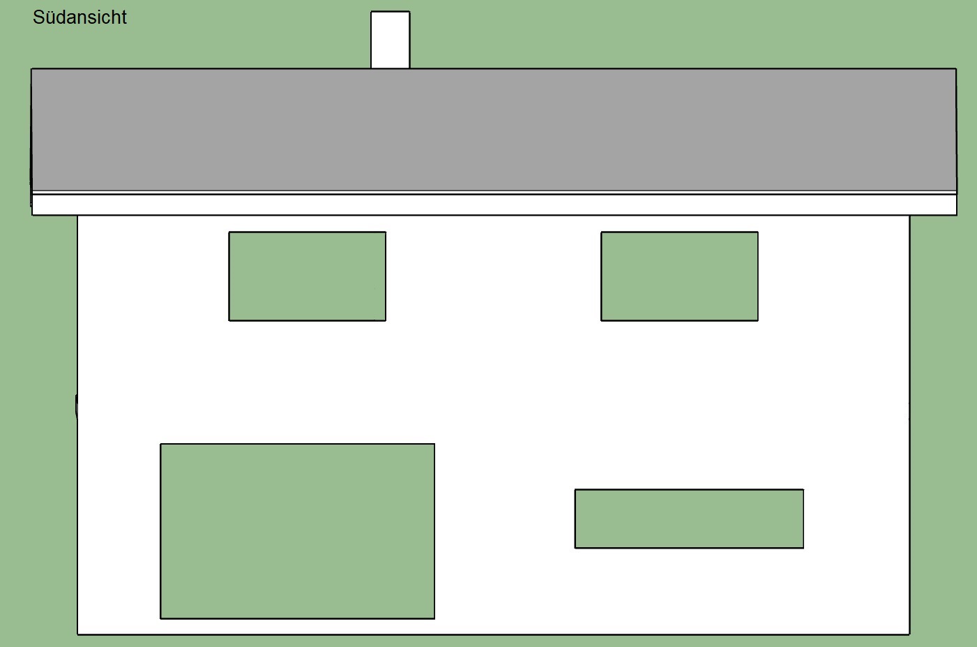

[*]Dining room facing south and exit to the garden (right next to the kitchen)
Basement
[*]Opportunity to expand, protected location towards the garden
[*]Exit to west terrace
What do you not like? Why?
Upper floor
[*]Access to utility room through bathroom
Ground floor
[*]Window in office facing carport
What is the most important/basic question about the floor plan summarized in 130 characters?
We ask you for your opinion on our floor plan? Please include constructive improvement suggestions.
