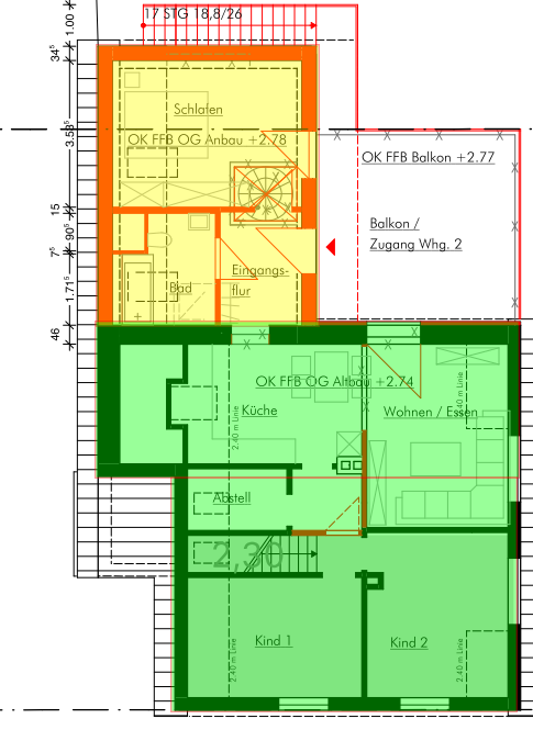

Good day dear community,
we have been renovating our house (old building) for about 1 year and have created a granny flat. This is located entirely on the upper floor and extends over the main house (marked in green, see attachment) and an extension (marked in yellow, see attachment). In the yellow-marked extension there is no screed but only the raw concrete ceiling. In the main house there is already screed. Therefore, there is already a height difference of about 2-4 cm between the two areas. In the extension, we have a buildup of 16 cm at the lowest point (so the meter mark is currently at 116 cm), other spots in the extension are at 14 cm. In the main house, the highest point is at 12 cm (so meter mark at 112 cm).
It is now planned to install underfloor heating in both areas and new screed on top of it. We are now wondering how to best proceed. Basically, I have two questions, one about height compensation between the two areas and the other about the general buildup.
Height compensation: Since the floor in the old building is very uneven (partly 2-3 cm difference), we wanted to use a leveling fill first in order to have a flat surface between the extension and main house. That way we have a consistent height everywhere.

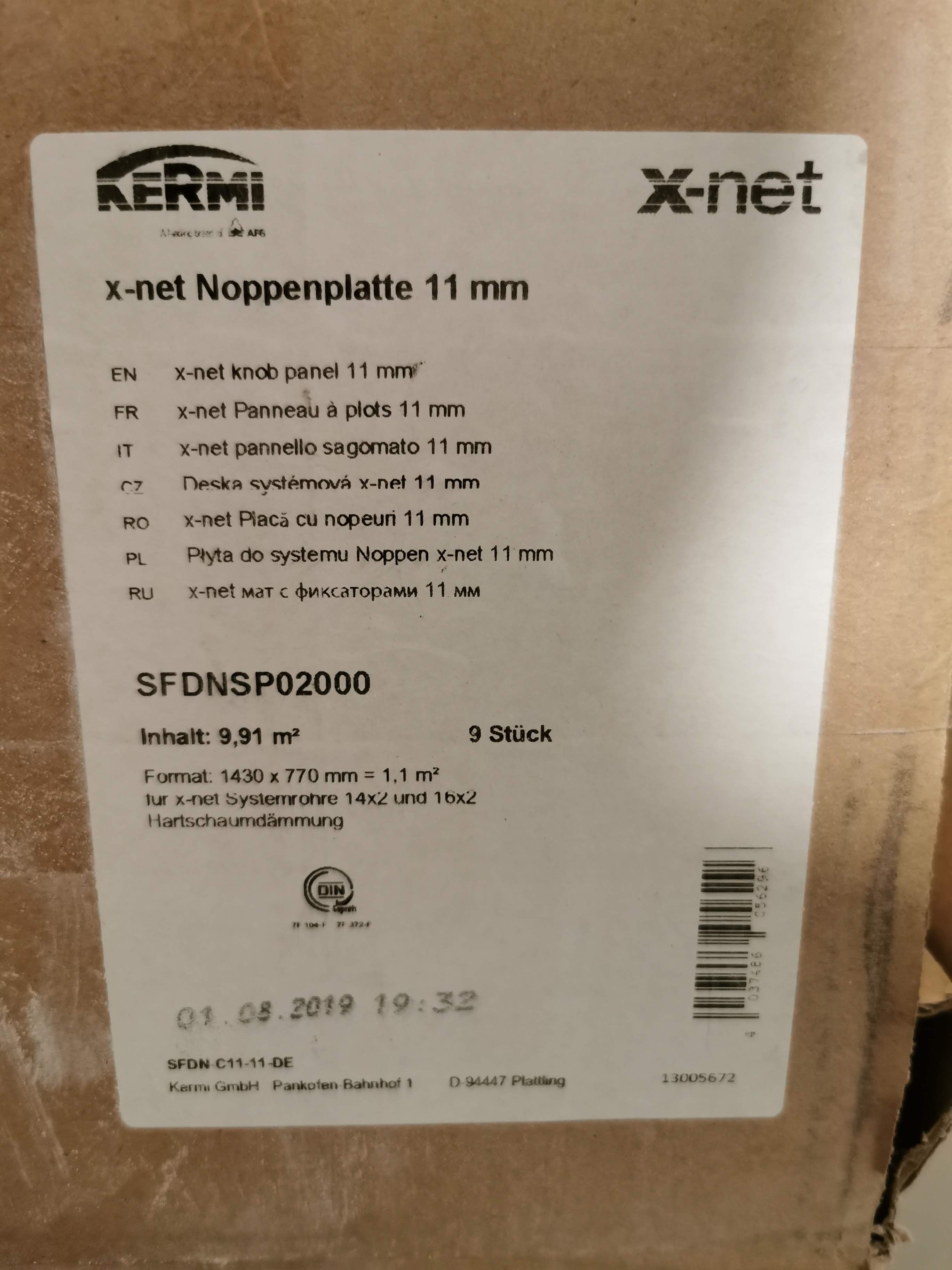

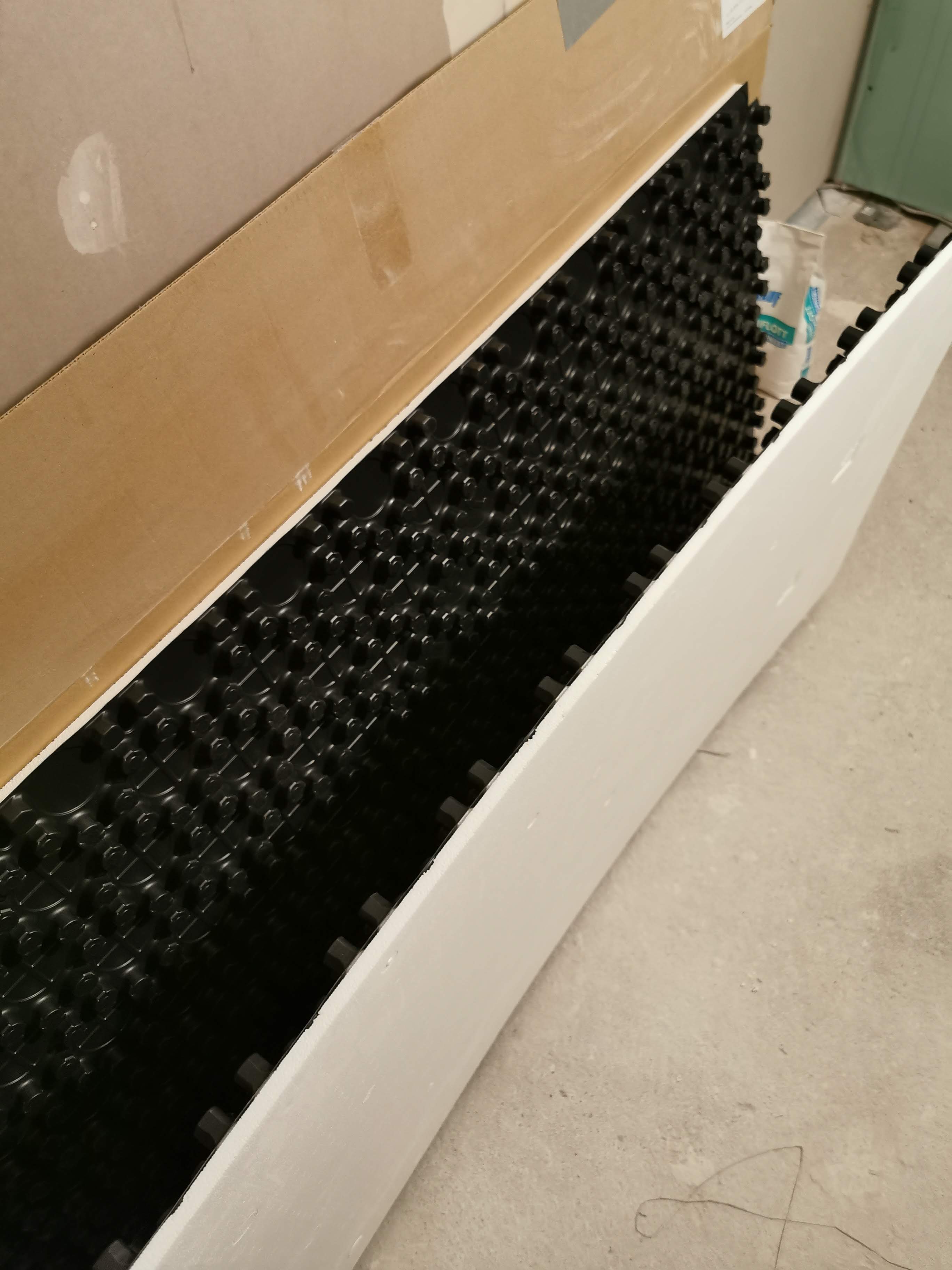

Buildup: We now have about 12 cm floor buildup. The studded plates of the underfloor heating are 32 mm, plus screed and the floor covering. The floor covering will probably be vinyl; we still need to find out the thickness. Either way, something must still be installed under the studded plates of the underfloor heating to reach the required 12 cm. In the extension, we wanted to lay EPS on the fill and then the studded plates (which also have about 10 mm insulation). It is also somewhat easier to walk on the EPS boards when laying the underfloor heating than directly on the fill.

2. Can we lay EPS boards under the studded plates of the underfloor heating in the extension? Which boards are recommended or what must be considered? I remember that you have to be careful that only one kind of insulation or only one layer of impact sound insulation is allowed under the underfloor heating (keyword: give). The studded plates also have a kind of insulation, which EPS boards (or something completely different?) can we use here?
