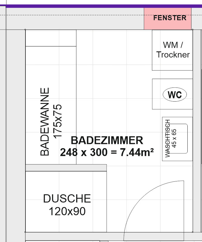

Hello,
I am currently still planning details of the floor plan. Some key data are already fixed due to external conditions.
However, the bathroom is still flexible in size and layout, and even after the 7th redesign I haven’t found one that blows me away :-/
This bathroom is in the one residential unit that I will live in alone.
In all other residential units there will be no bathtub and the bathroom will also be smaller.
I definitely want a bathtub (although it will be rarely used, still).
I also want a large shower. My current 85x85 is definitely too small.
Grab bars next to the toilet and also in the shower as well as next to/at the bathtub should be planned in.
The window faces exactly north. Size and position are still completely free. However, behind it, at a distance of 1.5m, a low technical room will be built (the building will be a kind of garage with a single-pitch or gable roof…). So the view is "blocked"… only daylight entry.
The position of the door is fixed.
Regarding the dimensions: The boxes each have a 50cm spacing, the bathroom is currently planned with a width of 248cm (but I can still adjust that, however the depth of 3m is fixed).
The bathroom should rather not be smaller. I want a cozy bathroom with a certain “room to move”. That’s why I’m afraid that the passage behind the door between the shower and the sink will feel and actually be too narrow in practice …?
