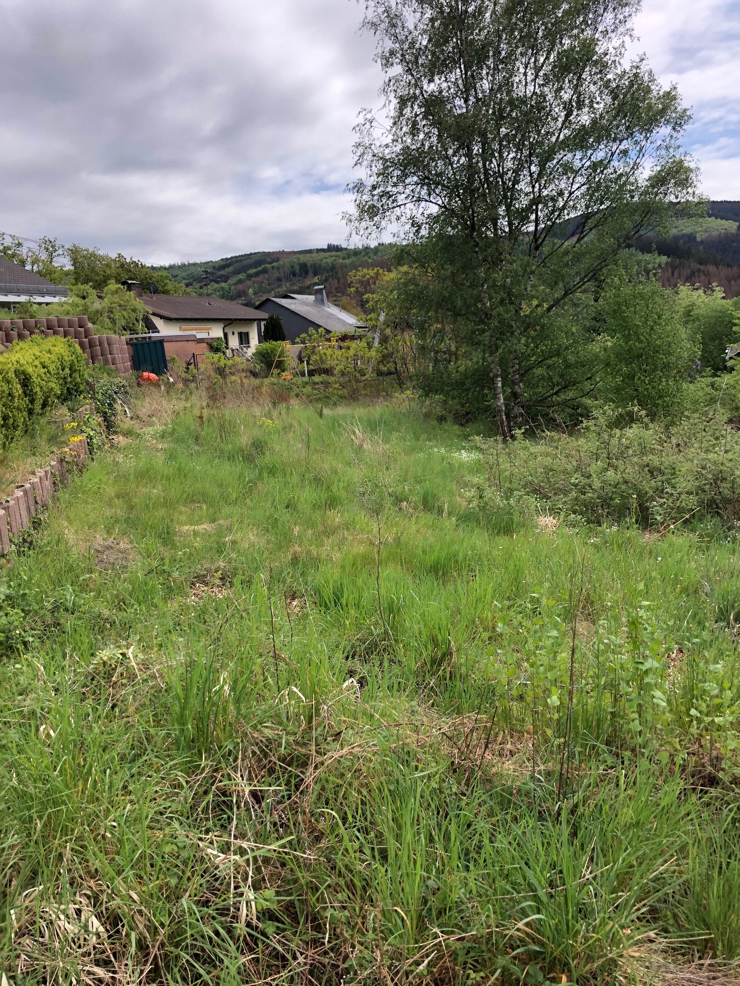

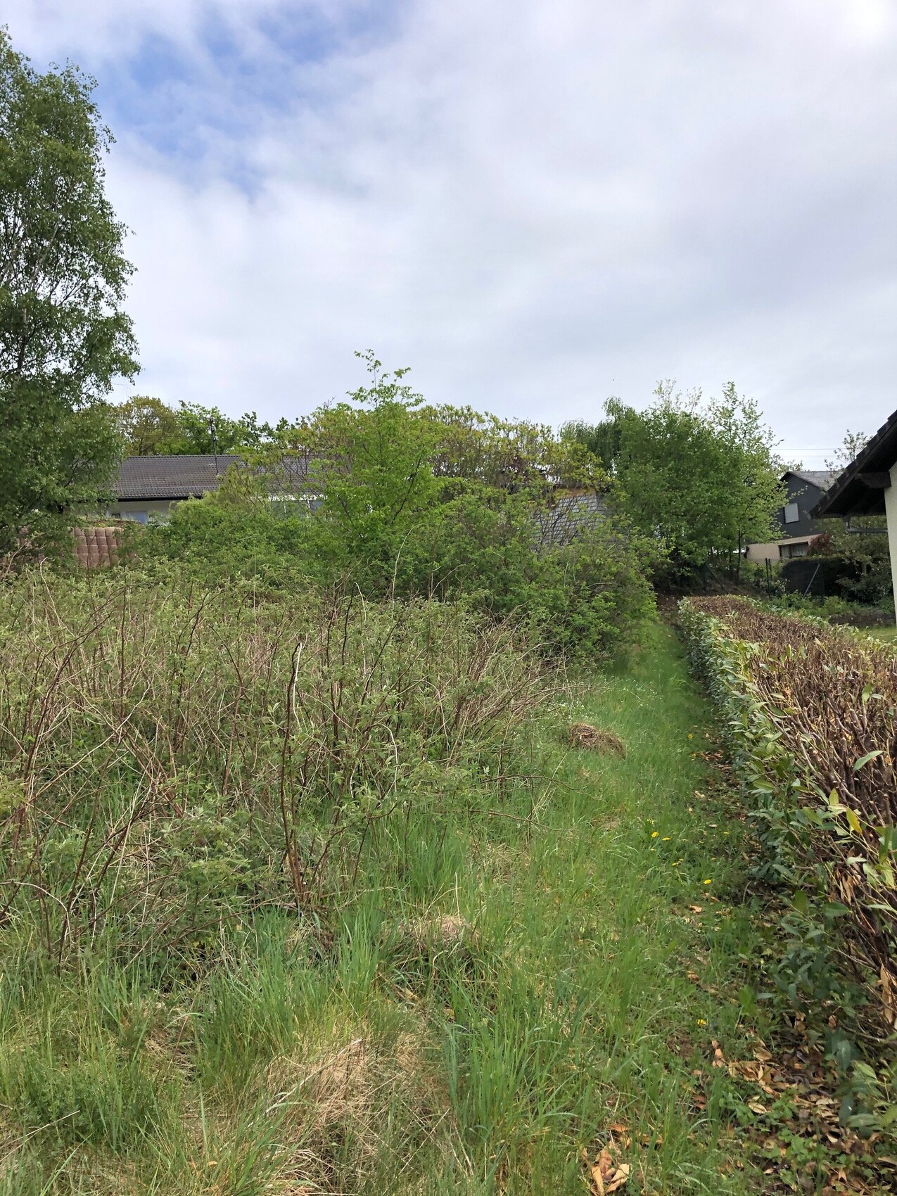

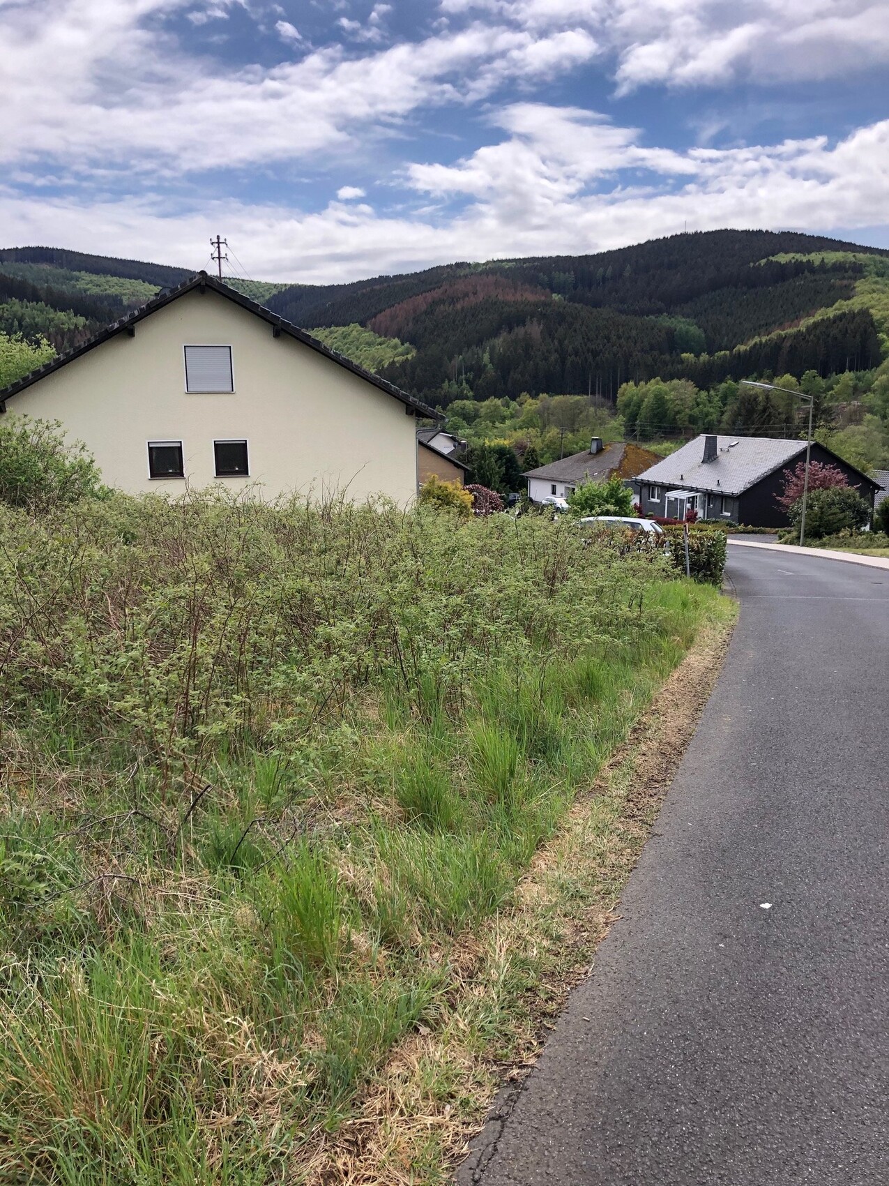

Good evening everyone,
we have recently been considering a plot of land that would be perfect for us in terms of location and on which we would like to build a single-family house. The slope of the land gives me a bit of a headache, as I, unfortunately, cannot assess it at all as a layperson.
We have roughly planned the following budget:
Plot (750 sqm): approx. 55,000-70,000 EUR including additional costs (still needs to be negotiated)
House (approx. 150 sqm) gable roof (turnkey, including painting and flooring): approx. 320,000 EUR
Additional construction costs: approx. 55,000-70,000 EUR (of which earthworks approx. 20,000 EUR without foundation slab)
Outdoor facilities: approx. 15,000 EUR
Total volume: approx. 445,000-475,000 EUR
A garage is not planned, carport optional if there is still budget available.
Basically, we would like to build without a basement; it would still be possible for the lower floor to be partially in the slope. However, since I really cannot assess the plot at all and it depends on whether a basement/lower floor in the slope/just a foundation slab is necessary, I would like to have a few assessments.

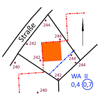

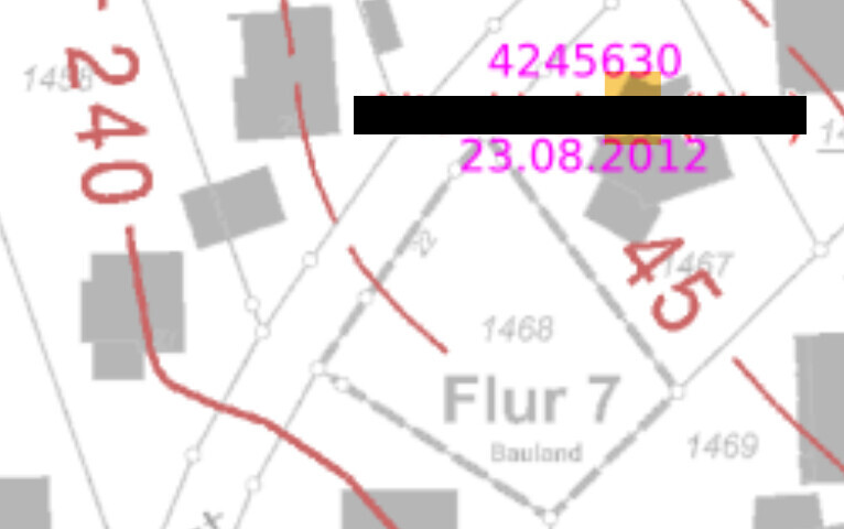

Attached are the floor plan including contour lines (red) as well as a few pictures that I took. It concerns plot 1468. A soil survey has not yet been conducted but would of course be done if it becomes concrete. At first, I am really only interested in a rough assessment of what would be feasible at reasonable costs and what makes no sense at all.
Thank you in advance for your assessments.

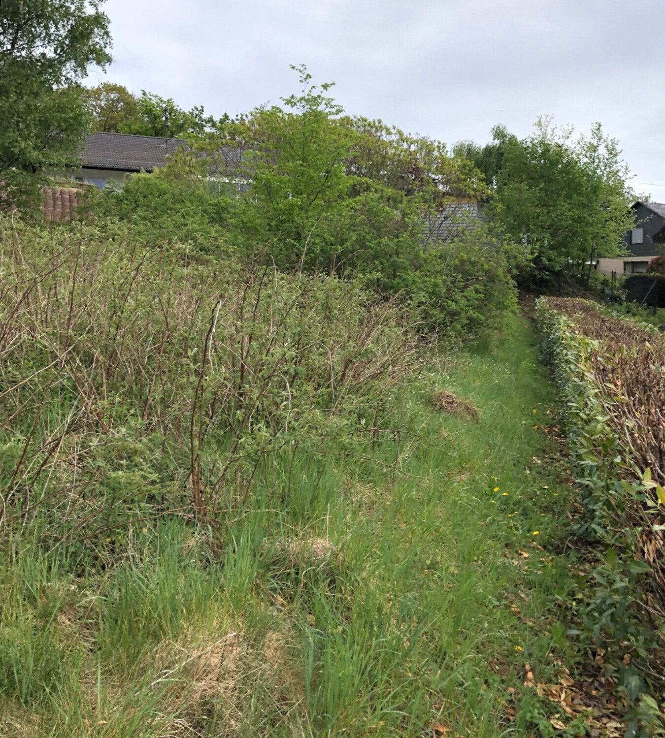

A plan helps against headaches: [ATTACH alt="Lageplan.png" type="full"]46422[/ATTACH] A 2m height difference within the house footprint suggests a basement. To the left, right, beside you, behind you, in front of you you can already see it ... all with half-buried cellars, or better with a lower ground floor. Pictures without a spirit level are more confusing than helpful. Here is picture 1 after rough leveling: [ATTACH alt="IMG_3889_gerade.png" type="full"]46423[/ATTACH] The slope location is more clearly visible; in the end local height measurements are needed because the neighbors have apparently done a lot of landscaping.
