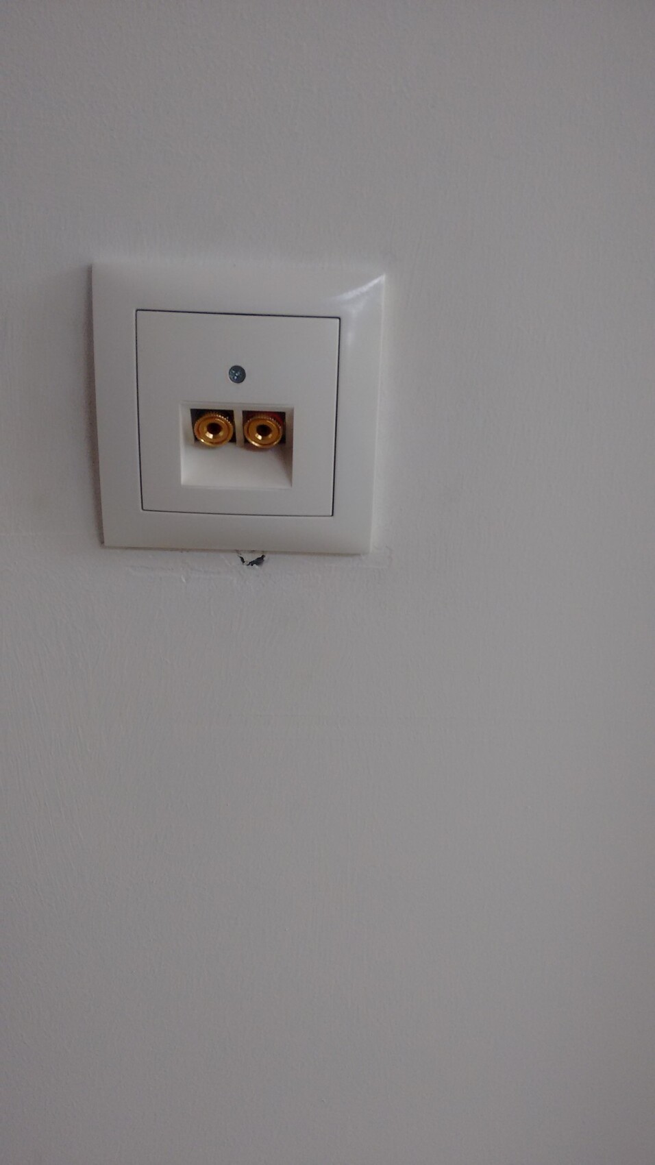

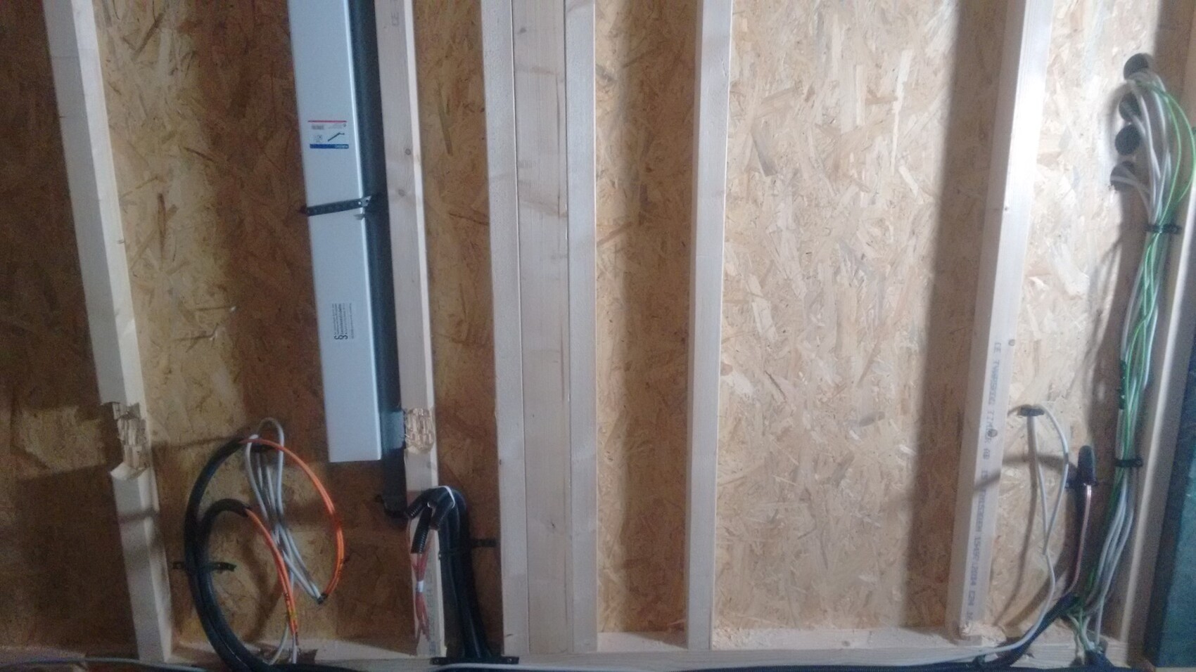

I installed a 50x110cm empty conduit for ventilation in the wall for the TV cables.
I implemented the speaker outlets with DIGITUS DN-93831-1 Keystone front plates and DELOCK Keystone binding posts 86303 (for banana plugs). For this, in our case, the Berker UAE cover 14098989 was used. Unfortunately, the binding posts are a bit "thick" and rest on the cover. Therefore, I tricked it a bit and pushed them further into the outlet. Normally, they would stick out more.
I found this solution visually nicer because from the side behind the box you will be able to see the outlet. In my opinion, banana plugs simply make it a bit nicer.

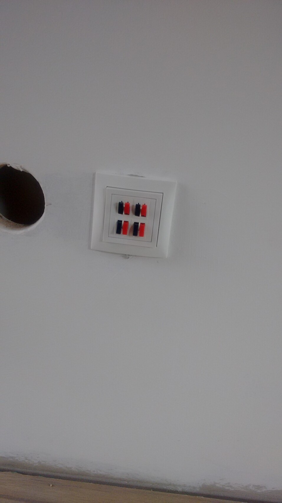

Directly behind the stereo system, however, I used the Gira 4-fold 569403 together with the mounting frame 264803. Of course, it doesn't fit perfectly into the Berker program, but I think it works. For that reason, I don't have that many outlets there.

  • #4
The idea with the Bananas is pretty cool. Jung also has such things directly. They look good visually and I would then only have 2 outputs for 1 circuit breaker.
