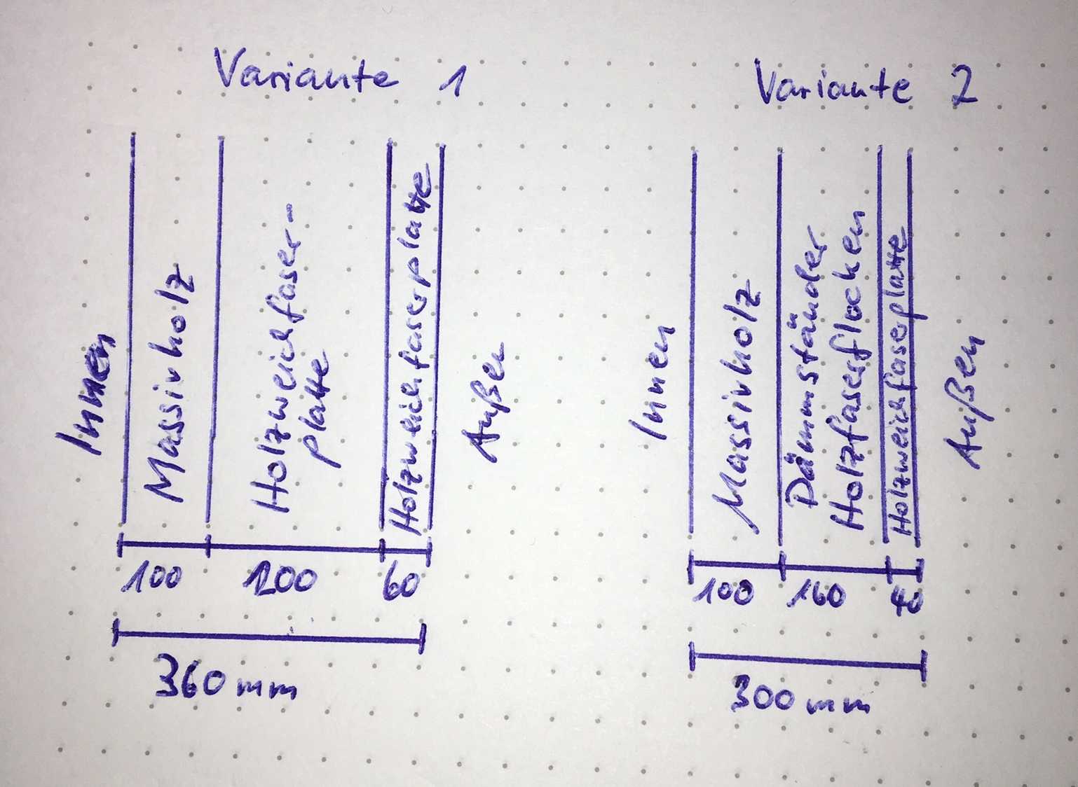

Hello everyone,
We have decided to build a solid wood house.
We now have various offers;
Exterior wall option 1 (very expensive):
100mm solid wood
+ 200mm wood fiberboard
+ 60mm wood fiberboard
= 360mm wall thickness
The provider says this house stays cool and hardly needs heating in winter.
Exterior wall option 2 (very inexpensive):
100mm solid wood
+ 160mm insulation stud (blown with wood fiber flakes)
+ 40mm wood fiberboard
= 300mm wall thickness
Offered with air-water heat pump and underfloor heating
Exterior wall option 3: Lignotrend (mid-price)
110mm cross-laminated timber ribs
+ insulation stud width selectable (blown with cellulose flakes)
Has anyone already had experience with one of these construction methods?
Are there any experts here who recommend a building method?
Thank you all

That is simply the wall construction - the question is whether loose fill or panels?
Does more wall = more insulation also apply to wood fiberboard?

We have a solid wood house.
From inside to outside
Paint + painter's fleece or tiles
Drywall
150 mm solid wood
300 mm insulation banned Neopor.
Reinforcement
Plaster
Passive house
Check out [wir leben Haus].
Not heated for 1 week. Still under construction. Comment from my aunt: nice and warm, are you heating it a bit?

Exactly, at first glance only a 60 mm difference - hence the question of how much this shifts further with plaster or brickwork etc.

Hello, we are currently building a solid wood house using Dübelholz construction: from inside to outside 12.5 mm drywall 100 mm wood 13 mm OSB as a windproofing board 240 mm cellulose insulation 60 mm wood fiberboard Reinforcement and plaster Regards and a Happy New Year to everyone!
