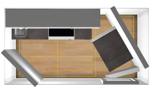

I want this sink here:
Unfortunately, the Ikea planner does not allow me to place it on the 40cm sink cabinet, but it should actually fit (according to the description, the sink is for >= 40cm).

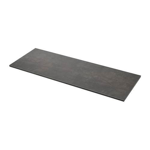

2nd question: I would like this countertop:
The planner also does not allow me to place it, is there a solution or do I need a different countertop?

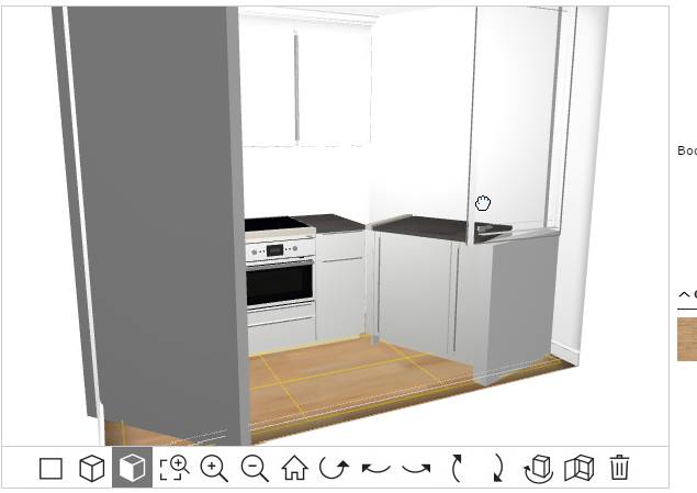

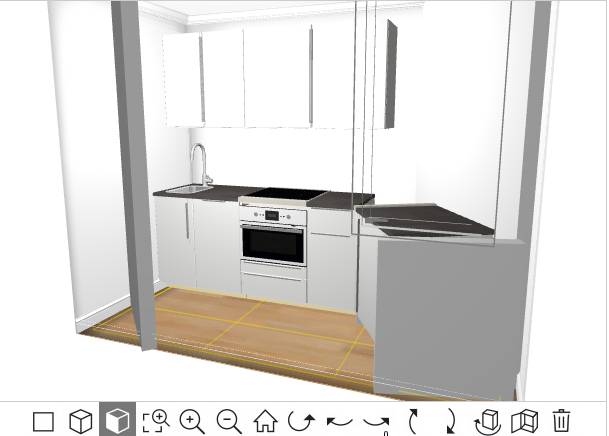

According to the current plan with a 40cm cabinet, it looks like this:

I hardly know the planner. Maybe he does not cut the finished boards to the right length and does that only with the custom-made Personlig boards?
I took a closer look at the sink. It is 37 cm wide, the cutout is supposed to be 1.6 cm less, so 35.8 cm wide. The cabinet has a clear width of 36.6 cm. So it will be very tight. The retaining clips are maybe one centimeter wide, so they are in the area of the cabinet walls. For the countertop to sit properly, it must be milled out at the spots of the clips and the sink must be installed into the countertop before it sits on it. Of course, there will be trouble if the planner just accepts the installation like that.

The point with the plate has now also "been clarified", it probably has to do with the installation depth of the induction hob.
Now I should be able to do something with the datasheets again :-/ - In other words: Now I'm also looking for induction hobs that work with 28mm thick plates..

The problem is not the 28 mm itself, but that you have an oven underneath and the distance becomes too small. If you find a cooktop with a shallower installation depth, it could be so expensive that you would rather choose a 38 mm thick countertop. But first check the manufacturer’s specifications of the selected appliances to see if a 28 mm thick board might actually be sufficient; the planner assumes IKEA appliances.
