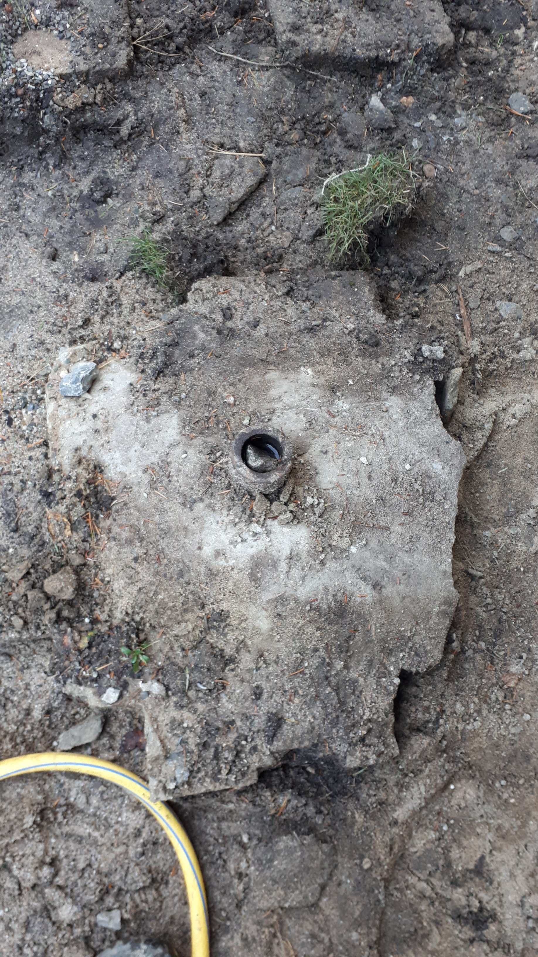

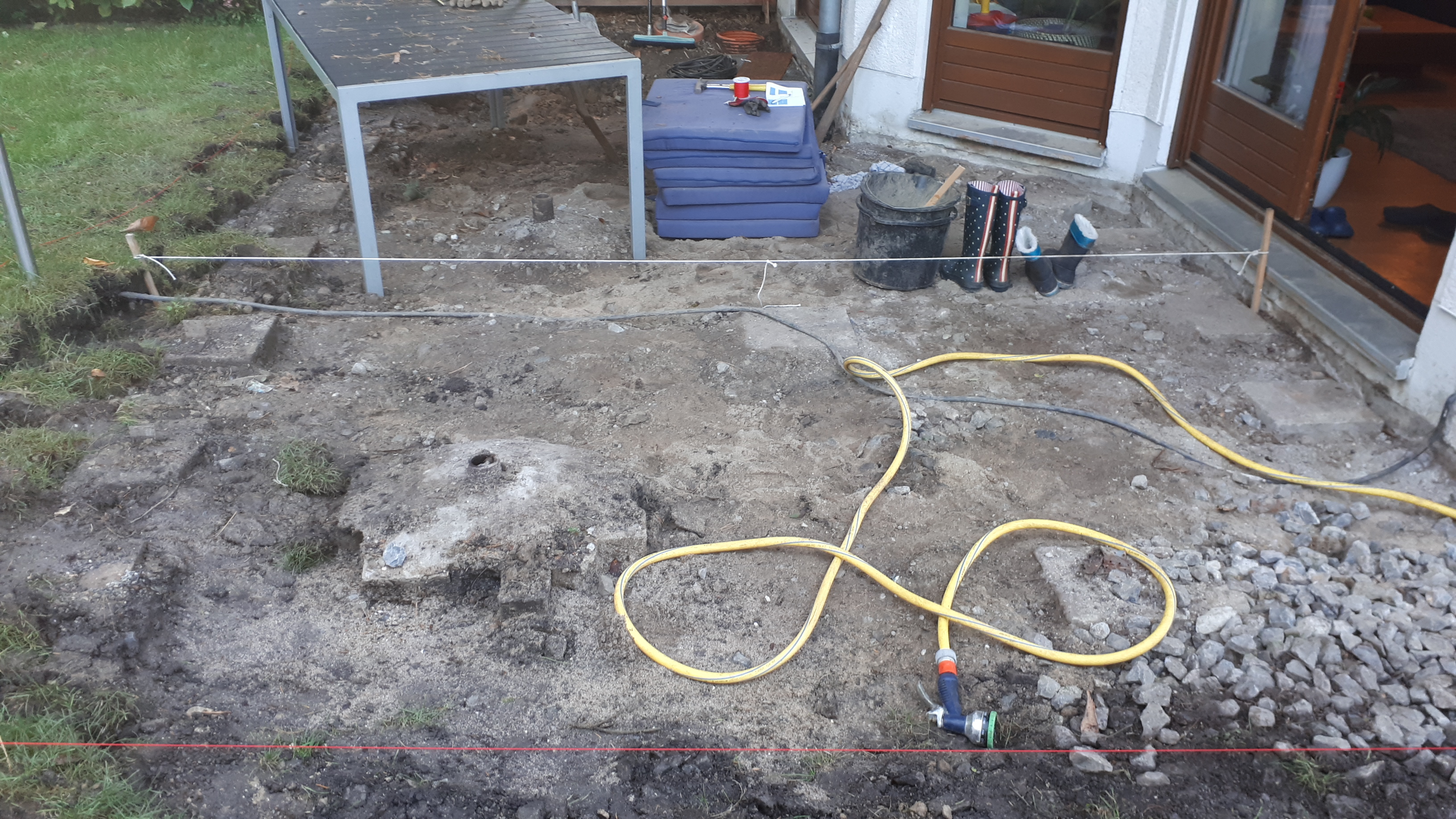

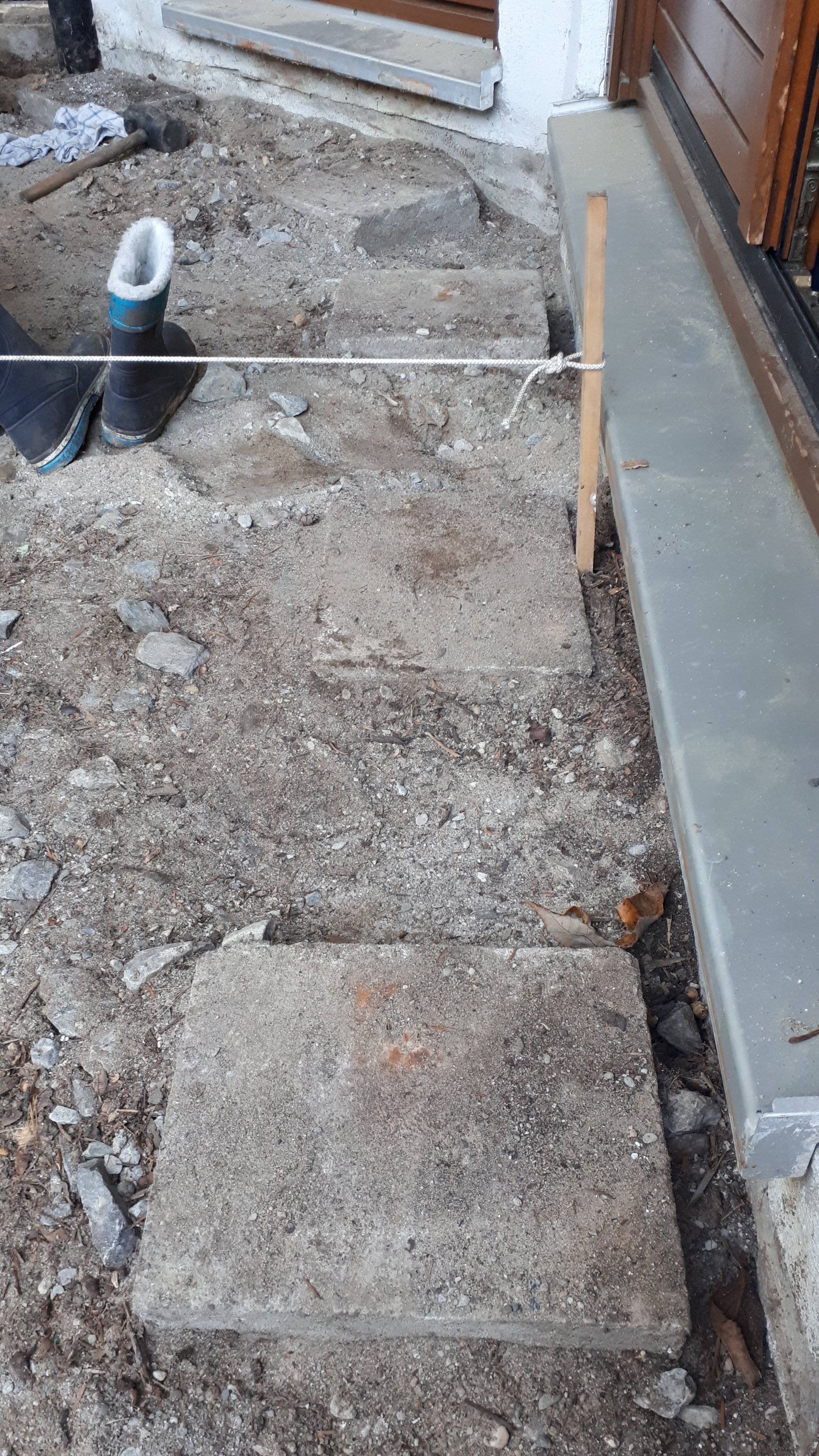

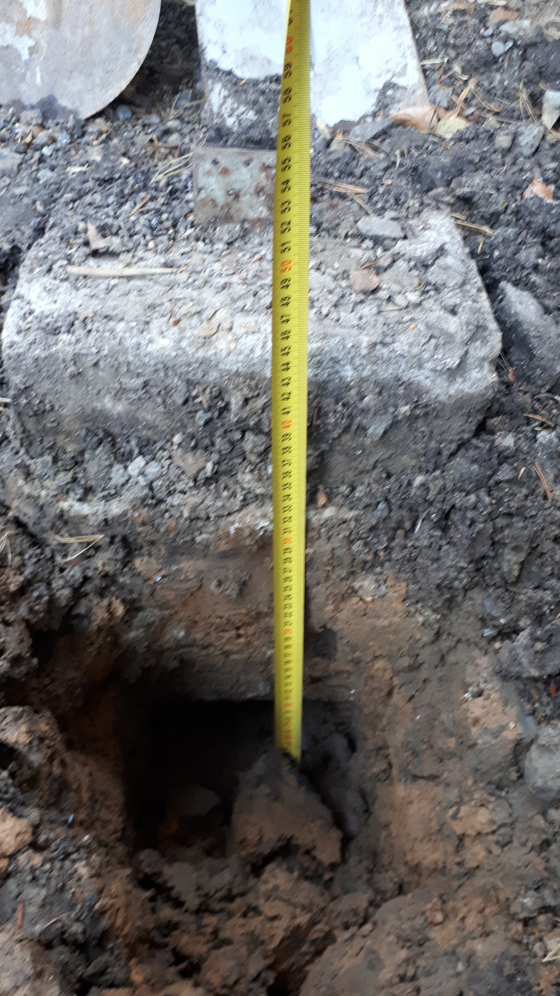

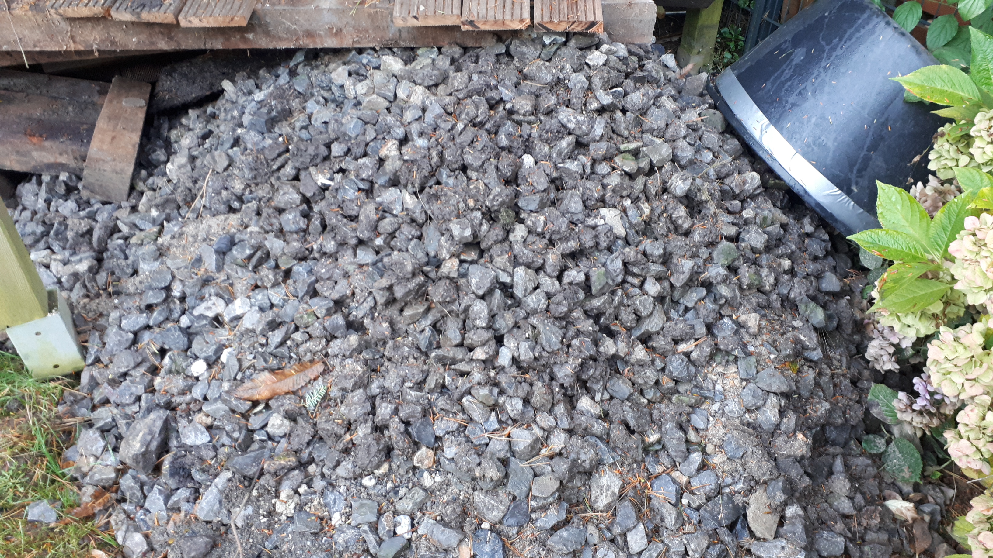

Attached are pictures from the construction site. 163225: I have no idea why a pipe was embedded in the foundation. Does anyone know what it could be for? Definitely not as an umbrella holder below the wood, unless there was a different terrace there before. 163216: foundation blocks, about 20 available. 163157: overall view. 163134: the gravel that I can at best still use. 163111: measured depth of the foundation. On top of that will be about 10-15cm of drainage concrete (or better frost protection gravel?) and then the slabs. The foundations don’t really have to bear weight.

  • #5
What does not disturb the usable level will be built over. I cannot understand your concerns that point foundations - which are also supposed to be pushed up by frost action. In my eyes, the whole project, as I see it, needs to be reconsidered! And that fundamentally. You certainly know that drain screeds and drain concrete, due to their material properties (here the grading curve for smaller aggregates is missing), do not have the compressive and flexural strength of a standard construction? Surely you know that. And also that the mechanical material properties of drain concrete as well as drain screed have to be compensated by partially significant additional thickness? Surely you know that. And also the difficulty that fine stoneware tiles are normally glued in a thin-bed method, but for single-grade screeds (or - concrete) a medium-bed mortar must be used, is known to you. But are they also fine stoneware tiles, as stated in the second sentence of your initial post? Because below in the list you speak of a 2cm plate thickness. And at that thickness, they are certainly not fine stoneware tiles. Therefore, I am surprised that here (excuse me) it is tried and assumed with a "botched job" that the whole thing will ultimately still be successful. Leave all the nonsense with drain concrete or drain screed! Save about 2cm on your frost protection layer so that you can use this "on top" elsewhere. Build the frost protection layer out of coarse gravel, compact it as well as possible (e.g. with a lawn roller) and level it almost flat, then place a thicker PE foil about 0.15mm as a separation layer, which is covered with a drainage mat. On this drainage mat, first have a cement screed applied so that in the second run you can have another (composite) screed laid on top with a 2% slope. And on this you can build tiles to your heart's content, whereby I would recommend tiles >12mm thick. The whole thing then mineral jointed and "job done"! With the circus around drain screed or drain concrete you will not be happy. Good luck with the planning and execution: KlaRa
